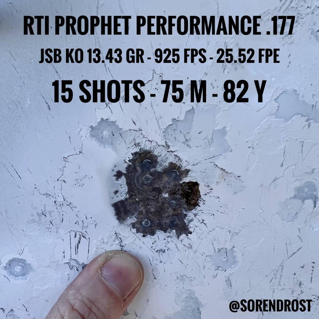

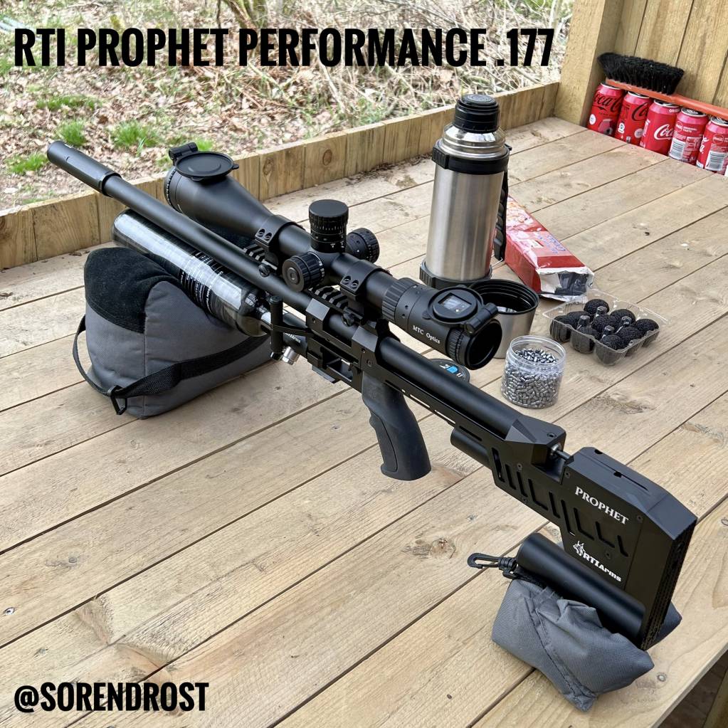

Just got the RTI Prophet Performance .177 and it is very accurate with slugs 👍🙂
Planning on adding a 600 mm LW polygon barrel 👍

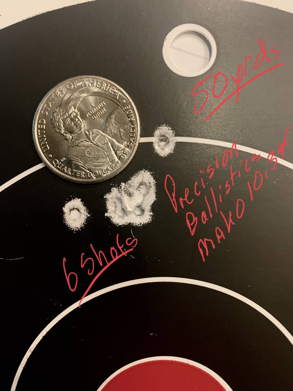

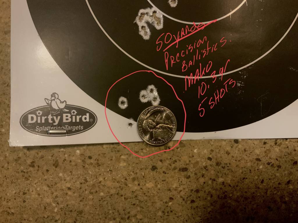

Well, I have my “little” Uragan Compact coming. I thought it would be worth the time to try some slugs in it. Here is the following which will be tested.
  1. Precision Ballistics 10.4 gr. Makos - 2 types (1 is prototype)
  2. NSA 12.5 gr.
  3. JSB 13.4 gr. Knockouts
  4. JSB 10.05 gr. Knockouts
    [/LIST=1]
    It will be a bit before I get into messing with the slugs at an in-depth levels. Need to know the gun and go from there, I have faith in the CZ barrel.
