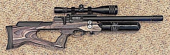

PCP Rifle  SOLD Kalibrgun tactical 45
I have a like new kaliburgun cricket tac 45 blue laminate stock for sale, very accurate shooting jsb 10.34 will ship with fill probe and 2 mags, moderator not included, no issues with the gun selling to fund another project, will ship double boxed. PayPal ff or ad 3% asking 900.00 shipped.

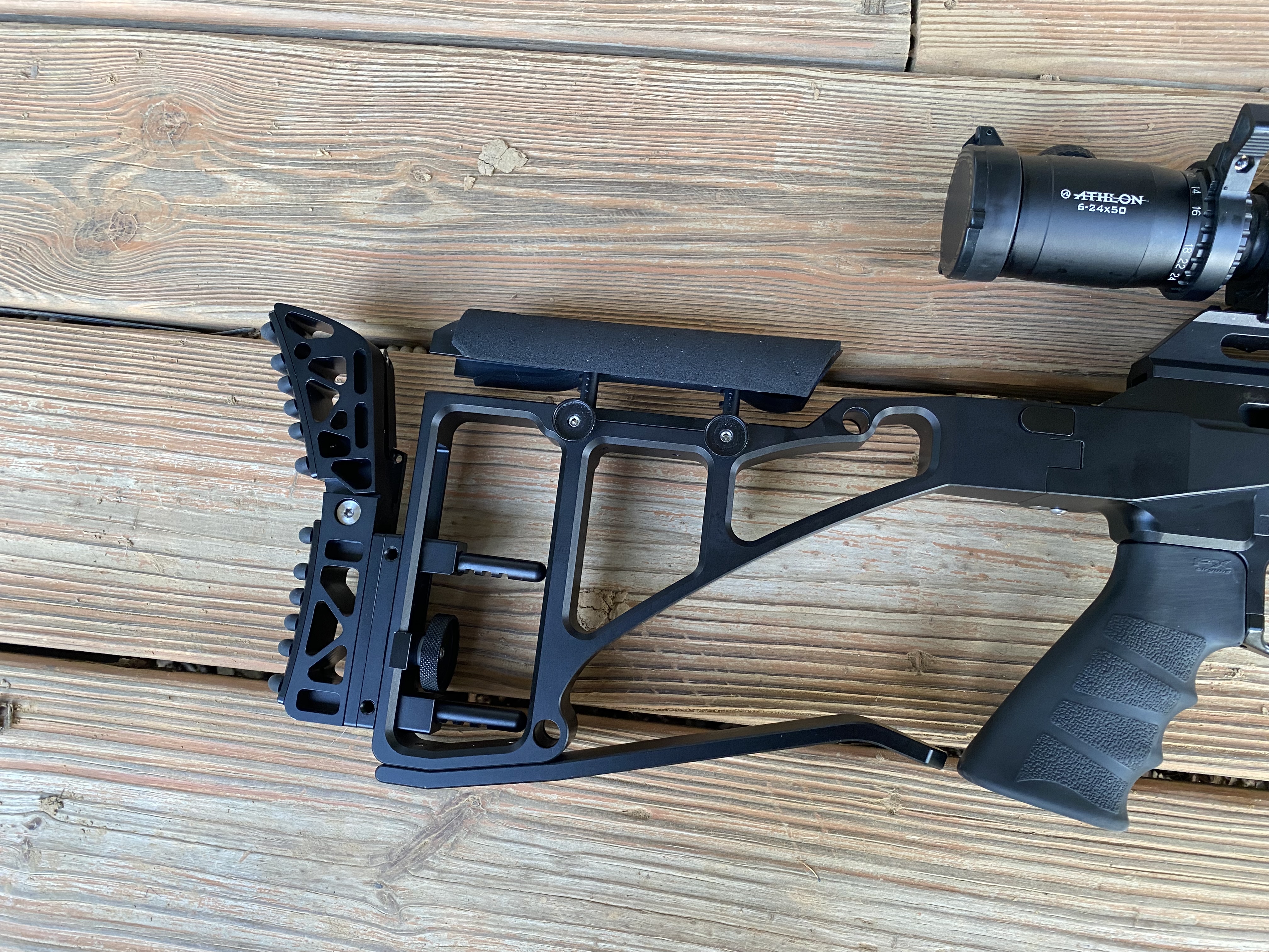

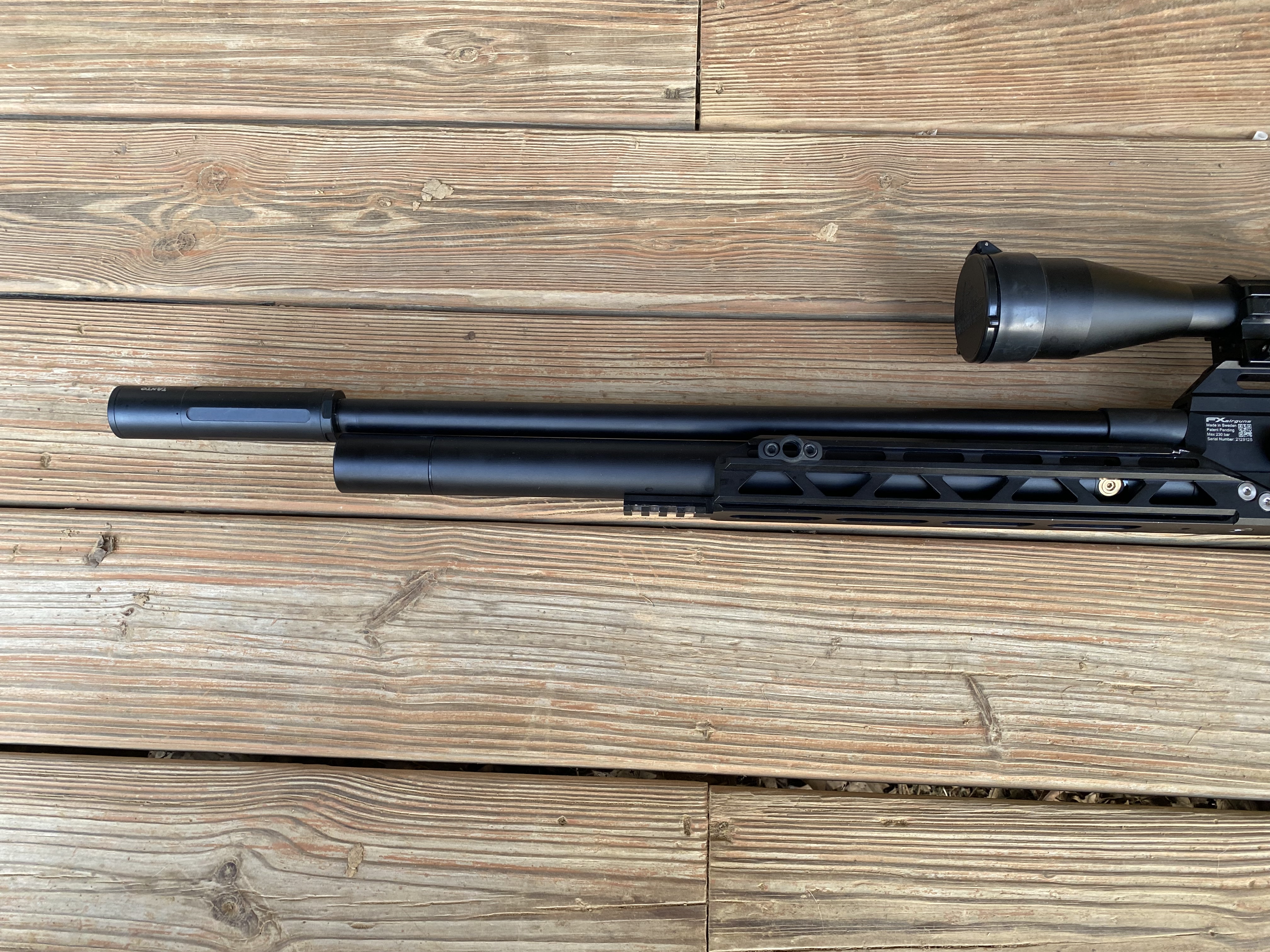

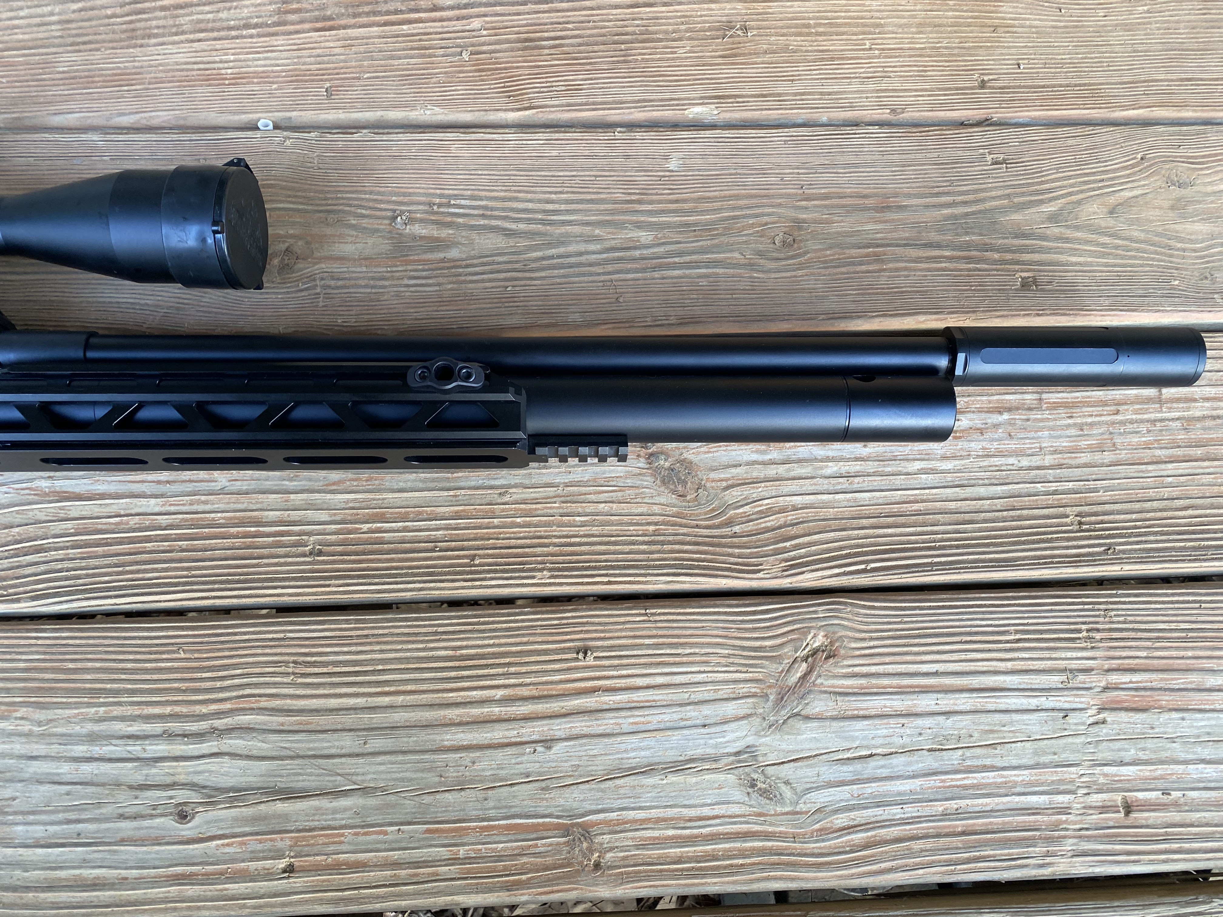

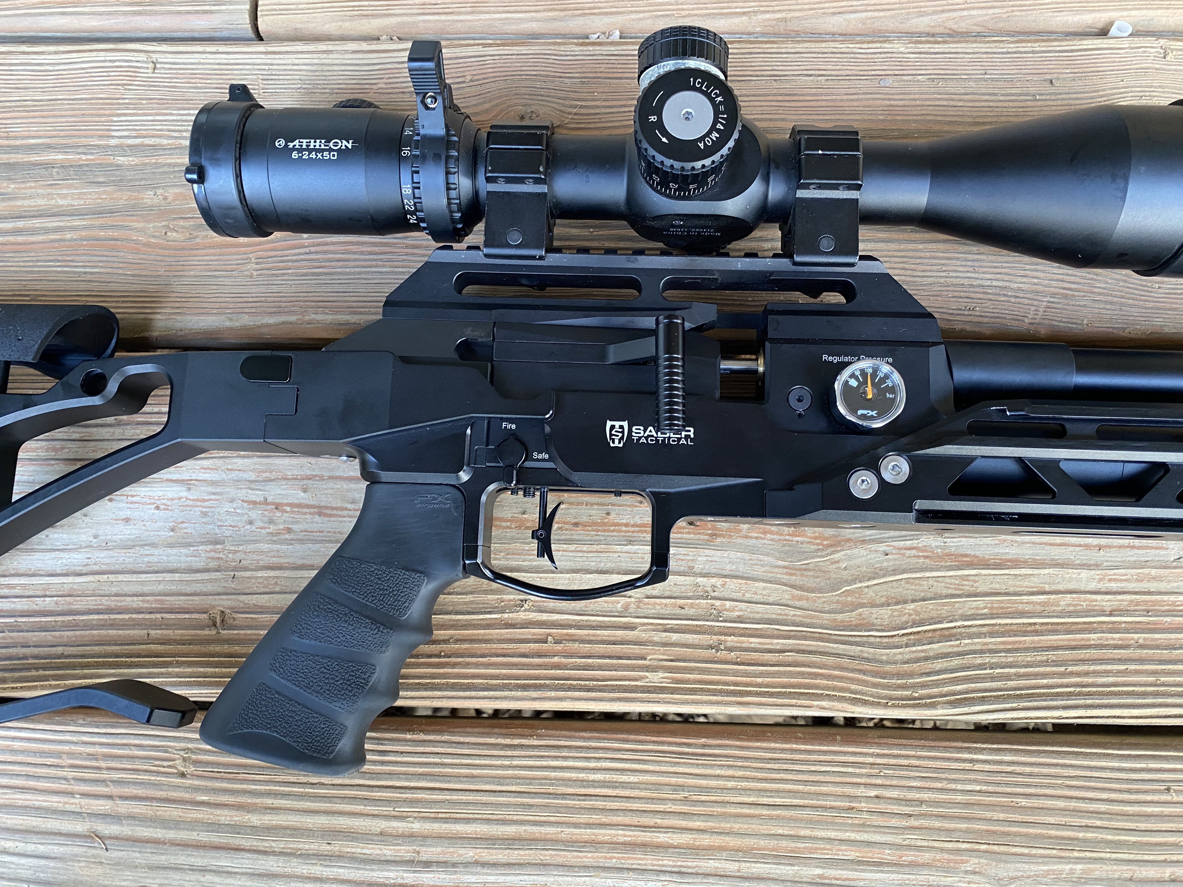

PCP Rifle  NLA Crown MK2 in 25 caliber with GRS stock with a 500 mm barrel
I own 3 crowns love them all.. this rifle has less than 500 pellets shot thru it...Would like a trade for a 30cal ..500 mm barrel Panthera..since my gun cost more ..I still consider it a even trade..would like a fair trade..no money involved except we each pay for shipping.
picture are no problem.View attachment 407824
