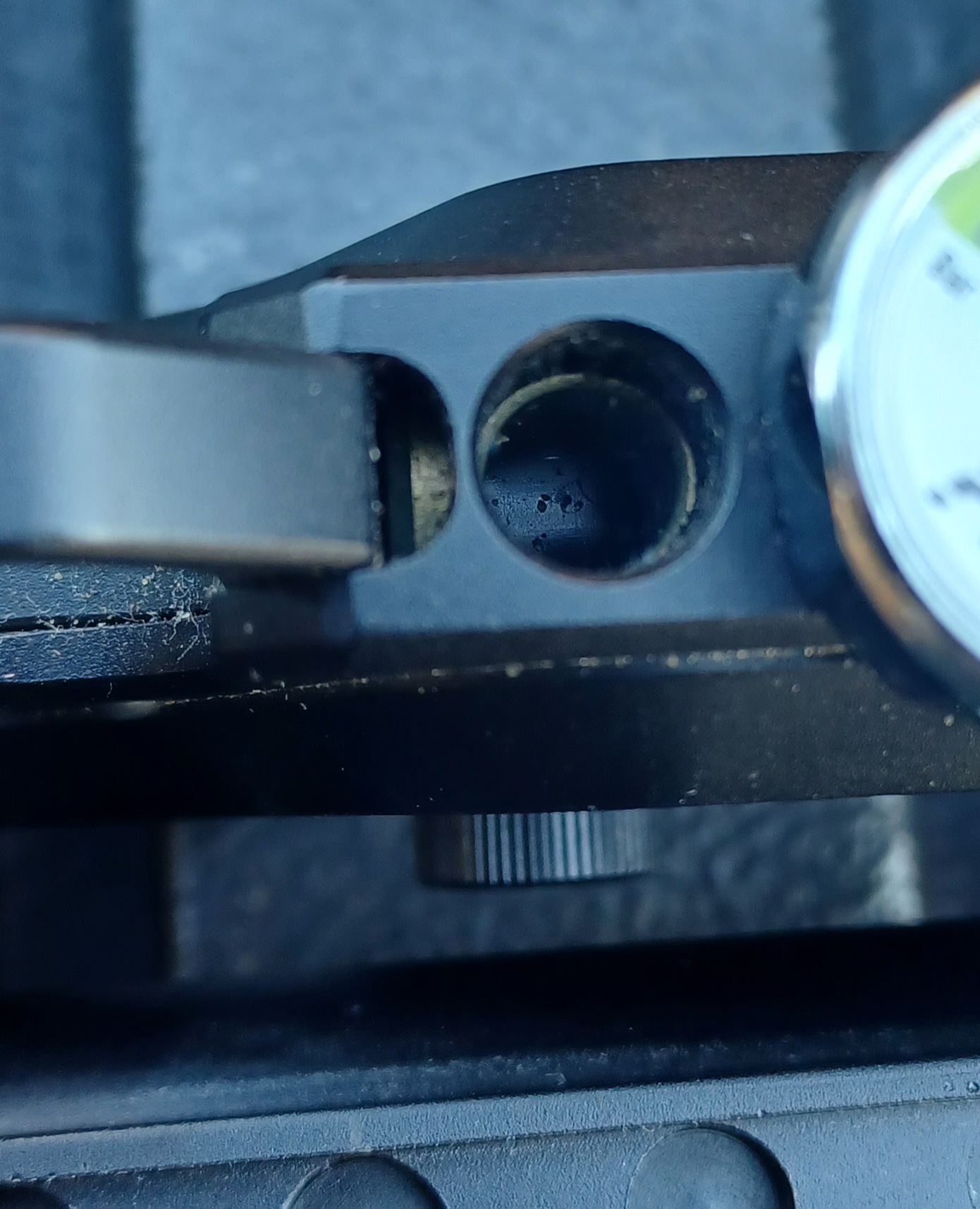

Pcp compressor exploded
Not assuming anything, did you over fill your crankcase oil?
I ask because of the amount of burned oil I see. To much oil could be getting past your 1st stage rings. Your getting detonation, much like a diesel engine or a springer with to much lube ahead of the piston seal.
This is exactly what I assume after seeing the photos. It's less critical to slightly underfill rather than slightly overfill. In these small compressors it doesn't matter what brand you used if you overfill the crankcase. Just an ounce or two too much and it will and it will get fried in the compression area under high heat then diesel. Excess oil is the reason your compressor failed spectacularly. The brand was immaterial to the outcome.
