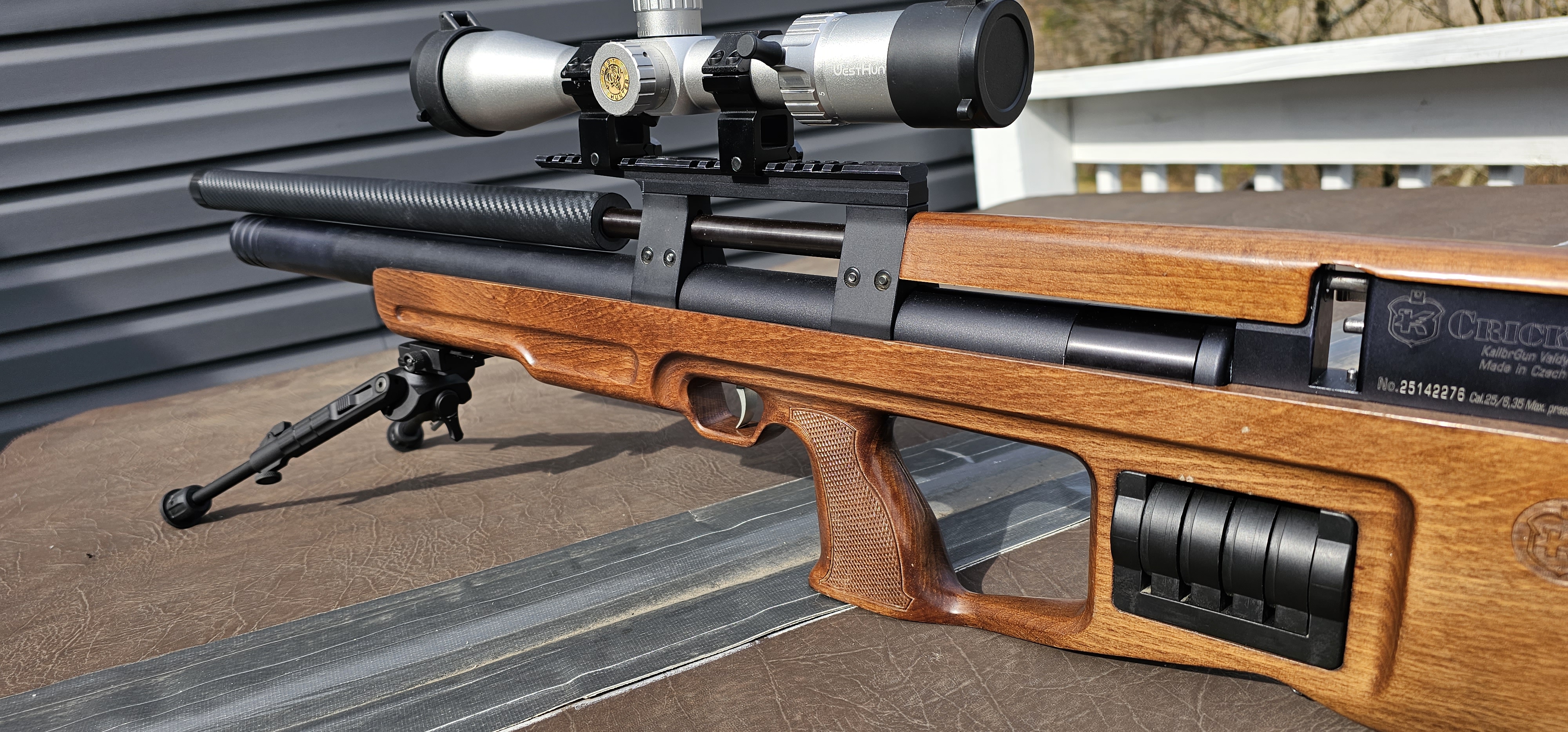

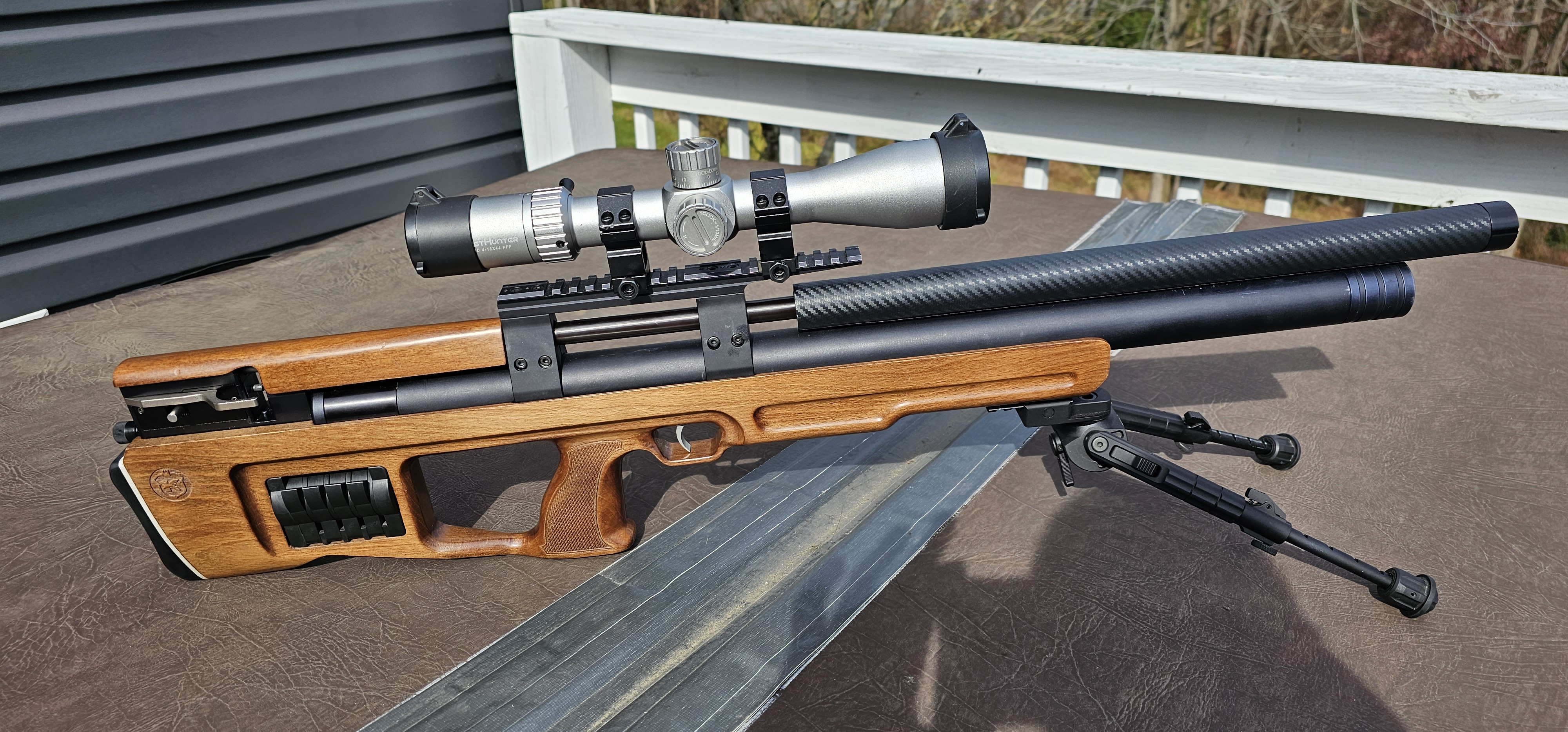

Crosman  A most satisfying shoot
Those are a couple of my favorite PCPs,simple to shoot one holers at 25 yards with the Challenger,the prod is great too.Nice shooters you got.
This HFT Challenger will give my BSA Goldstars, Air Arms S510, Daystate Revere and Wolverine and my Brocock Ghost or any of my other FT rigs a serious run for the money ! This is especially true when I throw my Sightron S-Tac 4-20X50 with the MF4 reticle on it!
