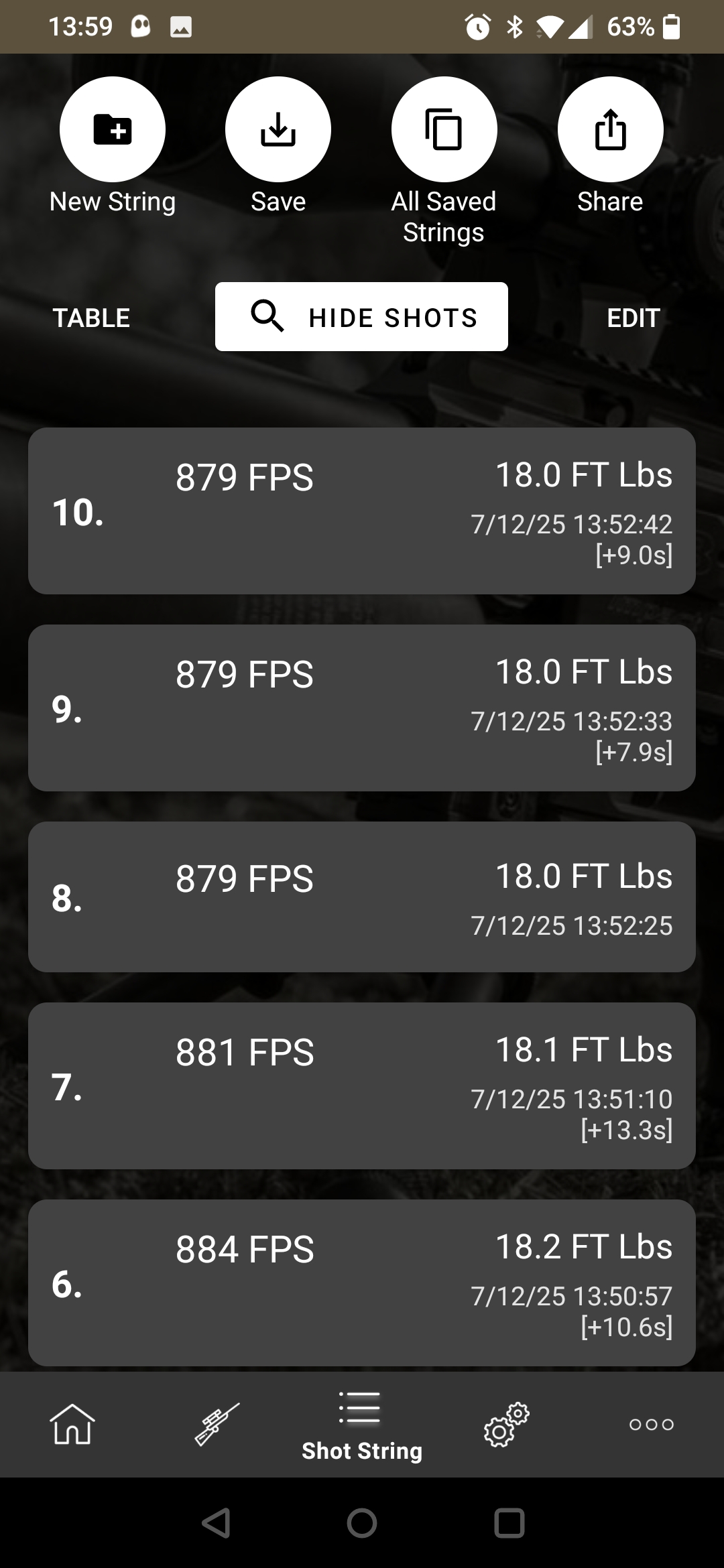

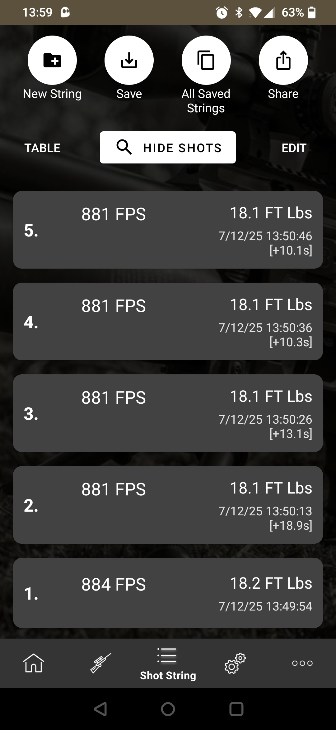

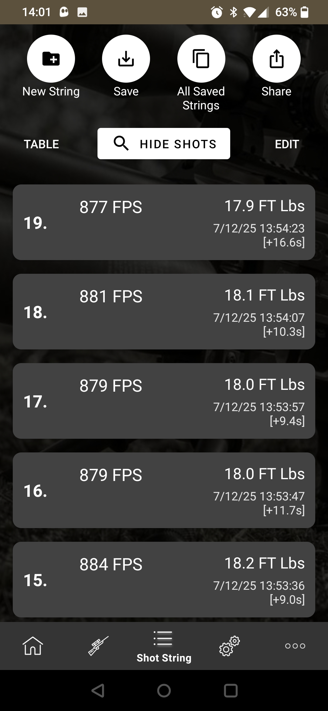

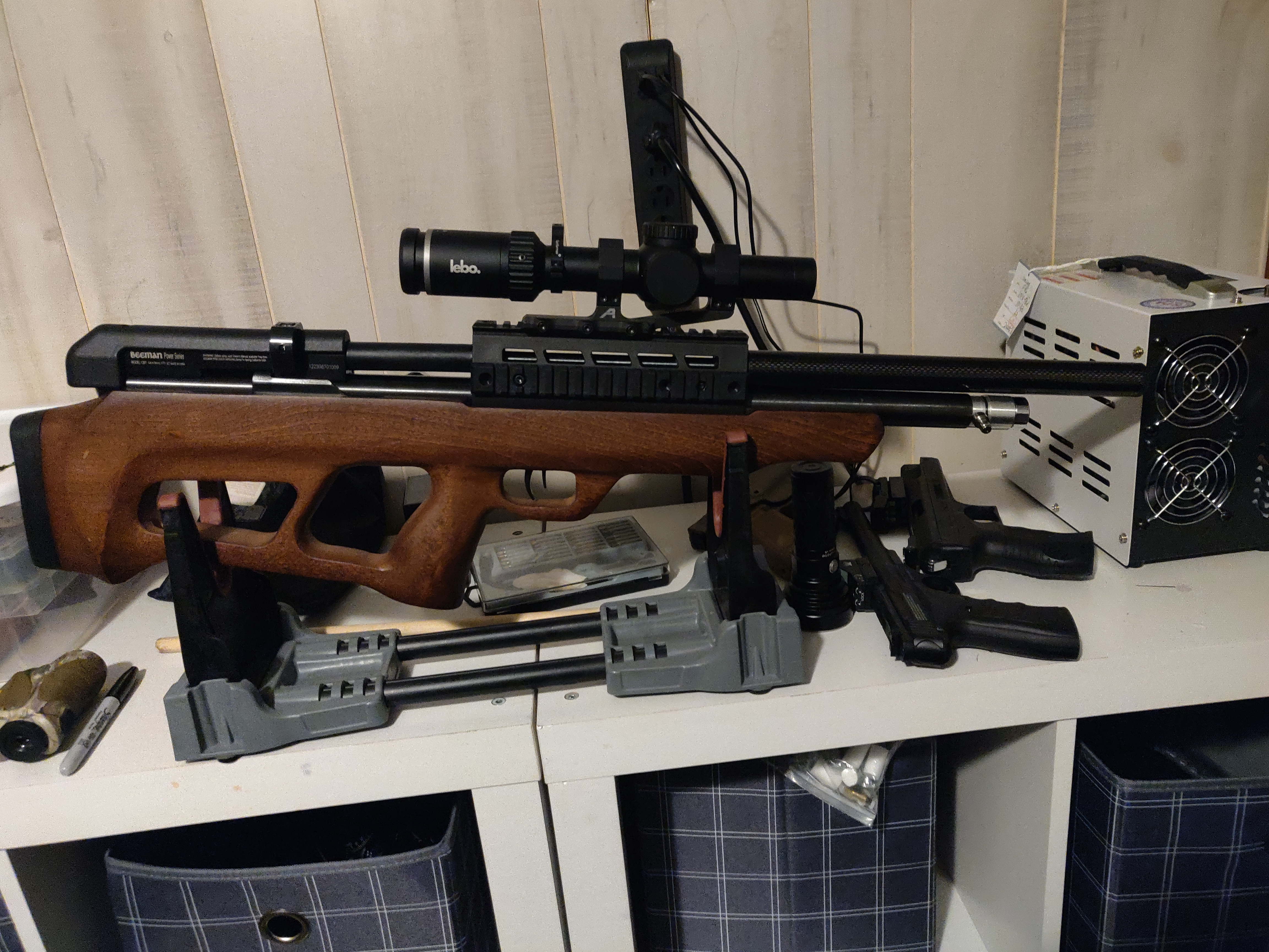

Finally got around to tuning this little guy over the last few days after adding a regulator. Getting a little over 5 mags (65-70 shots) out of it with a ES of 10 SD of around 3. Damn rifle is a tack driver out to 50 yards. Not to bad for under $200 all in with it.
View attachment 577751View attachment 577752
Yes,One of my favorite budget guns.I got three of them
