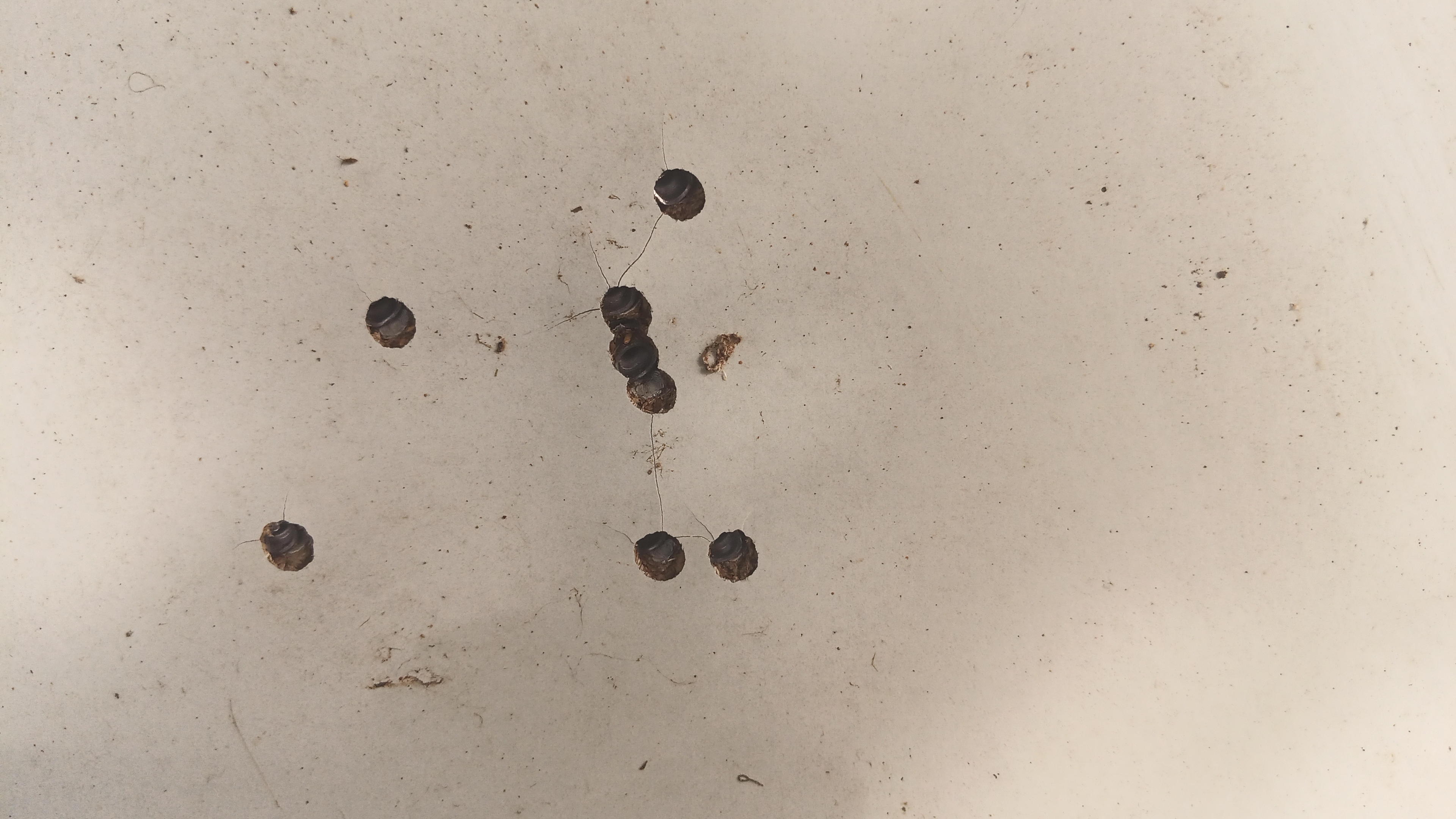

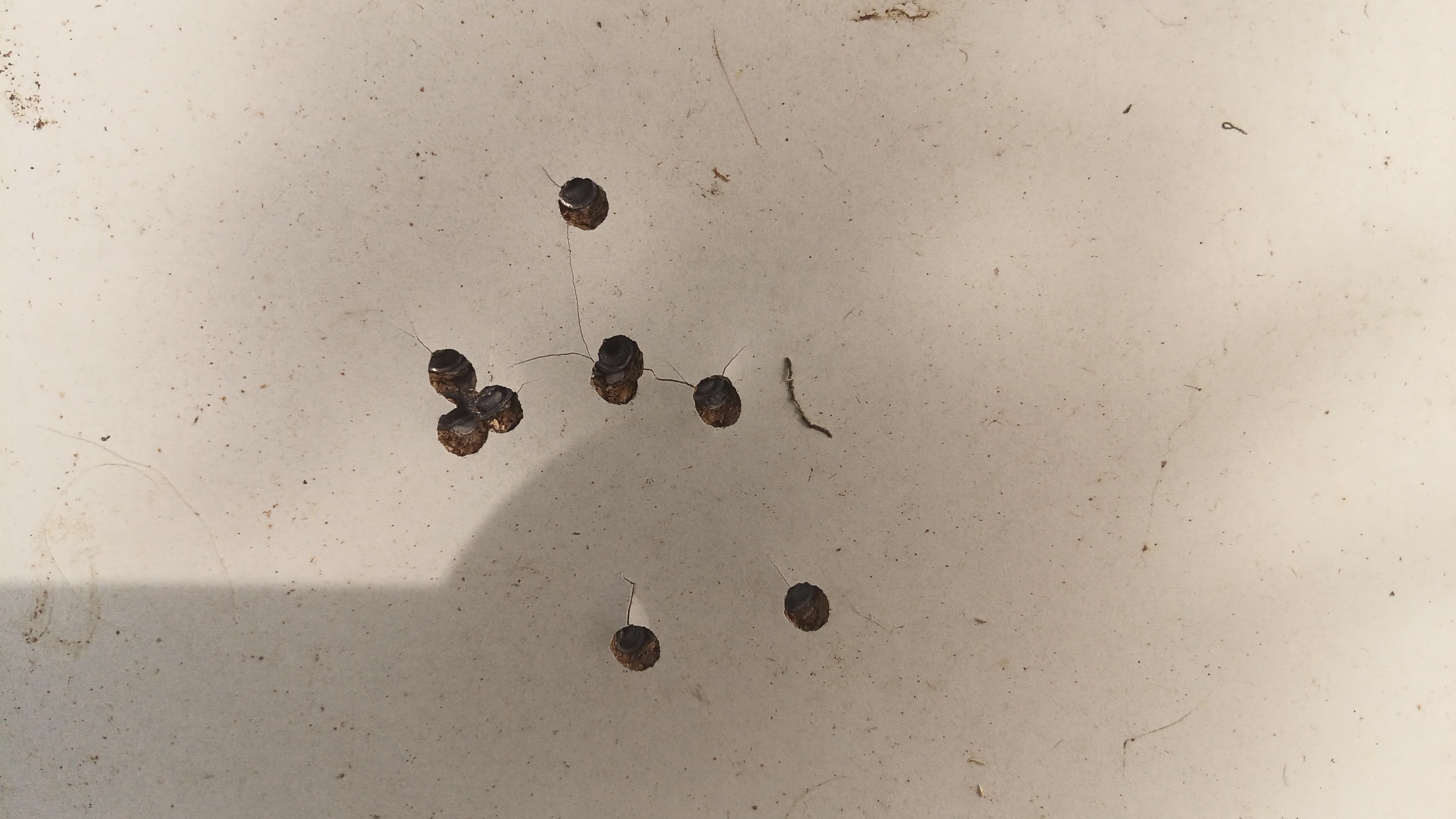

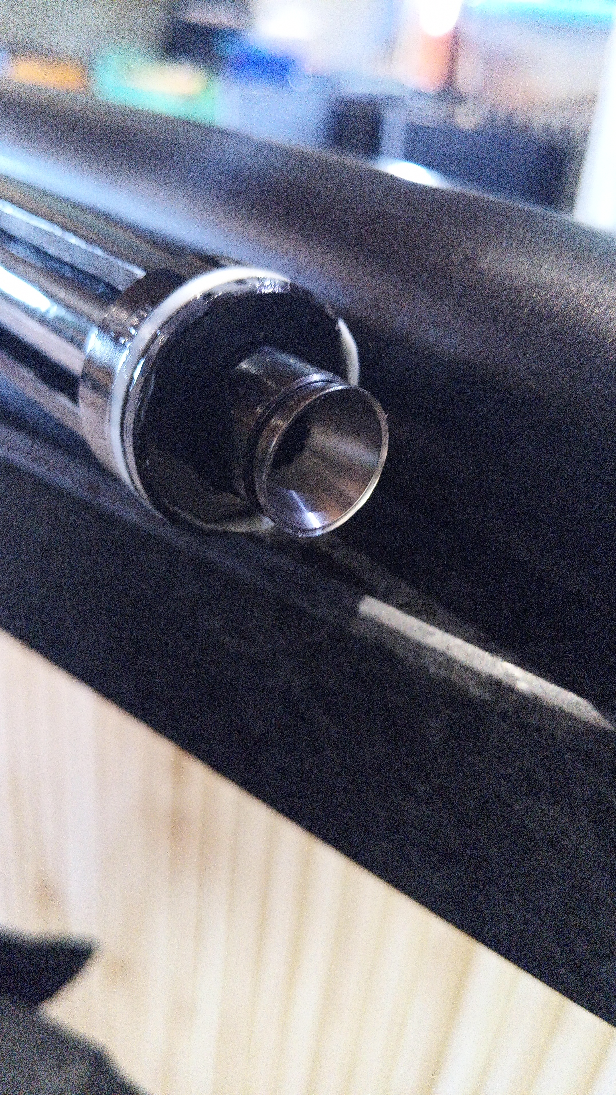

Hi,
Before 2 months i had a problem with my dynamic it was shooting kind a 3 shot group 2-3 MOA group on 100m but some shots was flying to right side by even 70cm. Nothing was loose or something i was not able to find the root of issue (speed consistency was good).
Now i fitted to the rifle a Huma regulator which works perfectly and a Huma heavy hammer weight. The heavier one ... 14.x gram.
Yesterday i assembled it and tried with 41 grain ZAN slugs all settings between 140 and 155 bar and 275 and 310 m/s.
Had a settings where i had 304.6 m/s 6 times in a row so consistency can be considered to good i think.
On 90 meters i was shooting to a wall and always happened that sometimes i had two shots extremly close almost one hole and another shot went totally elsewhere. I dont even consider the overall acuracy to be a "group" but the rifles "group" was around 30-40 cm on 90m. In nutshell terrible.
Do you had someone similar issue? Or maybe some idea what could cause it?
Note: The silencer is absolutly OK no movement inside or close pass to walls.
