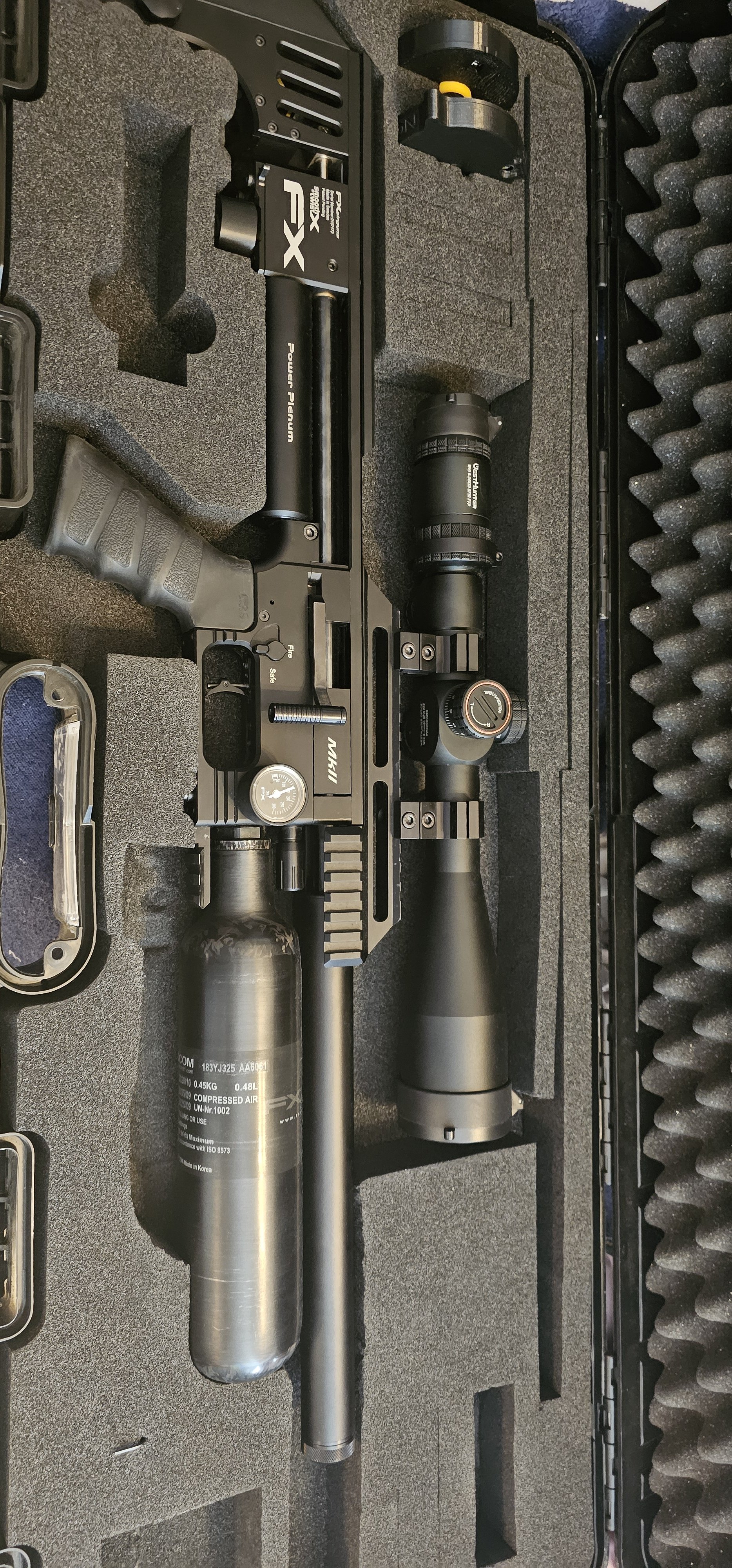

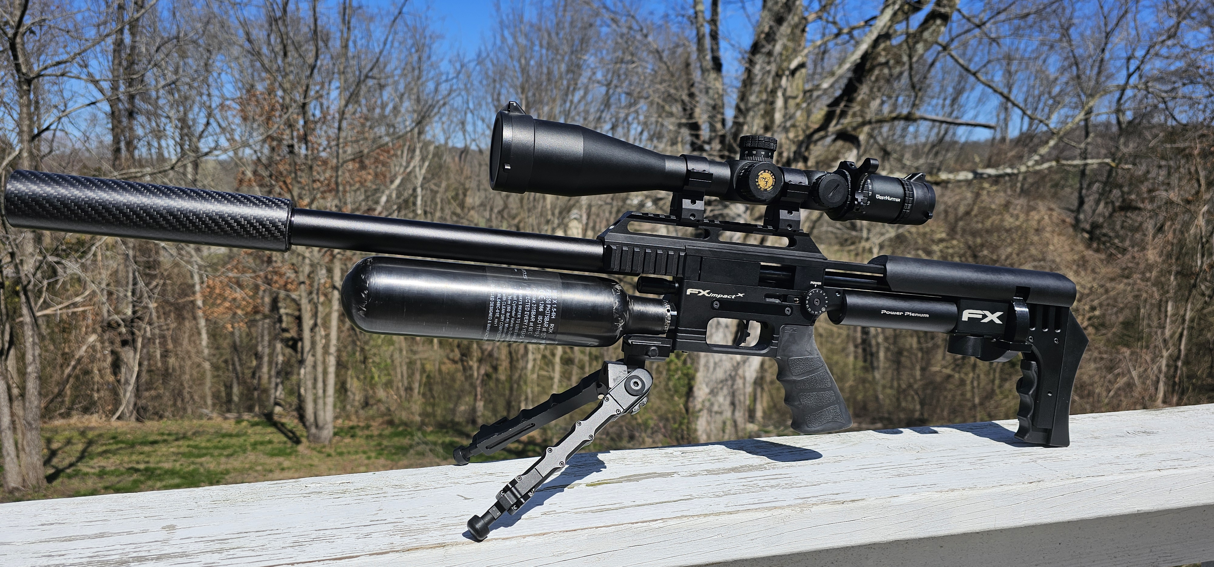

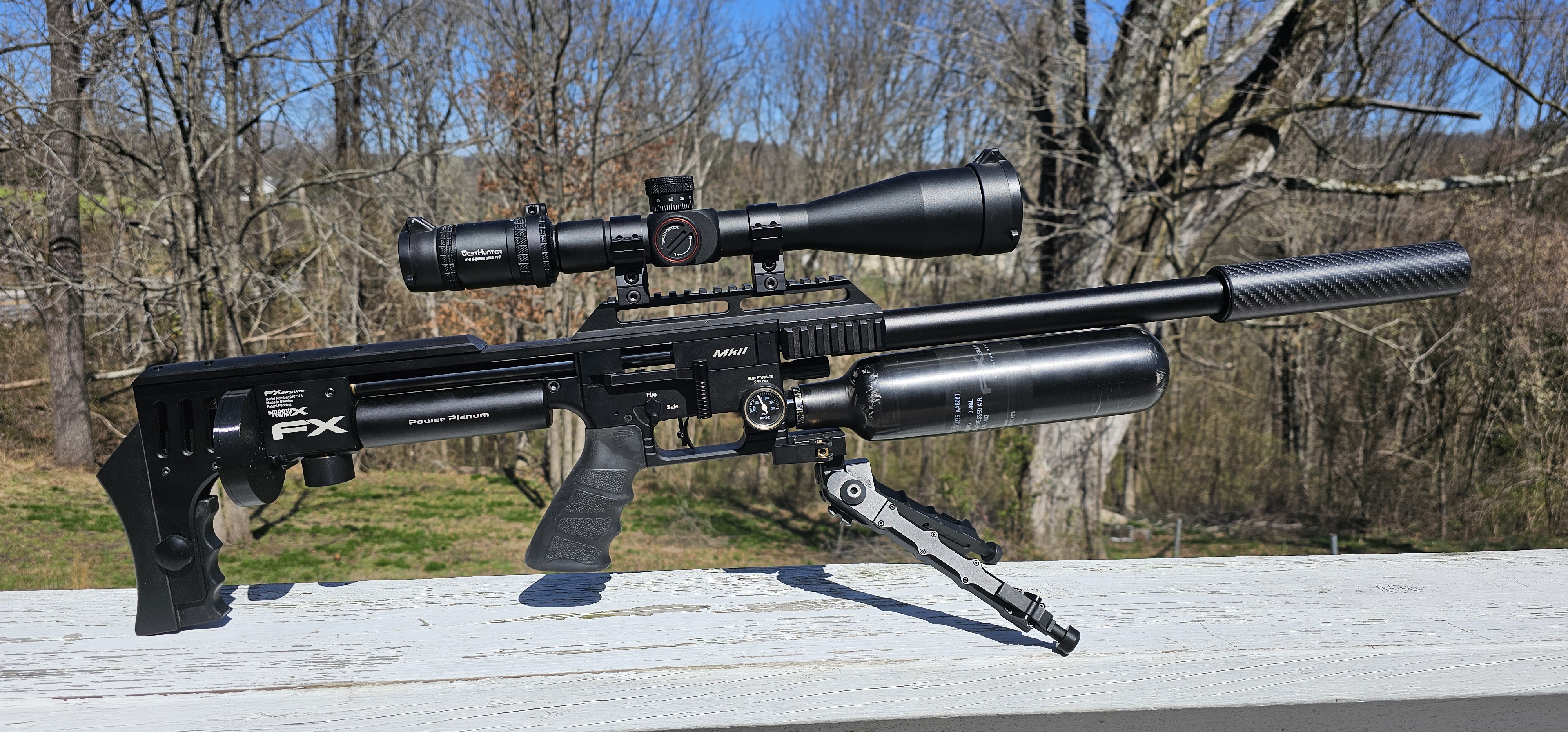

I've tried hard to not respond to this post as I just don't see the Maverick as a good choice for .25.
I'm set up for .30 slugs and she is as perfect as a gun can be. In .25, she was a complete turd,
With pellets, she was a dream but that was not the plan.
I'd get the Dynamic and see if the slug issue has been solved in .25.
