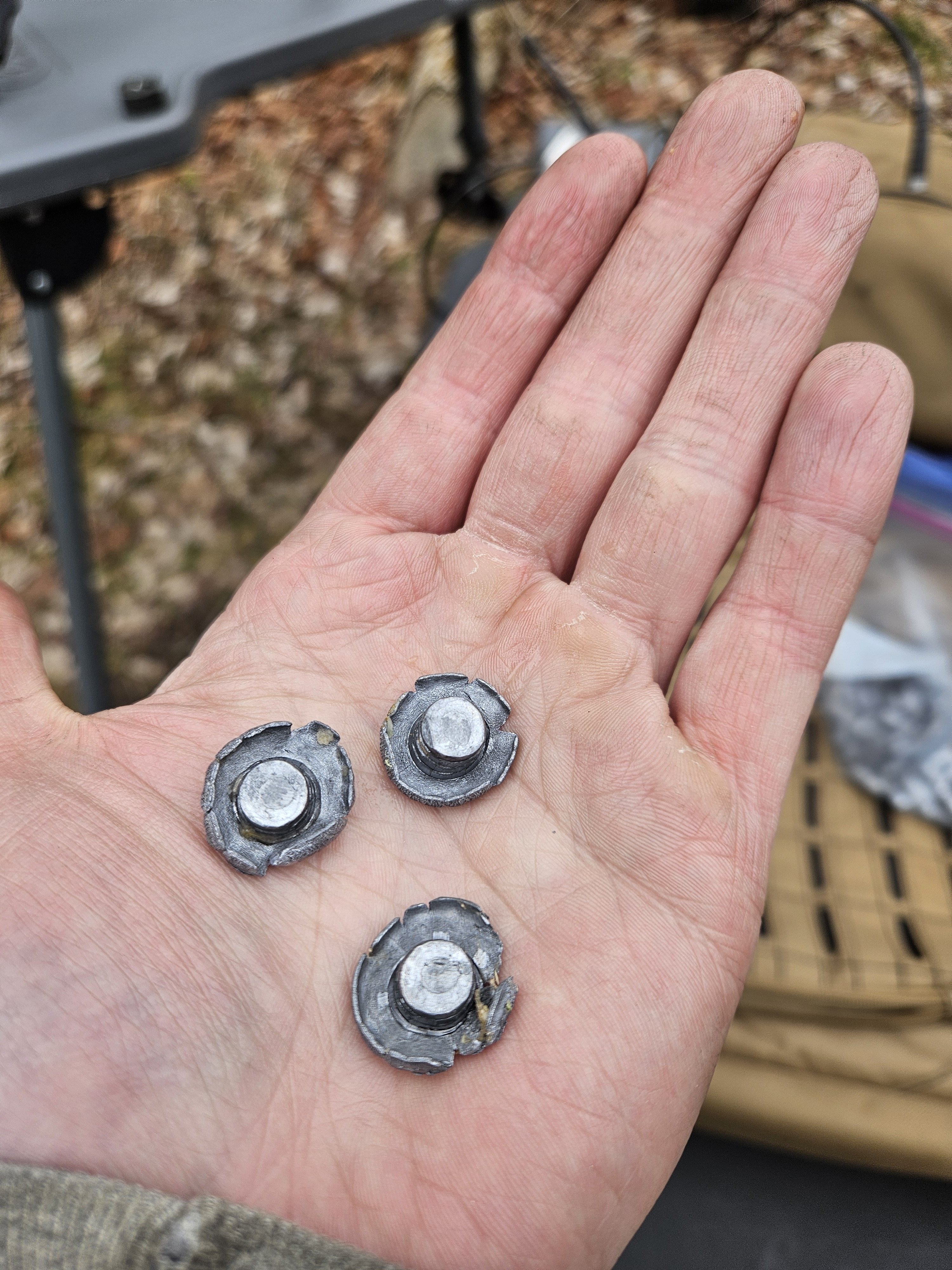

@Firewalker sorry. I made a mistake. I was trying to say that it's waxing of the slugs that I suspect to contribute most to accuracy improvement. Not waxing the barrel. But cleaning the barrel gives me a peace of mind.

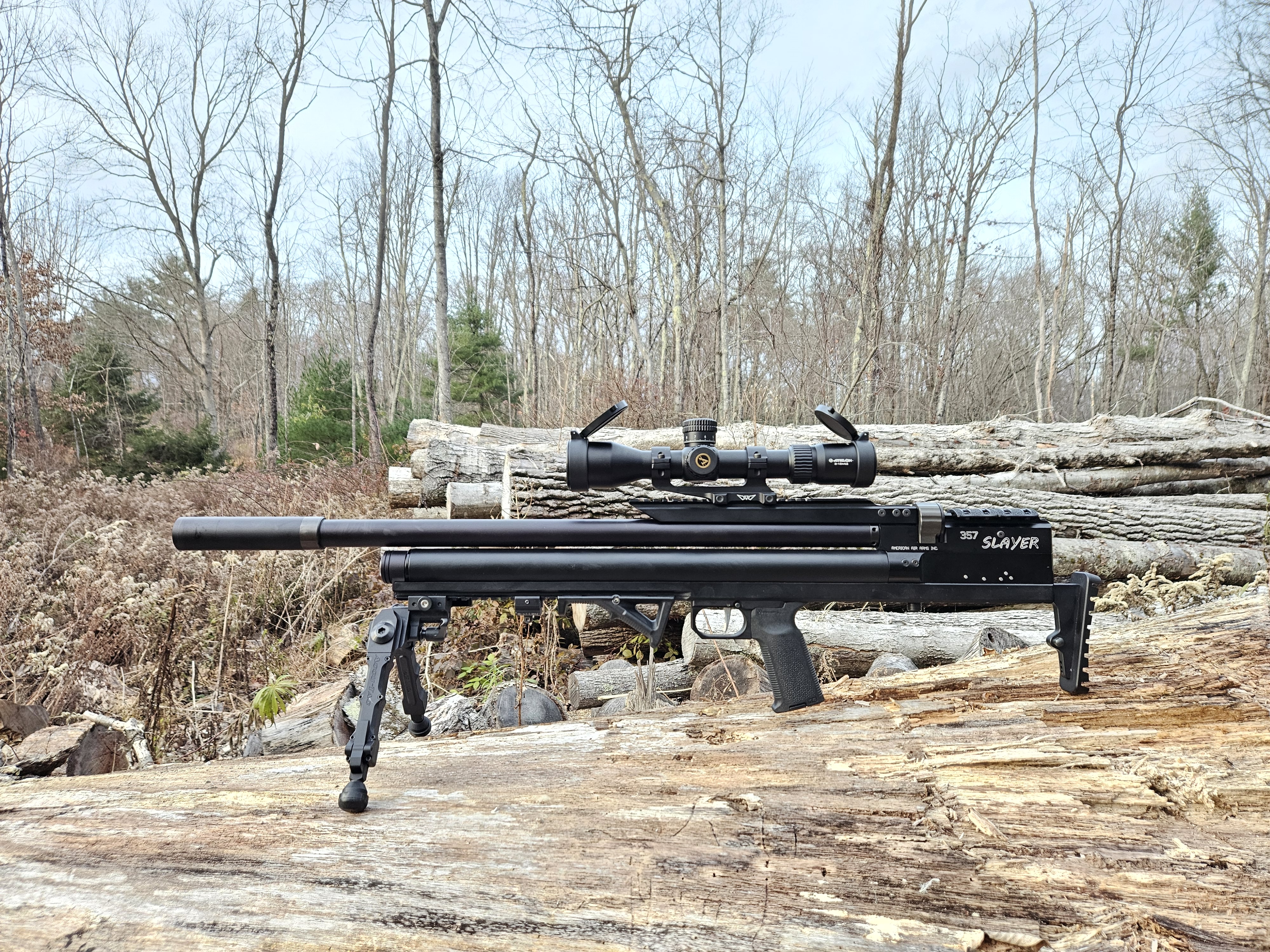

Airgun Technologies  Vulcan 3 700 mm .25 Cal arrived
