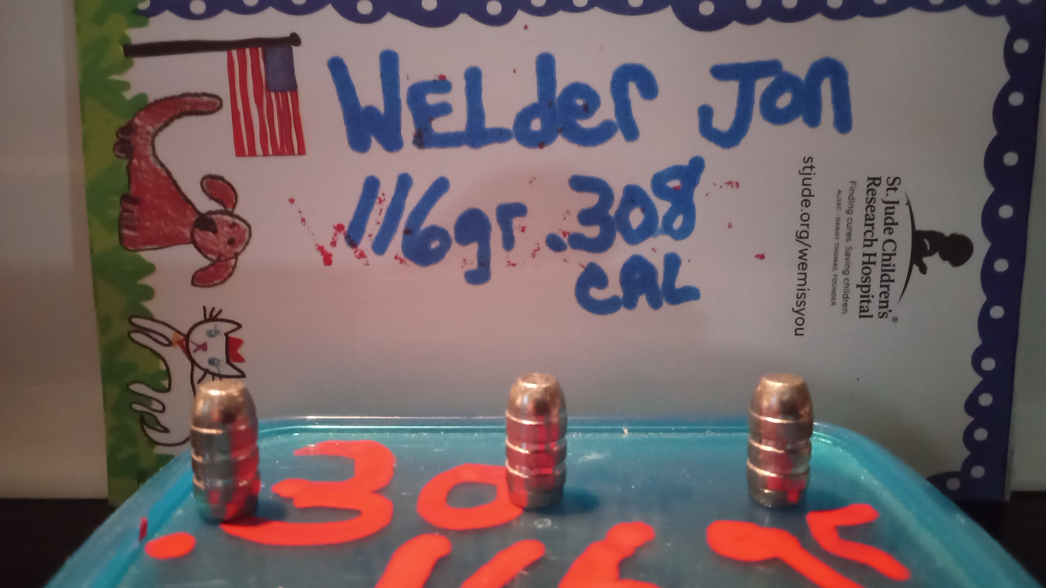

Who comes to mind when looking for quality big bore slugs?
Just wondering who comes to mind when you need that quality made slug? I have 3 that make very high-quality slugs. not in any order. Welder Jon, Kcslugs and now Neal Tressler.
What do you look for to determine a quality slug? I know what I look for when casting my own slugs, just wondering what you consider good.
