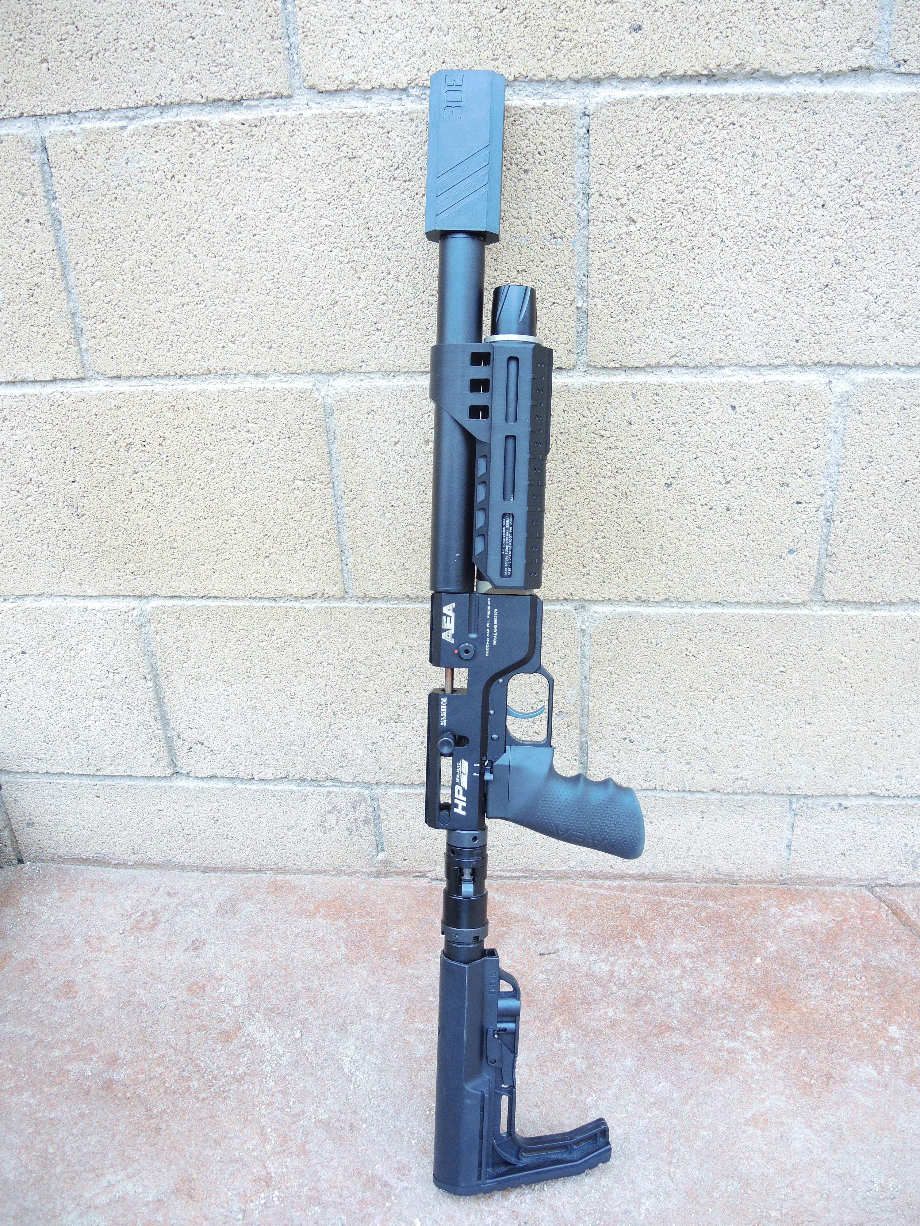

AEA  AEA .45cal Bullpup 100 yard accuracy?
Cheapest .510 slugs are like $.30/ct. Good ones are $.50/ct. .45 are cheaper, but not that much. Refill time after two mags (2x6) is about 20 minutes with portable 12v pump. Shooting groups for leisure is not for big bore guns unless you bring air with you. A lot of air at high PSI.
For deer at 50-100 yards 2x2 groups is fine. 4x4 is fine, too.
When the barrel is bent the worst thing is not the lack of groups consistency. No, it will shoot more or less fine at a fixed distance. But you set the scope at 50 yards, move the target to 100, and can't hit the paper target at all. The slug flies a curve to the side, like there's extra gravity force pulling the projectile in the plane of the crooked barrel. And with pressure and FPS dropping, the curve changes a lot, too. So no real life predictability where this slug may go.
