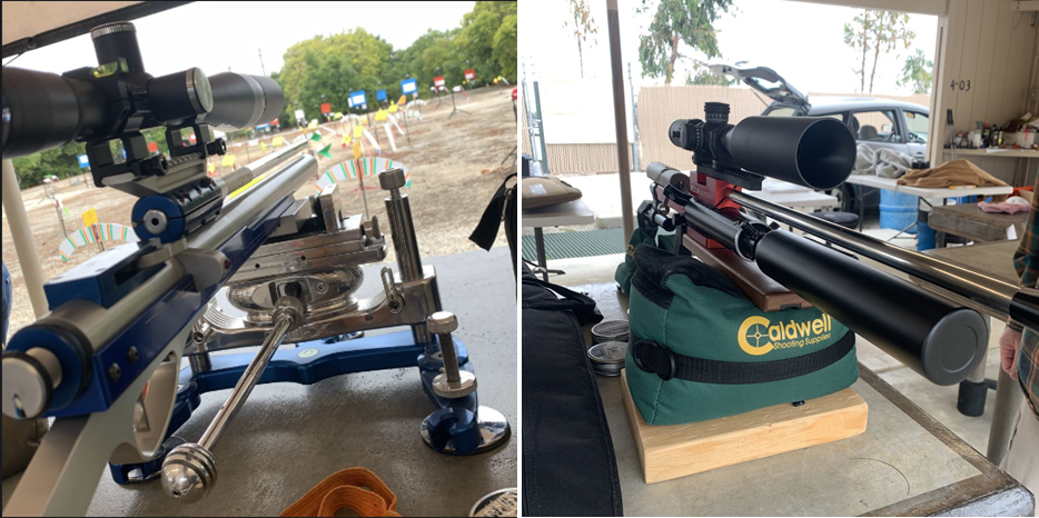

Rests: 8 Randolph rest here today.
But here are the extreme of 2 rests.
And don't forget the flags
Yep...those are 2 extremes for rests :ROFLMAO:
