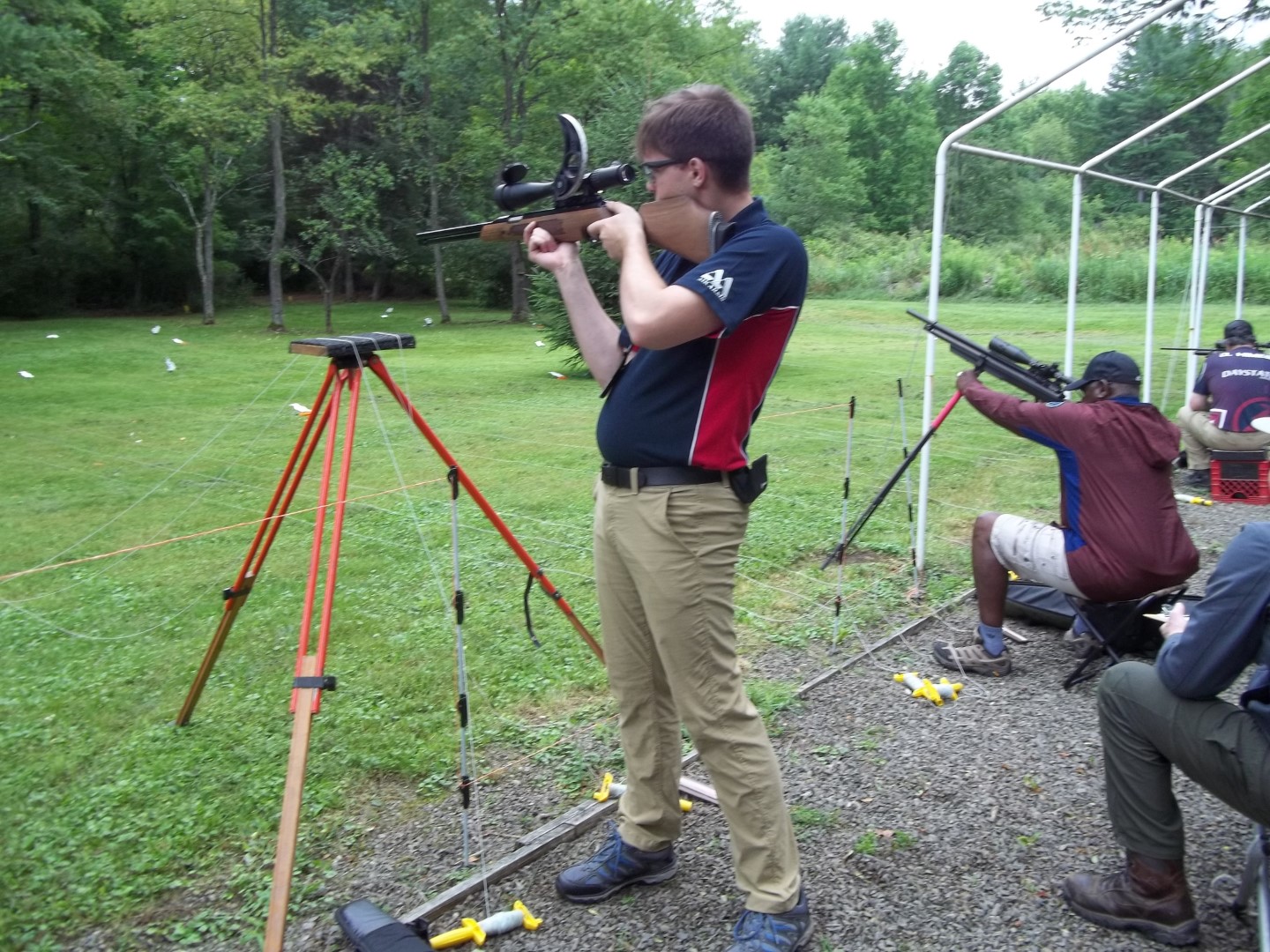

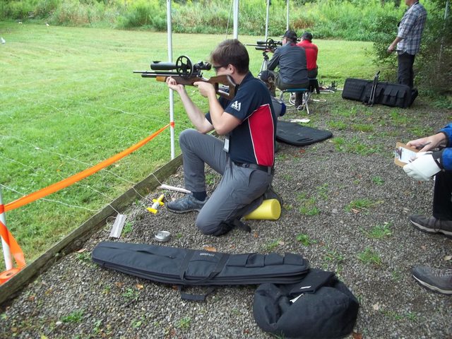

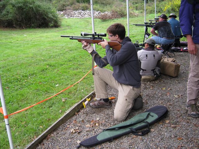

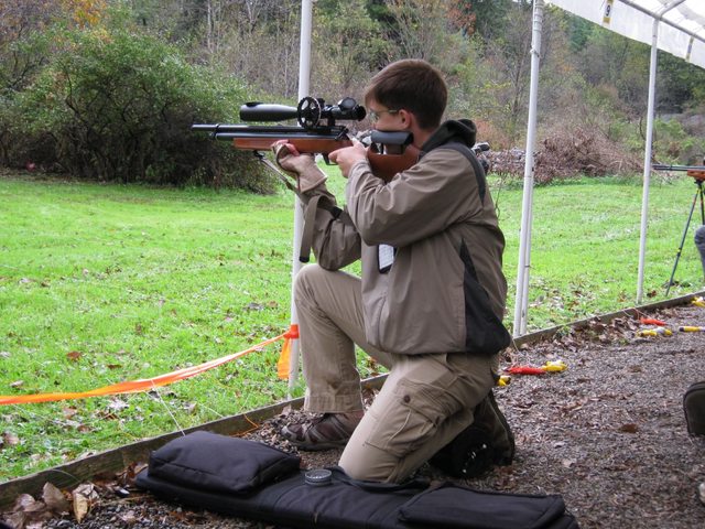

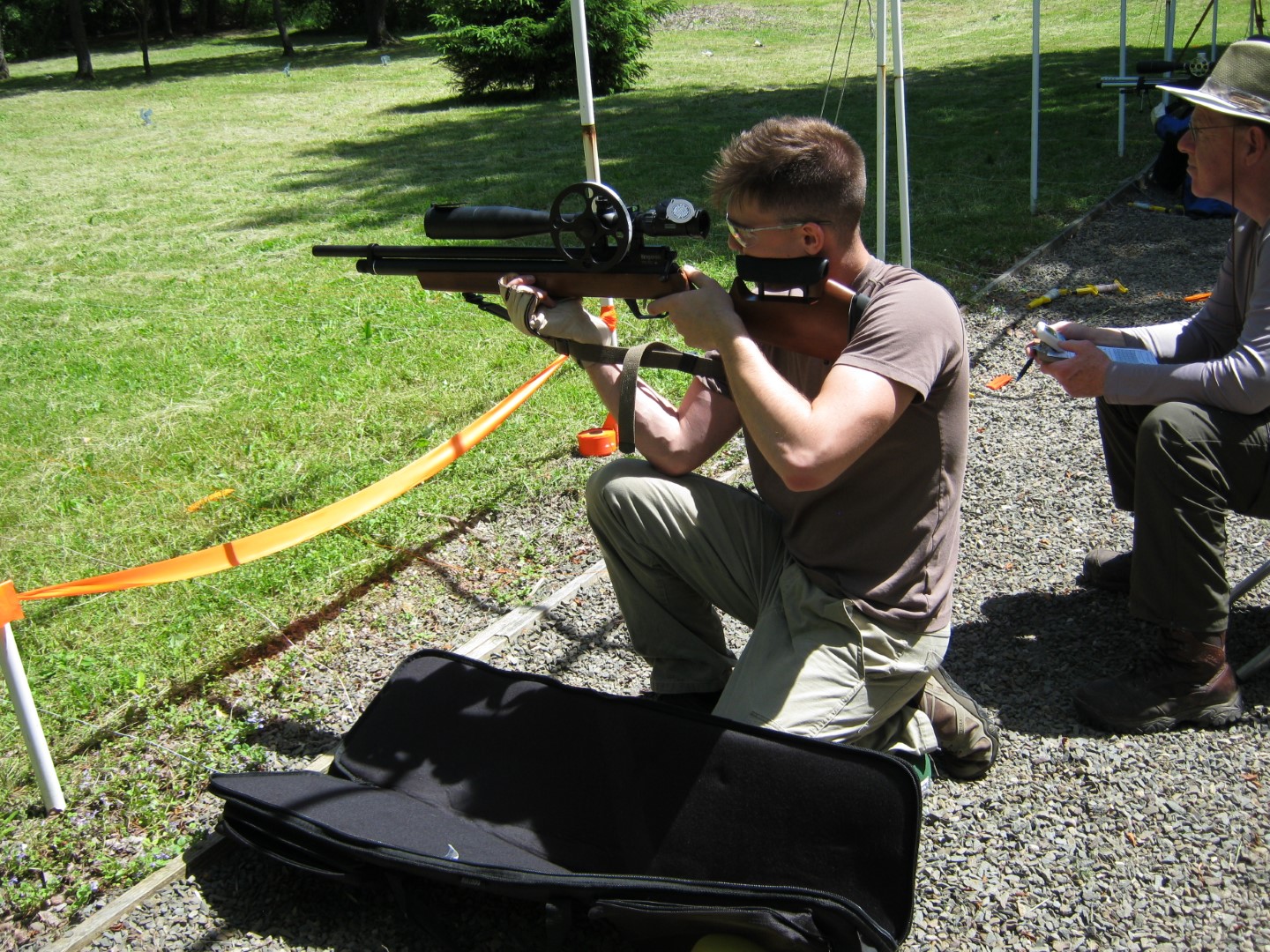

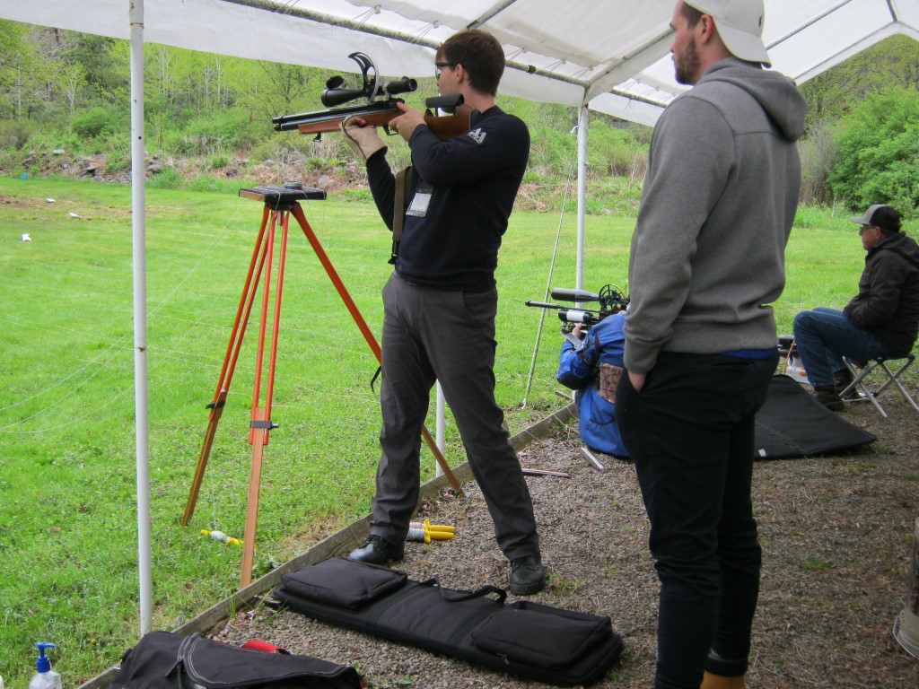

I'll have to dig some more up. Here's what I have. Spanning from 2015 to 2021 shooting a variety of different divisions (mainly Open and Hunter).
I am certainly NOT the most accomplished FT shooter (last PACup I shot 96/120 in Open PCP with my custom MRod), but my background is in 3 position so my position shooting is typically the strongest part of my FT matches...it's the ranging and windage that kills me lol.
I'll try to find more pics of my standing position.
Hope this helps.
