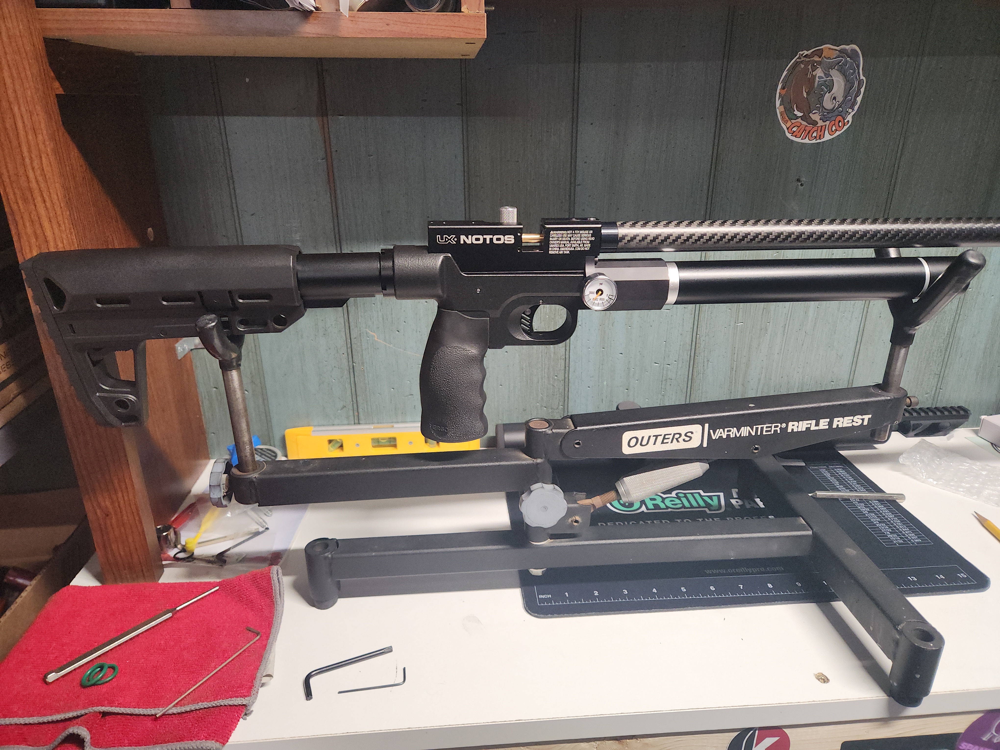

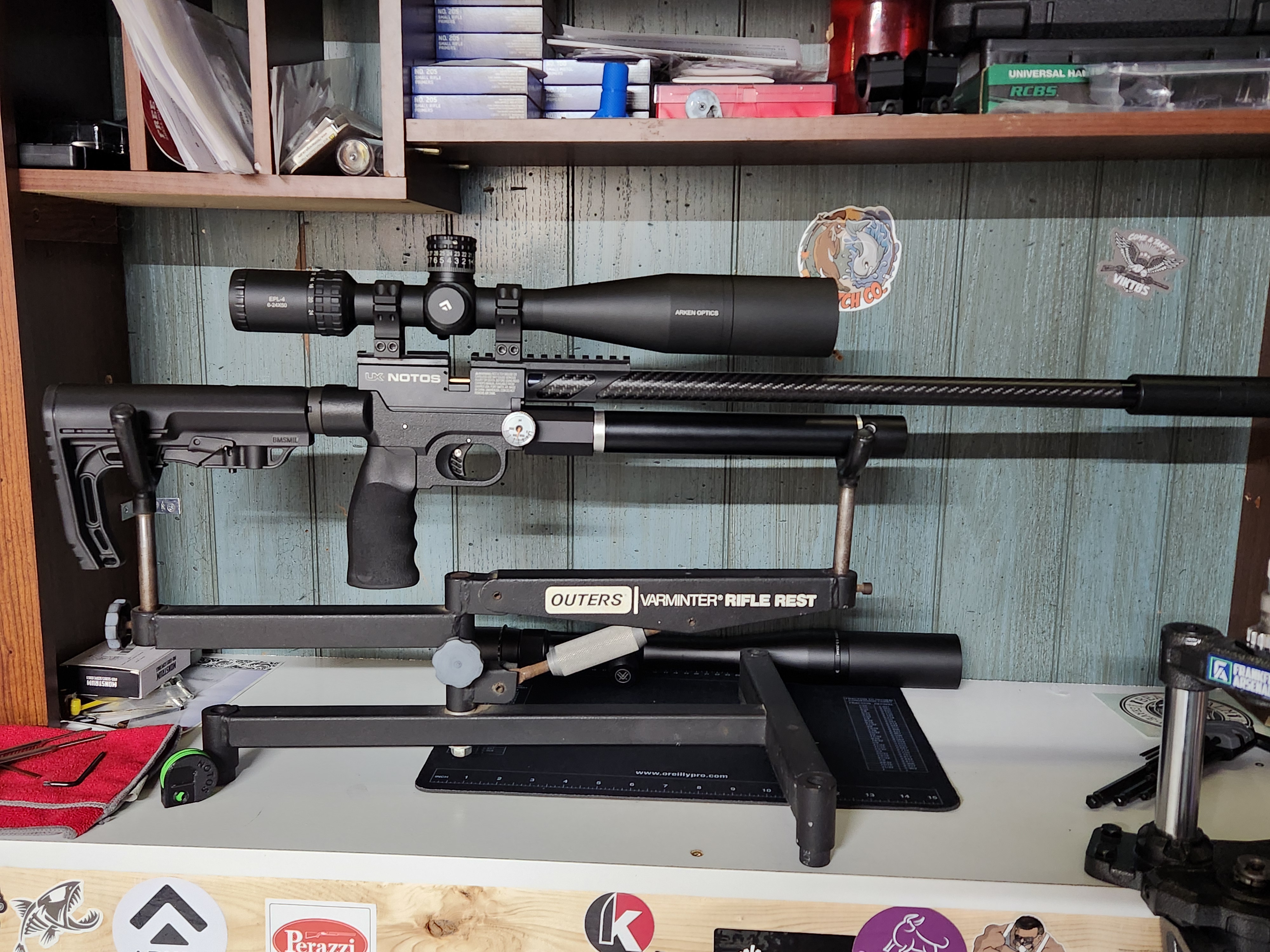

Talk about a series of unfortunate events. Lol I went to start shooting the new 600mm setup and had the scope maxed out and the pellet was still dropping 20mil low even with the moderator removed. I tore the gun apart and put it back together making sure everything was seated right. Shot it and same results. At this point I'm pretty frustrated with it. Since USPS was kind enough to find and get me my .25cal barrel liner I have been waiting a month for I figured Id slap it on and see. Removed my shroud extension along with the 100mm sleeve extension, slapped the 500mm .25 on it and its all squared away and shooting 1 hole in my 15yd basement setup. Shooting 25.39gn JSB Exact Kings at 830fps. A little slower than I was hoping for but we will see how it does at 50 yards. Only gets 15 good shots on the single air tube. Waiting on another adapter to add the 2nd tube I have. I also installed the buck rail grip adapter and I gotta say this little thing looks killer now. Also, trying to find a remote hpa line that doesn't leak has been a treat. I have acquired a 72cu 4500psi bottle I am trying to tether to this rifle to solve the 15 shot per fill issue.
If anyone would be interested in trading a 500mm .22cal liner for my 600mm .22 cal liner, send me a message.
Reactions: ngapls
