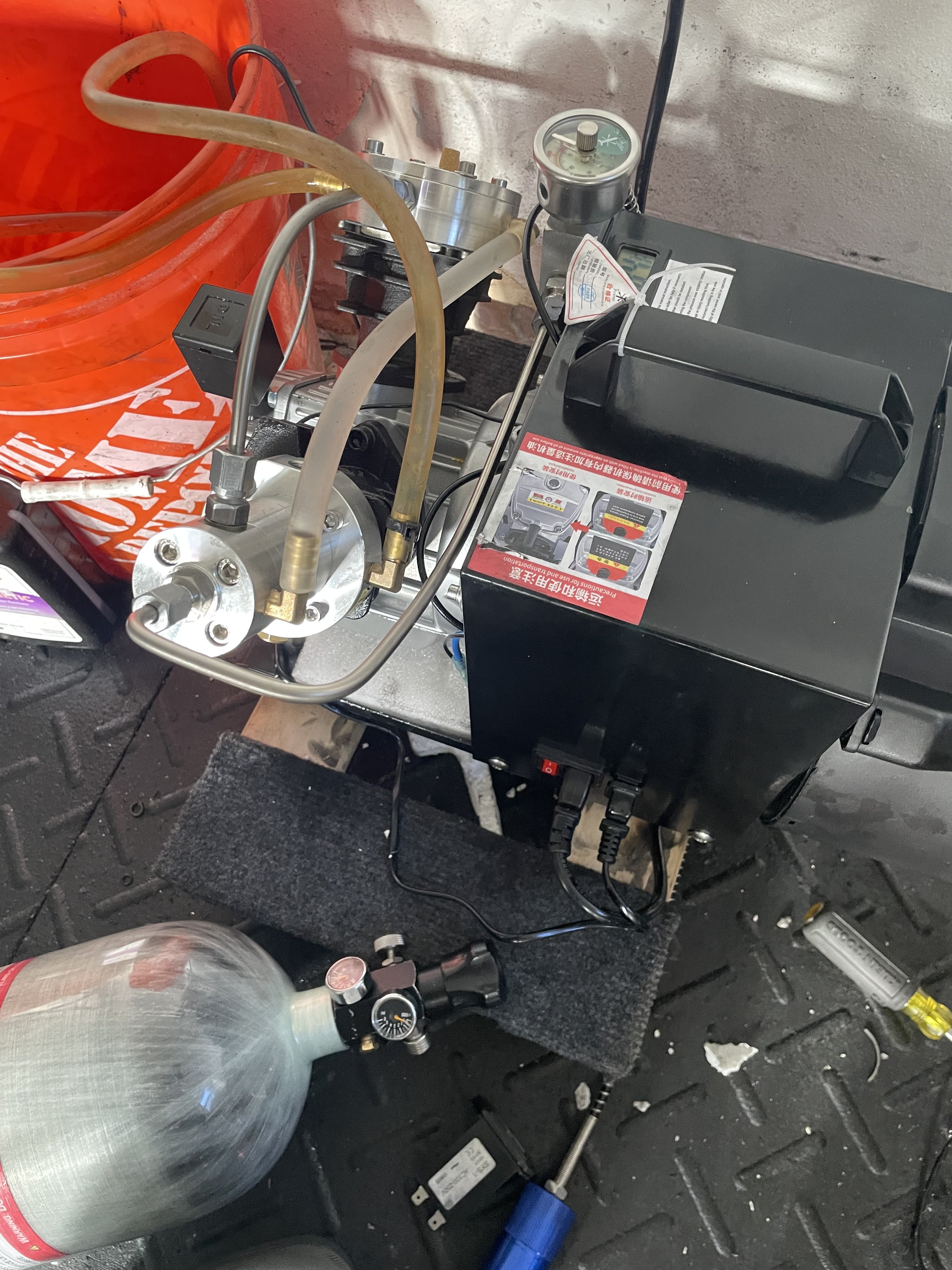

if anyone is interested in making
TXEDM041 Auto Stop. You would need to buy these 2 items from Tuxing.​
https://www.tuxingcn.com/Electric-control-box-p2194164.html (Control box) and a manometer you can set pressure
https://www.tuxingcn.com/TXPG005-adjustable-pressure-gauge-p2079806.html
If anyone is interested, I’ll try to post pics and answer questions if needed
With a control box you can also add a over temp cutoff. Great for if your pump takes a dump while filling
Reactions: OldVet
