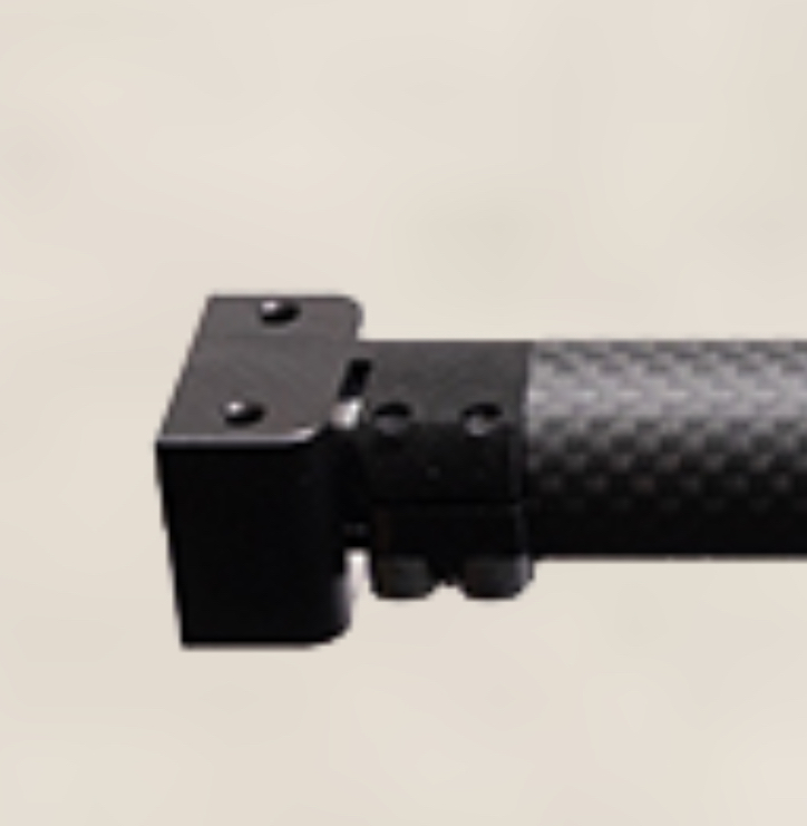

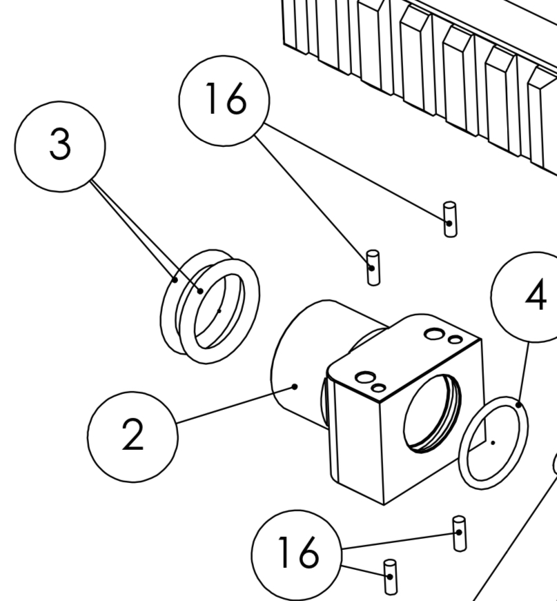

Hmnnnn - 6 gun, my understanding was that the tensioned rig clamps tight to the barrel, then the muzzle nut pushes the cf sleeve against it. Shroud spacers would essentially be pulling the barrel against the action block (where it’s only held in by a grub screw). Doesn’t sound fun.
Jman, the tensioned barrel kit comes with a replacement support block that clamps down, whereas the stock block has orings and the barrel slides right through.
Fist pic is a tensioner, second is the m4 block (with locating pins)
The kit, plus a cf liner sleeve, is supposed to be killer….

I use the o-ring method as well. I didn't know there were instructions, it seemed like the best solution to me.
