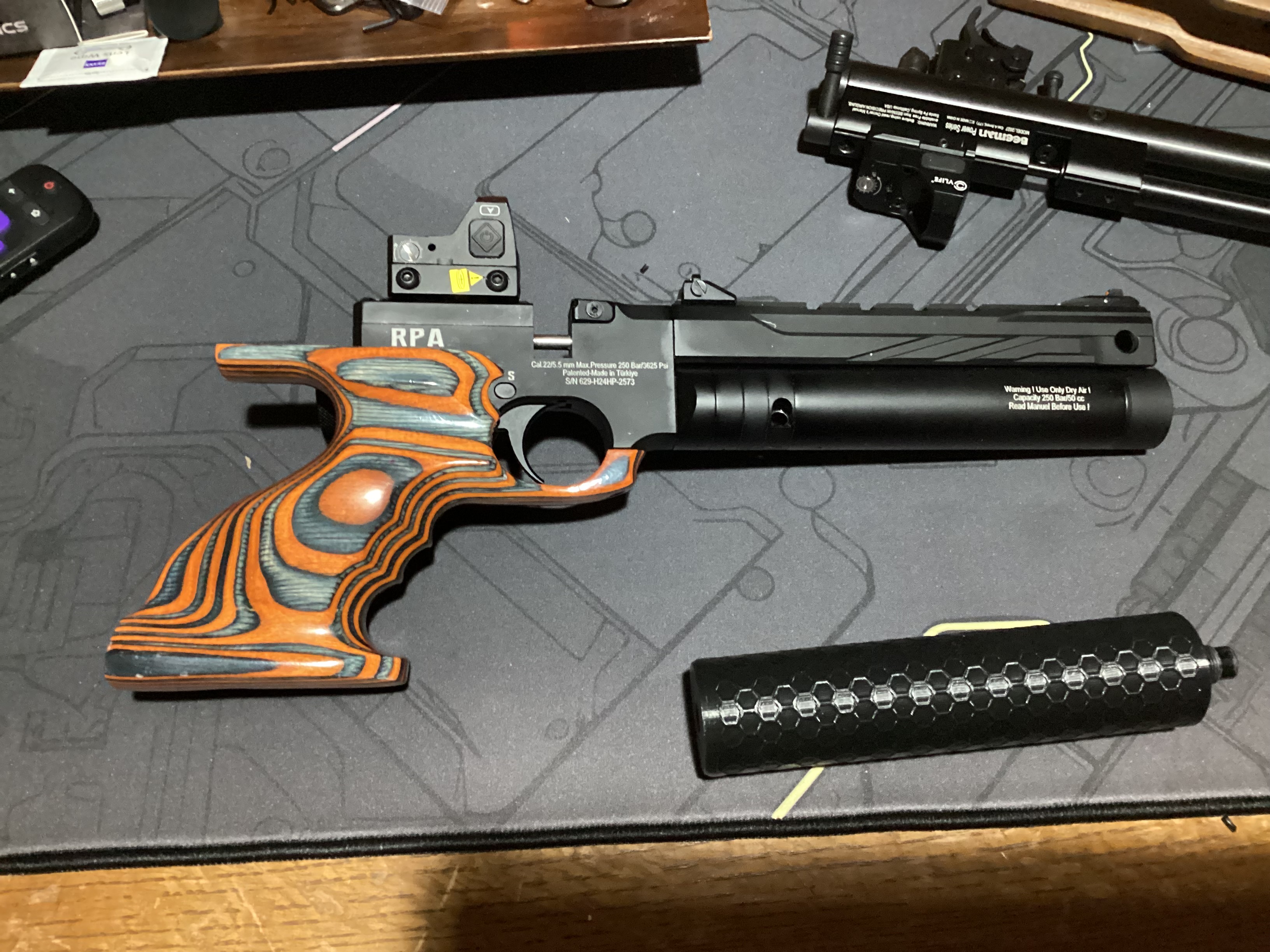

Anyways cheap is my Beeman 2027 mid priced for me is the Reximex RPA
i have in 22 and has taken the majority of squirrels of all my guns. It’s priced
from high $300s to high $400s. Have a Huben and Crosman 1701p also.
if I had to have only one pistol oh well I’d keep the Huben. But if I could have
two the Rexy it is.
