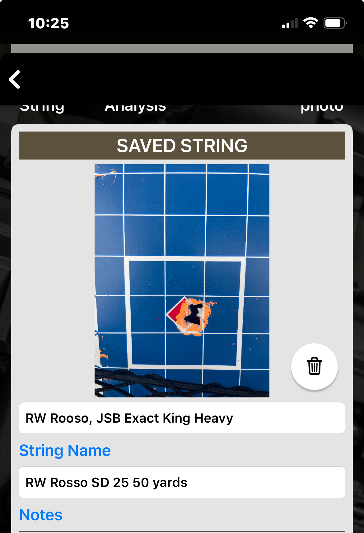

Don’t shoot with a moderator, as I was saying the first shot is off I can shoot 10 20 30 shoot in a round no problem let it sit for 10 minutes and the same thing it might go left on the first shot and then 10 minutes after that it might drown right an 1 1/2
I can pull one of my other daystate rifles out and it will shoot a 5 shot 1/2 groups at 50 yards all day
Here is an example of my Daystate Rosso 25 caliber at 50 yards.
I have let my neighbor shoot my air guns and he doesn’t shot much his words are it not my shooting it must be the gun that shoots so well
