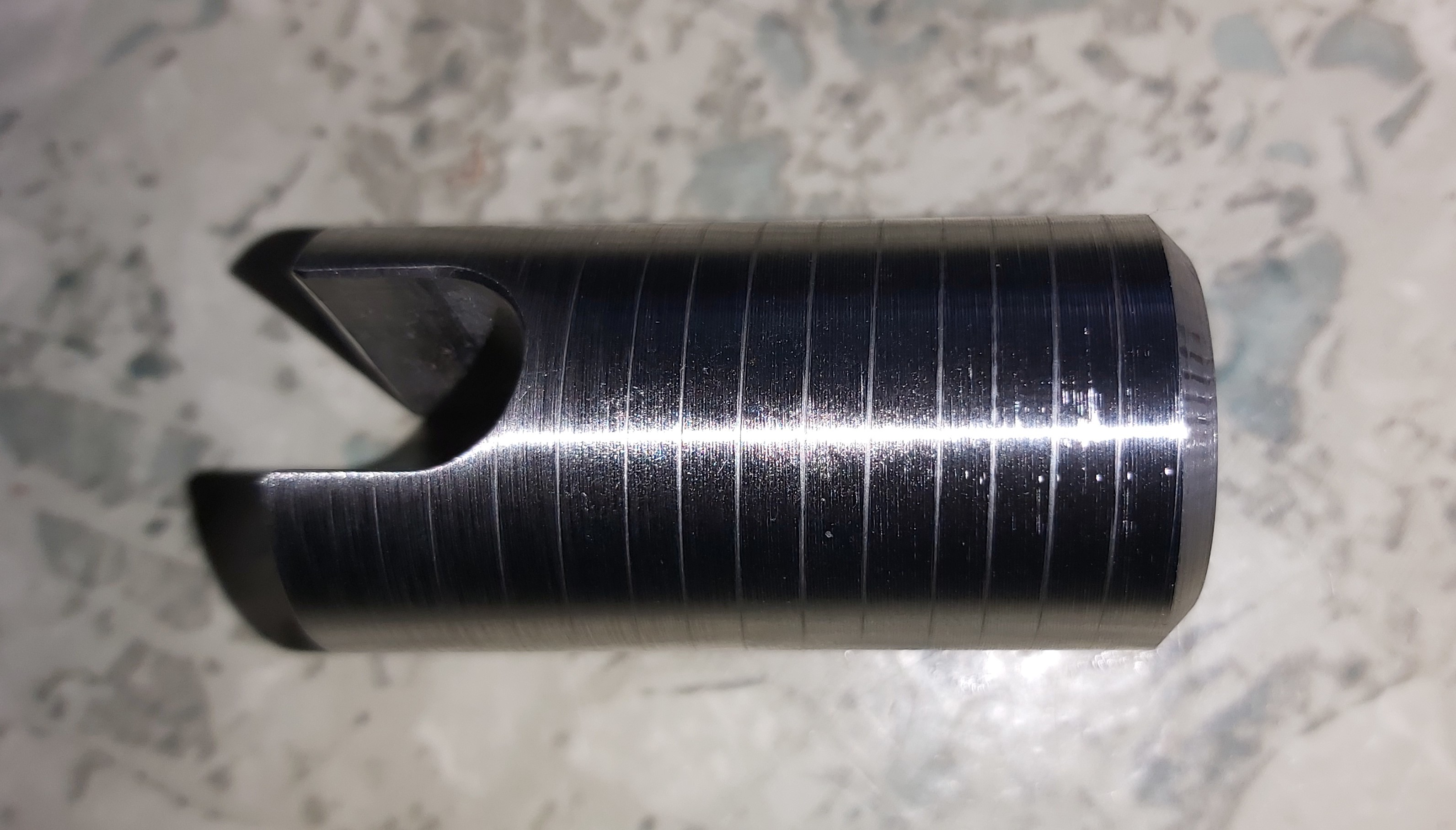

i concur the trigger spring is not needed the sear will reset the trigger and if you install the screw and lower the sear screw the trigger is first rate and that will give anyone looking for a nice little spring pistol something to buy
now my pistols had been done already and the spring removal was icing on the cake
great idea
now the trigger hole is 5.5mm and the pin is 5mm and the case and cover hole are more then 5mm so that could be a place for a larger pin and it could be shimmed but 0.5mm was too much, i think .1mm each side .2mm total could help
i put some tape in the frame hole and that helped
great idea thank you
