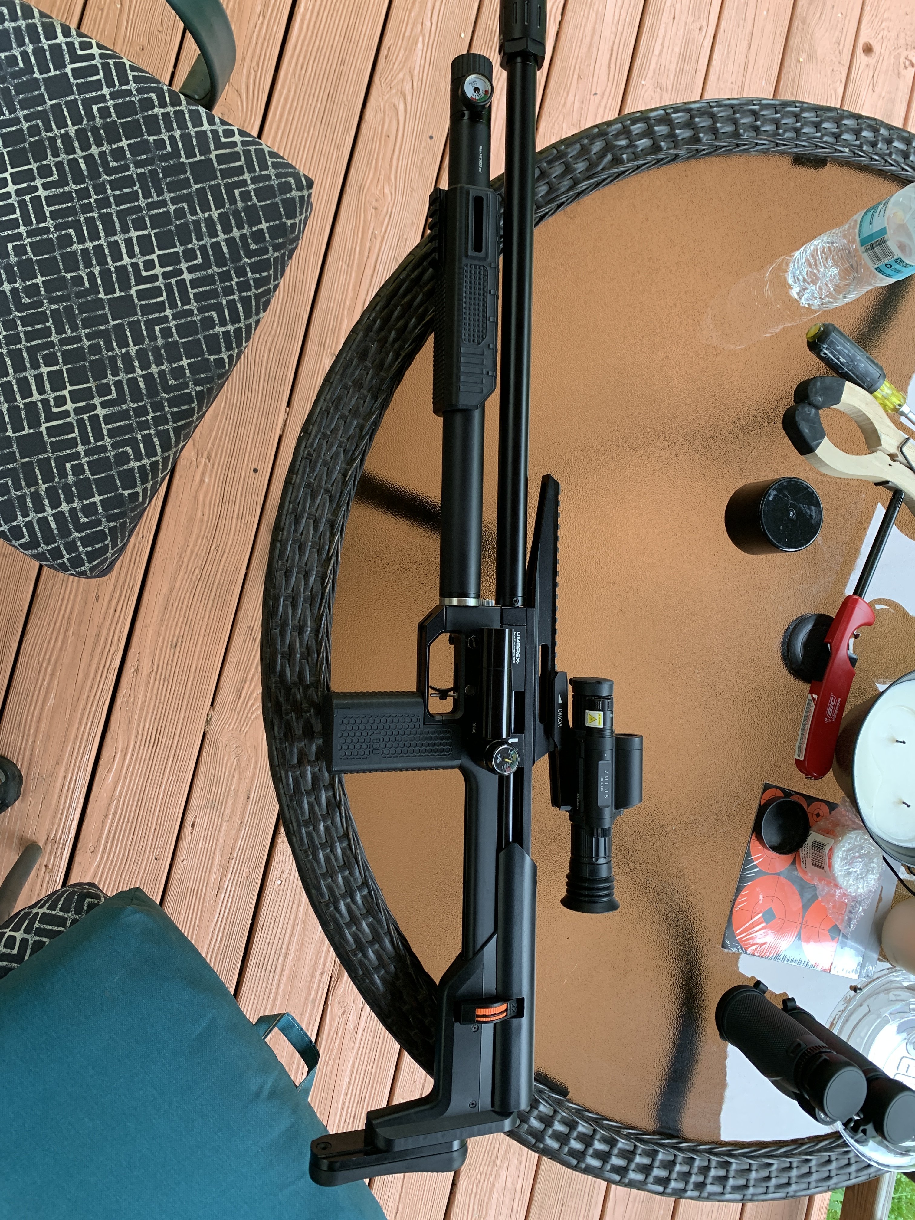

Question on a screen mount adapter
Honestly if it's just for daytime use I would give one of these a try, save some money and if it turns out to suck you could return it.
