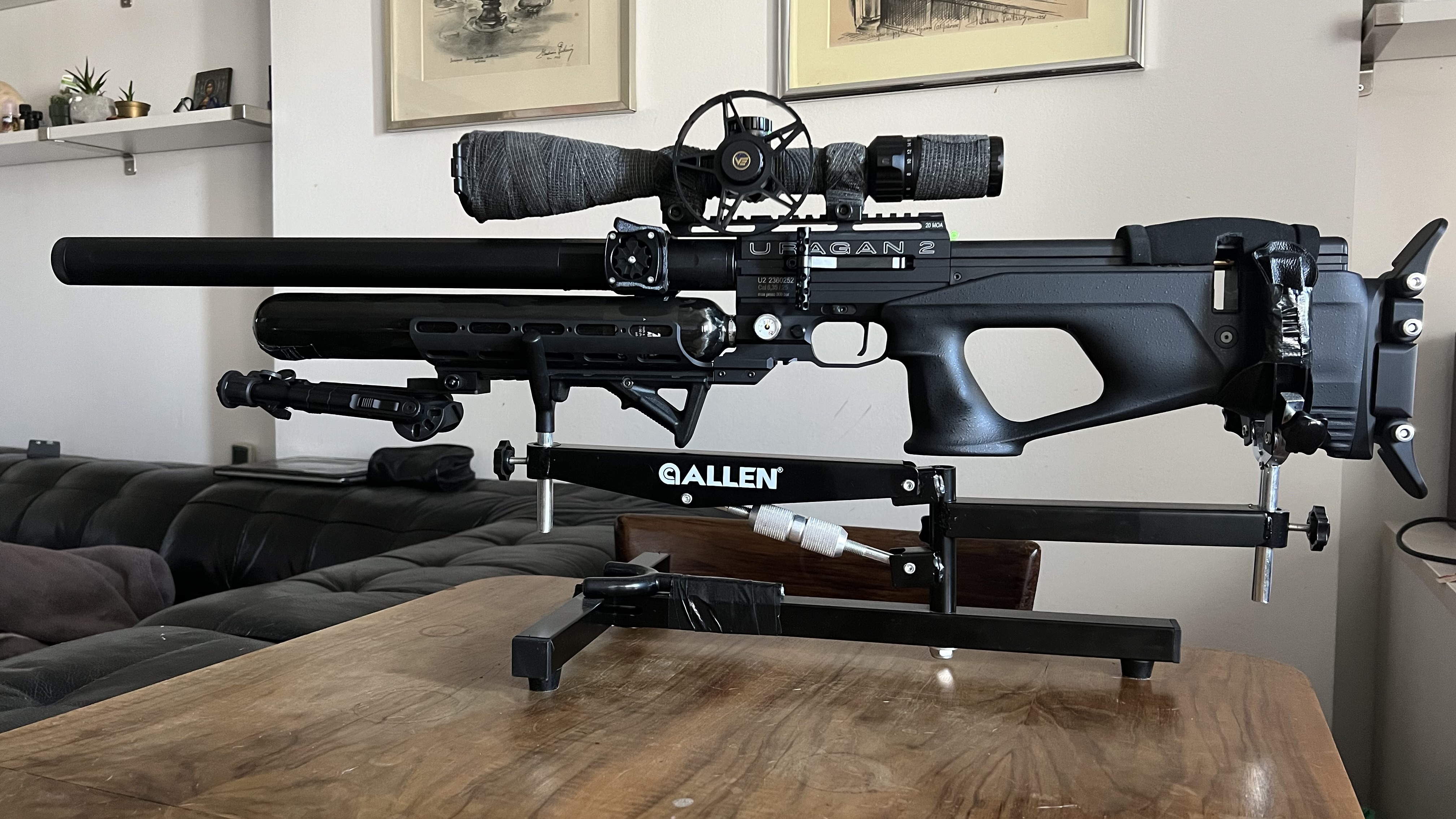

Airgun Technologies  Cheek riser for AGT
Hello all 👋
After more than a few DIY cheek riser projects, some better some less good, I discovered one aftermarket solution that goes well with Uragan2, but it should fit all AGT airguns that have the same plastic cover piece above the barrel.
It holds really firmly, only if I want to clip it above the magazine- I have to dremel the magazine slot on it. But for now- I don’t need to do that.
It’s the AK Zhukov S stock style cheek riser, hight 0.25” and it fits perfectly with medium size accu-X adjustable elevation scope mount rings (32-38mm).
Here’s the link:
PS. I have never found lower scope mounts with adjustable elevation, so the cheek riser was mandatory for my setup.
If anyone knows some lower yet adjustable rings- I would appreciate it.
All the best,
S.
