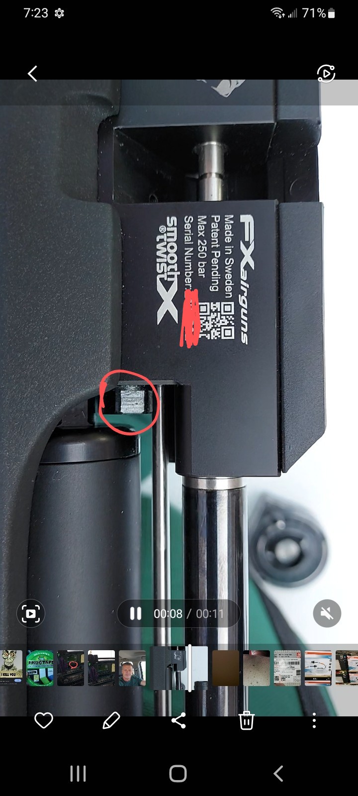

SO this is actually my first airgun, the Huntsman Revere in 25. GOt the demo one from AOA. So far, its just a lovely piece, but anyways, I was feeling a little stock movement specifically near the front of the gun under the air tube. THe other areas feel solid, but there's a little creep in that front part of the stock. You can rock it and you would feel it move ever so slightly up and down. I'd turned the hex screw in front of the trigger as far as it would go, but it still creeps. Is this normal? Anybody got a solution for this?
