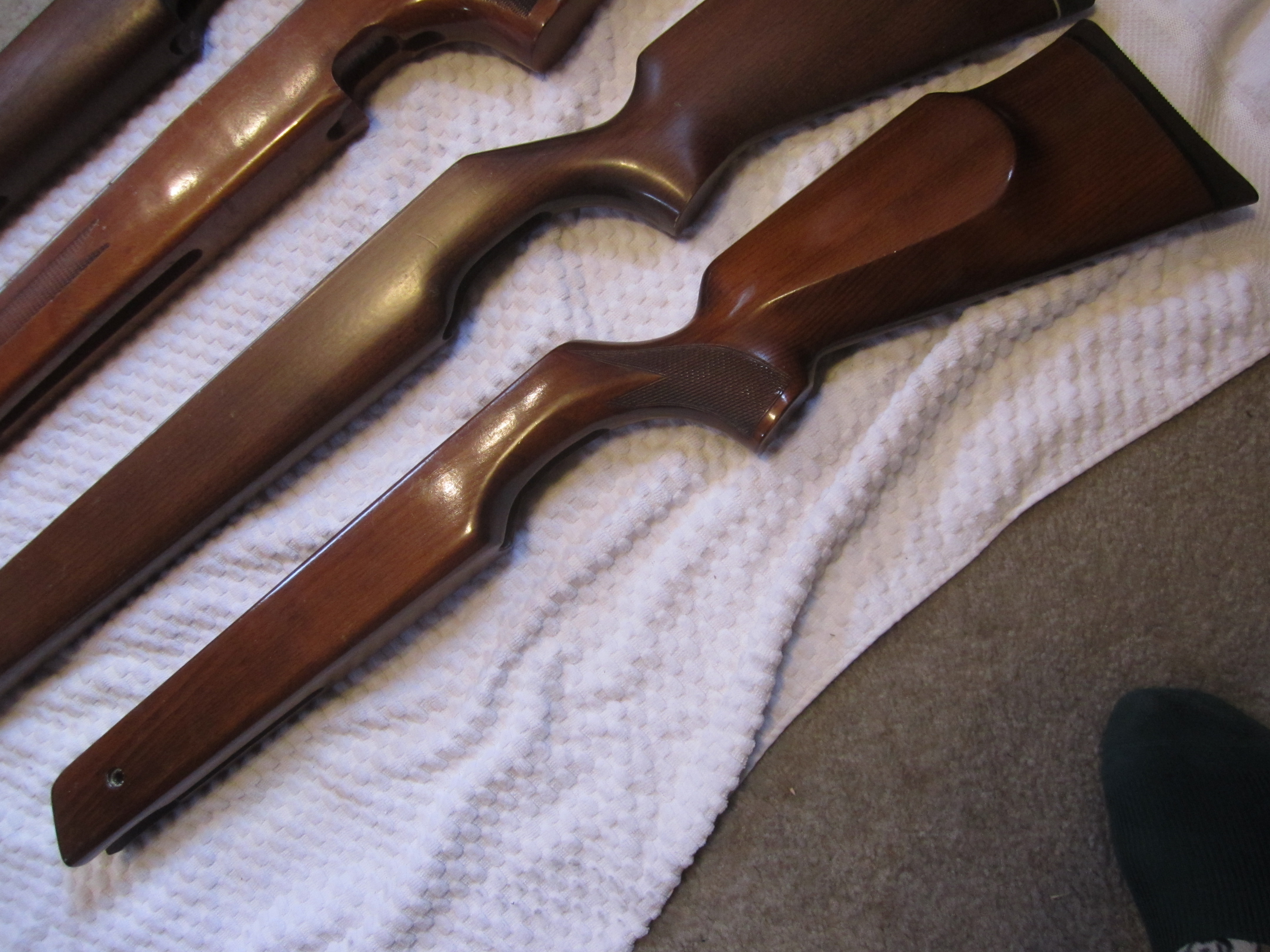

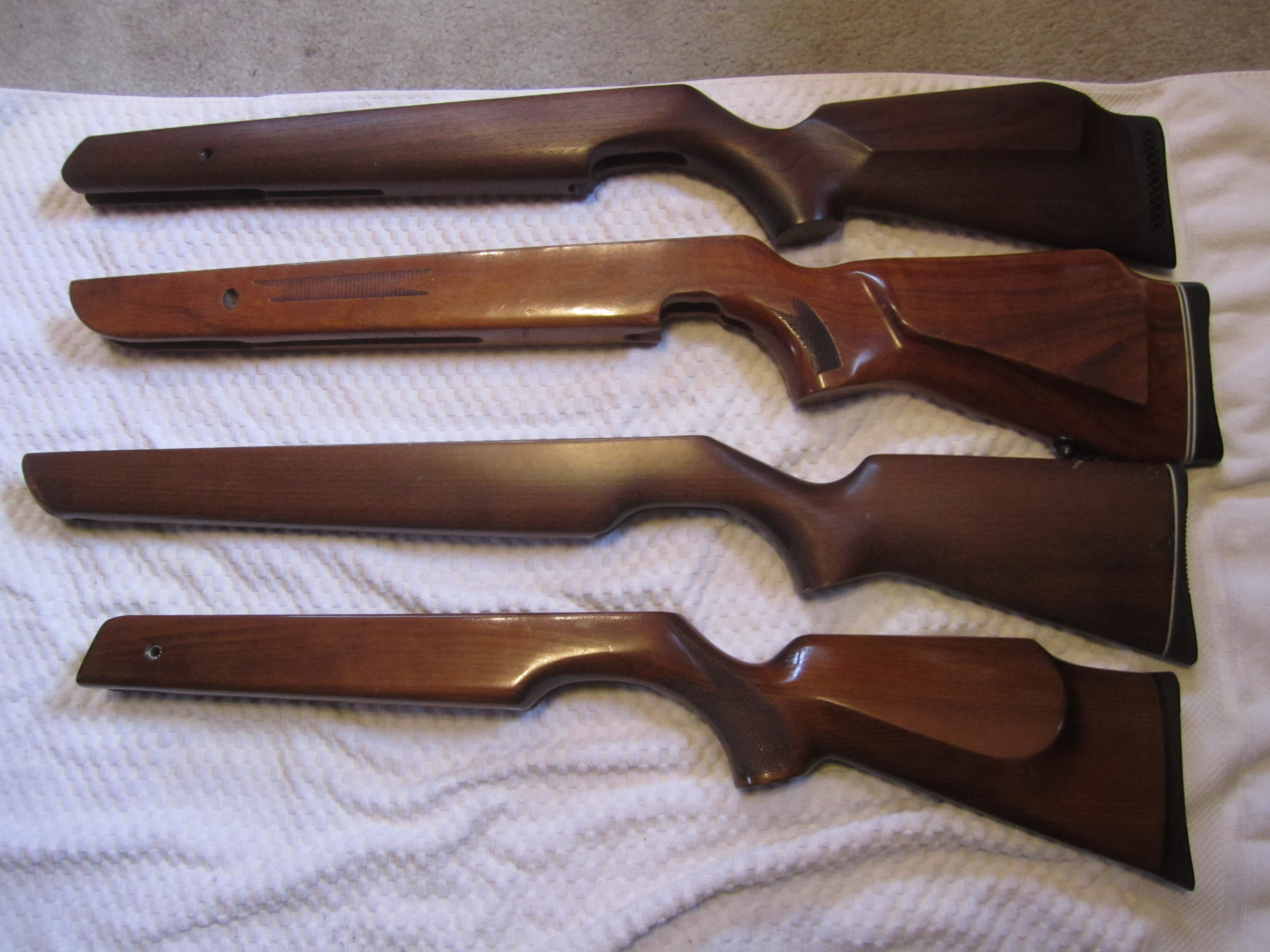

FWB 300S Replacement Stock
I am new to this forum. I recently sent a 300S to David Slade at AIRGUNWERKS for rebuild. When the completed rifle was returned by one of the national shipping companies it came out of the box in pieces. I am reaching out to the masses looking for a replacement stock. I would love to find a left handed stock ( I know I am dreaming but it never hurts to ask). Thanks in advance for any leads.
