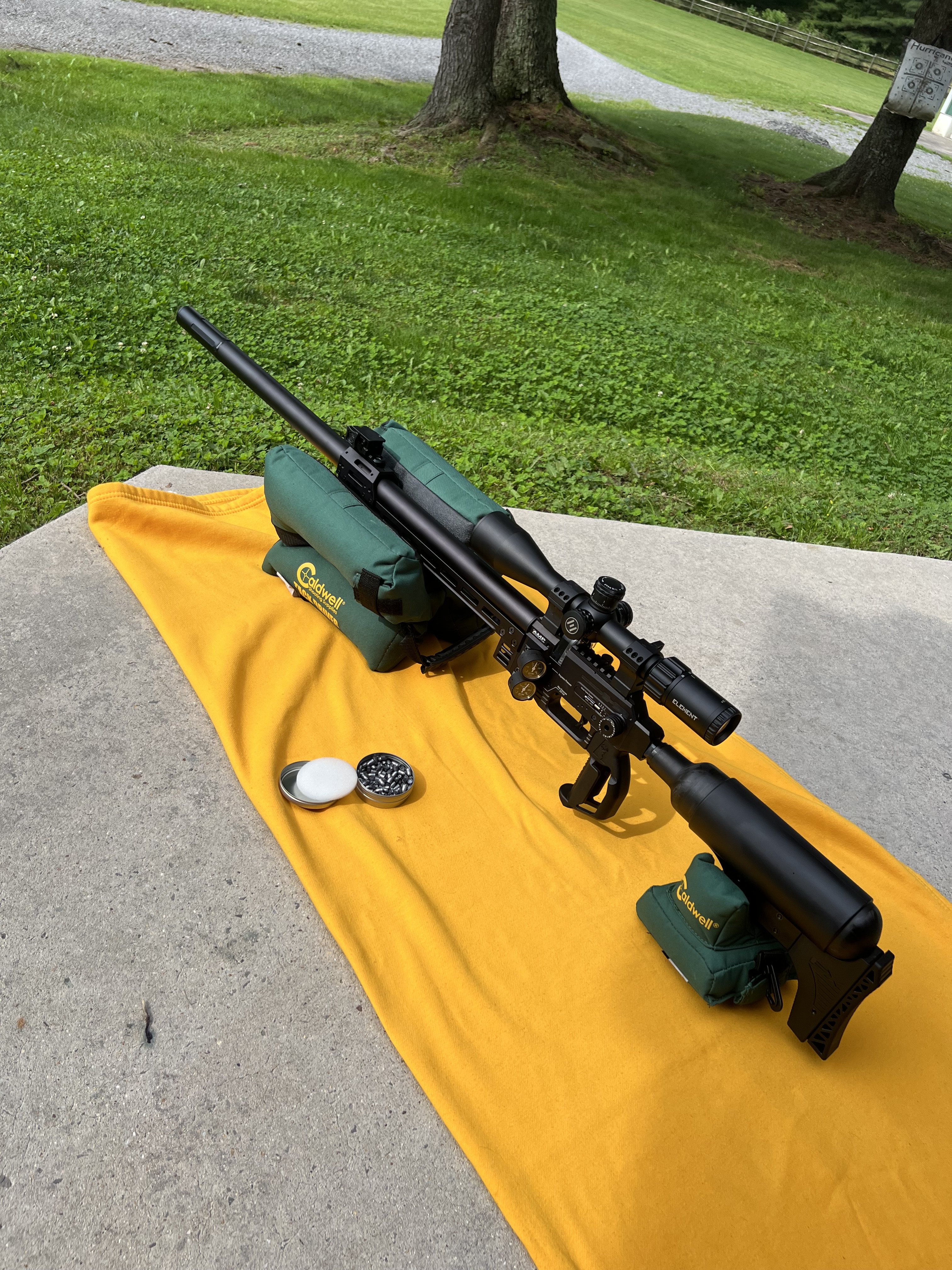

FX  Impact M3 velocity drops 100 fps after sitting over night then takes 20 shots before it returns back to 990fps. Reg pressure unchanged during process.
My M3 performed flawlessly for the first couple months after I purchased it. I had it tuned to 1/2” groups at 50 yards with the 2nd reg at 150bar and velocity at 990fps +/- 3fps. Every time I took it out it was dialed in. But I did noticed that whenever I took it out after it had been sitting for a day or two that the first 5-6 shots were slow. They would be something like this: 930, 950, 960, 970, 980, 990. I figured I could deal with this. Before hunting I would dry fire the gun around 6 times.
I took a break from shooting during the past 2 months. I did not make any changes to the gun during this time. It just sat in its case. I took it out to shoot. I checked to make sure that the reg pressure, valve and hammer were all set to where they were they had been when the gun was dialed in at 990fps. The first shot was 850fps! Over the course of 20 SHOTS the velocity eventually climbed to 990. I thought maybe things just needed to get warmed up after being unused for so long.
But then I tested a shorter time interval between shots. I took 10 a minute break, then the took a shot. 960! After just 10 minutes a drop of 30fps! Then over the course of 5 shots it climbed back to 990. This is not how it behaved before. If I had taken a 10 minute break 2 months ago, there would be no change in velocity.
The next day I took the gun out again and the first shot was 930fps. 15 more shots and it’s back up to 990.
Any ideas guys?

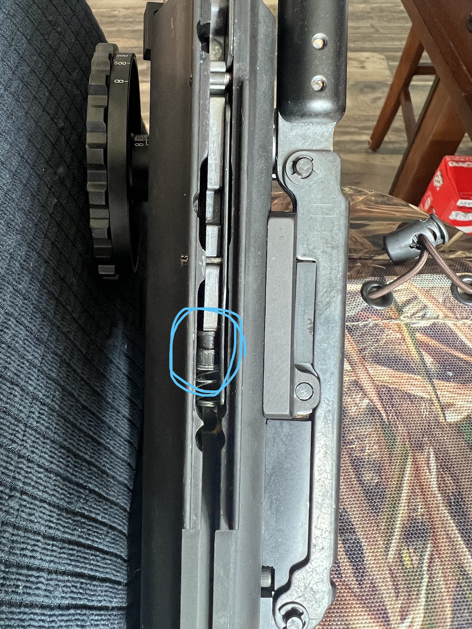

AF Texan .457 LSS
Looking for some help.
Have an AF Texan upgraded with a lot of African Air Ordinance parts. Hard as hell to cock, so I changed to a shorter spring. Seemed to help that issue. The auto safety has been removed pervious to the aftermarket upgrades. But now every other time I shoot, this piece is getting stuck under the hammer catch, and I have to break down the gun every time and remove it from under the catch.
Do I need this? Can this come out? What is it used for?
