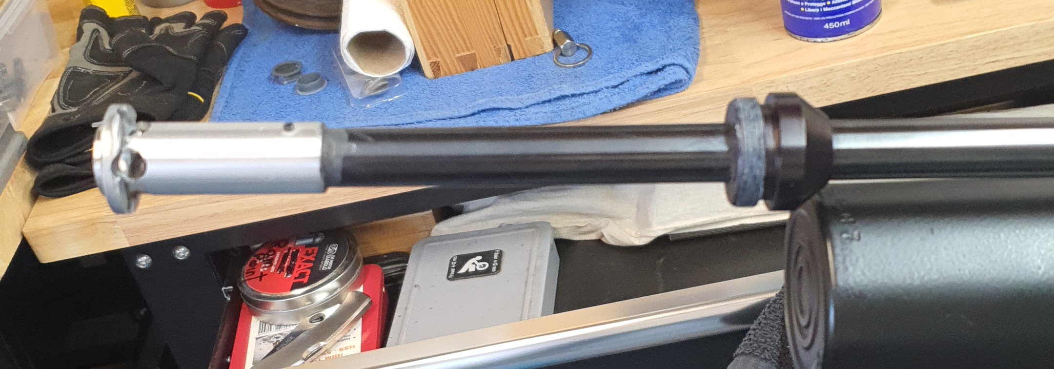

Need a barrel OD ground
Just the breech end.
If your lathe can skim .000-.002 per side without chattering or making it worse, it could work. I assumed only grinding would work here because of the varied and minimal stock allowance.
well if it is pretty round and straight could just spin at high speed with emery cloth,you'd get a good finish but it will take off any current finish..
you didn't mention if it was just the breach or full length..
generally lathe tooling will leave very tiny, like threading marks, so I pretty much always finish up with emery cloth.. depends on how much needs off but I have 3 different grits and the fine makes a mirror polish
