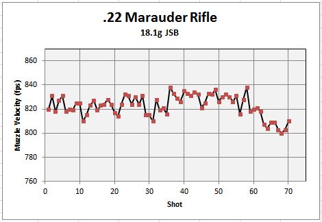

Per fill I'm getting 62 shots at an average muzzle velocity of 825 fps with an extreme spread of 30 fps on unsorted 18.1g JSB pellets. Here is the plot of the string:
Maybe 70 shots if a little higher ES is ok.
