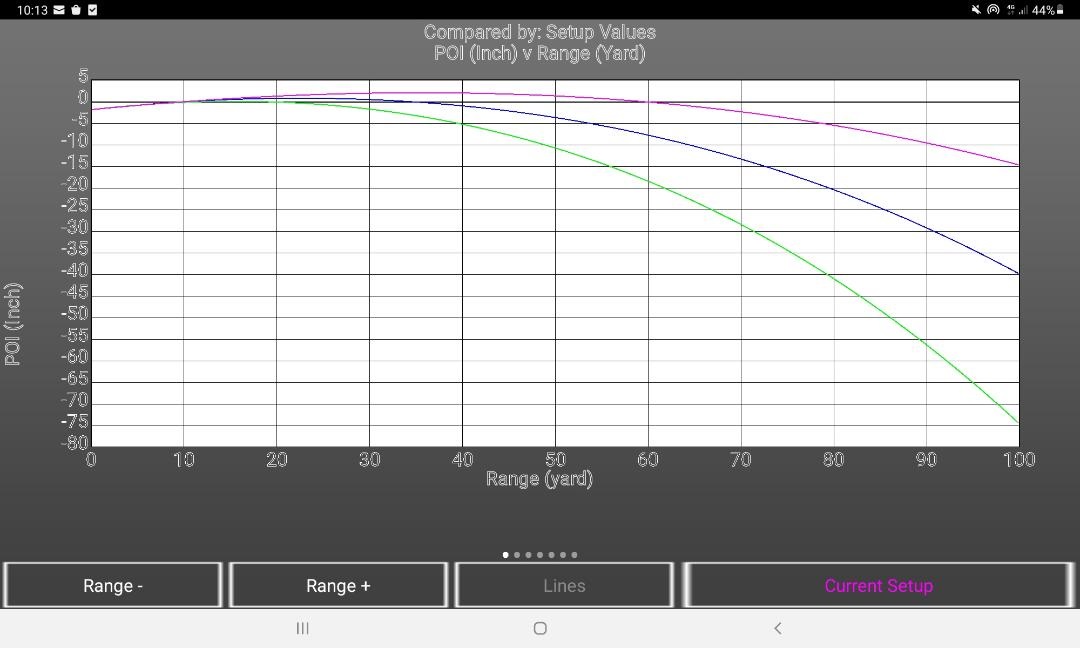

Thanks all. Chairgun shows that if low is zero'd at 20, then medium should be on at 35 and high should be on at 60 y.
Wil go and test it out on the weekend.
Interestingly they all go through 10y as the first zero. I will definitely check that out also.
