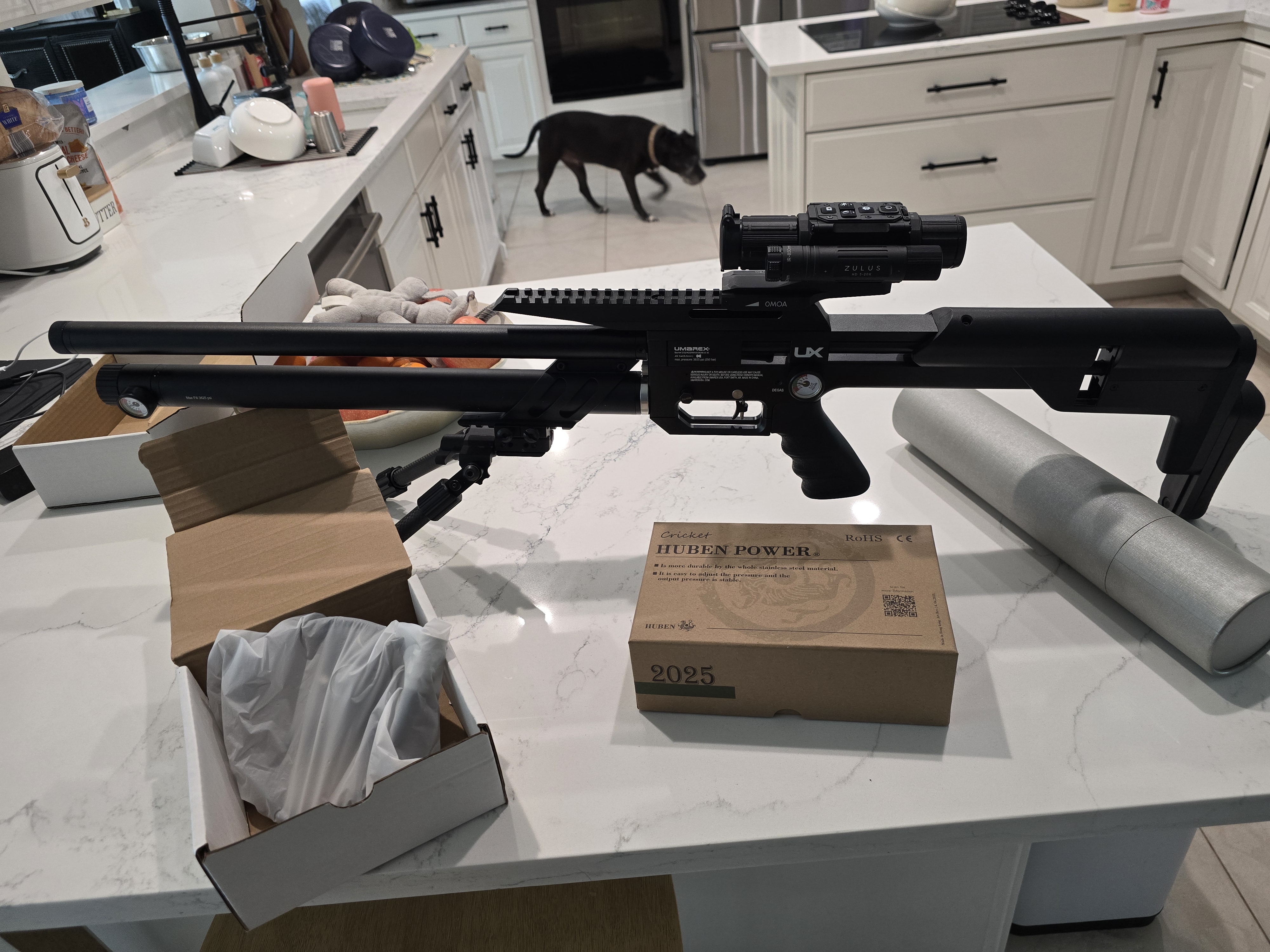

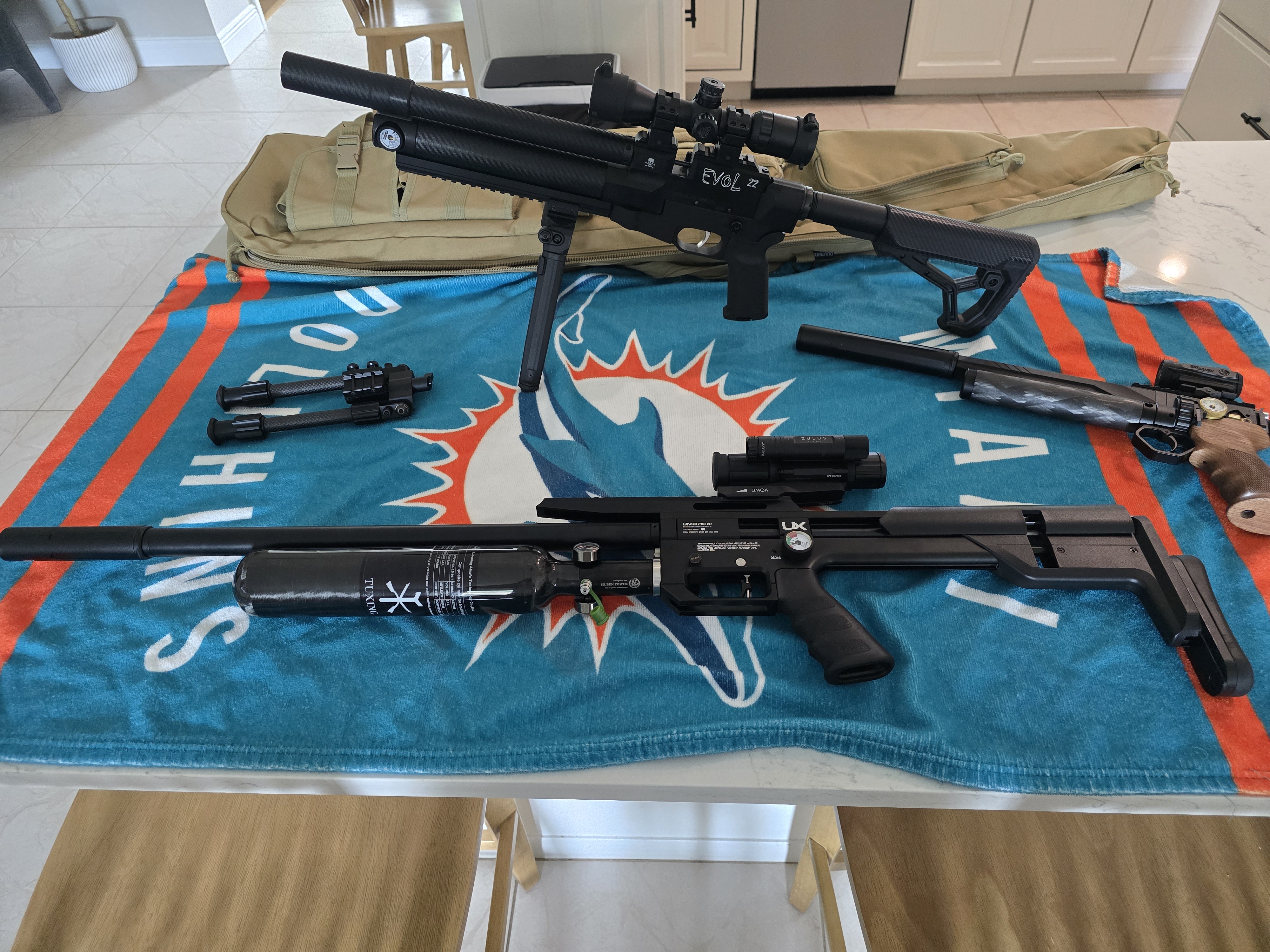

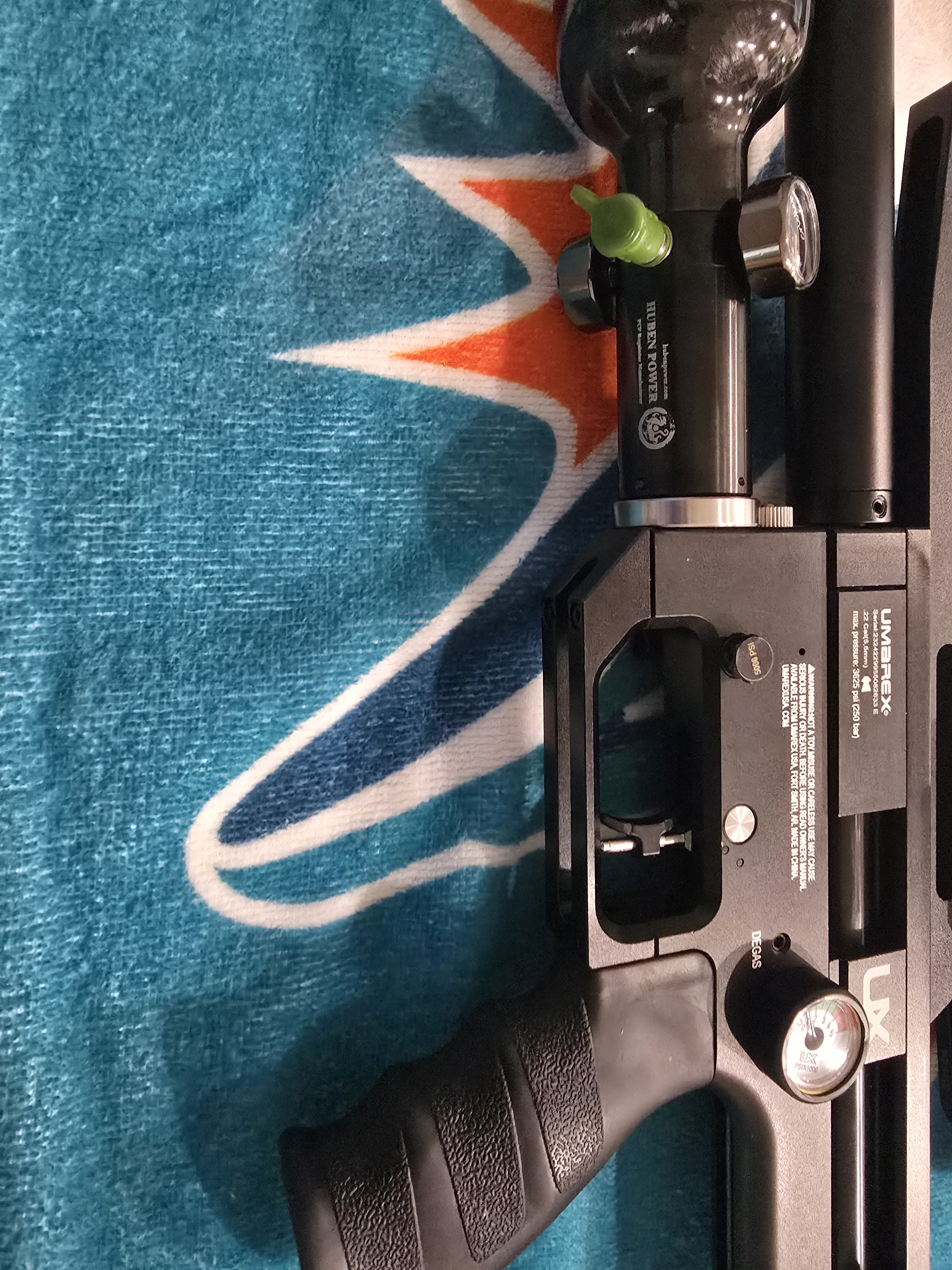

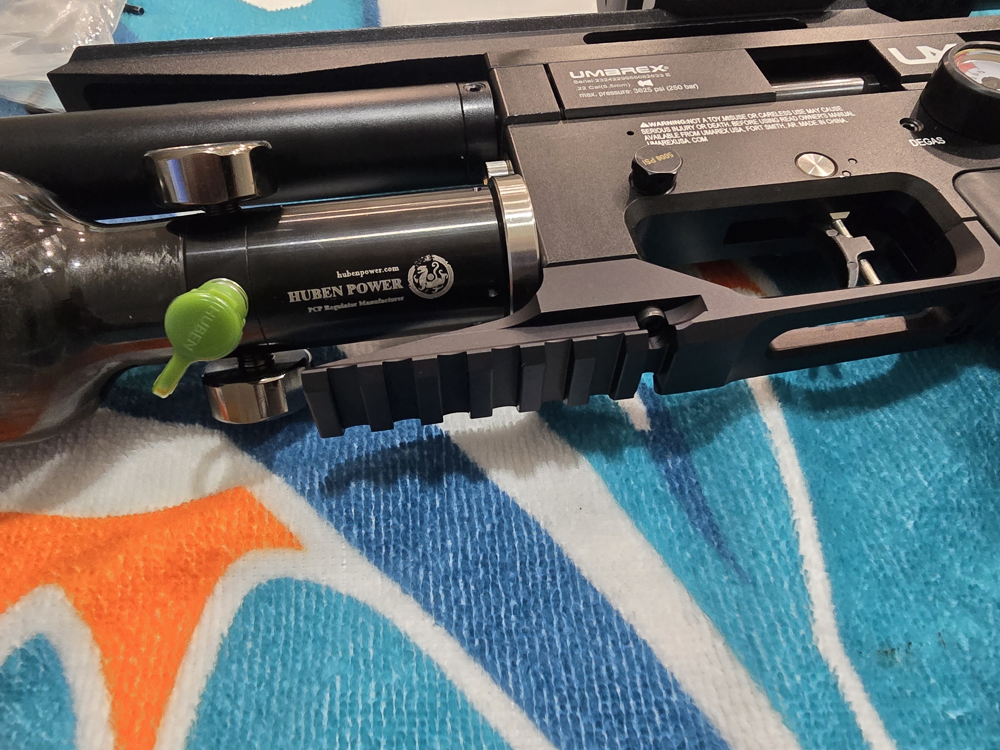

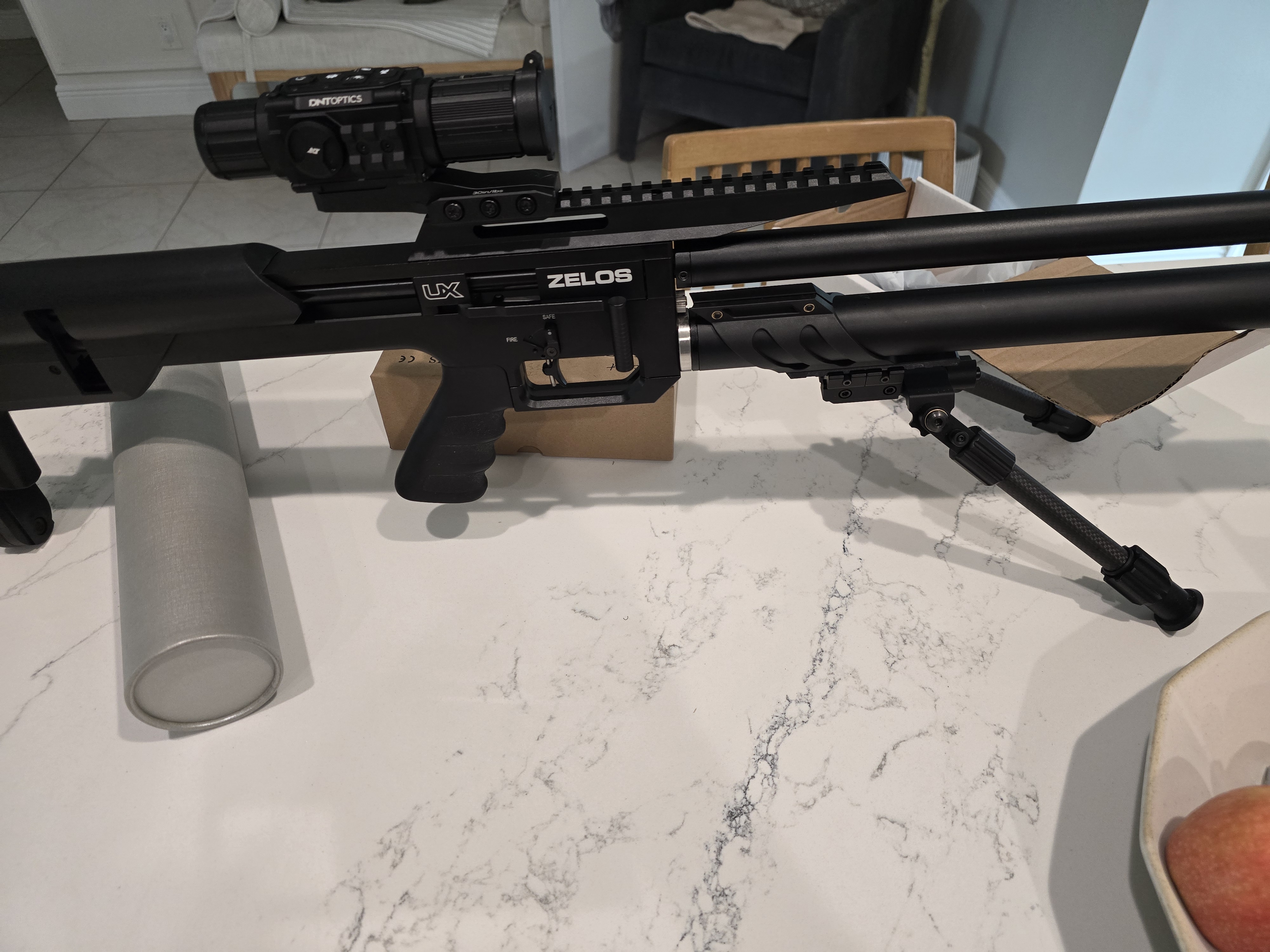

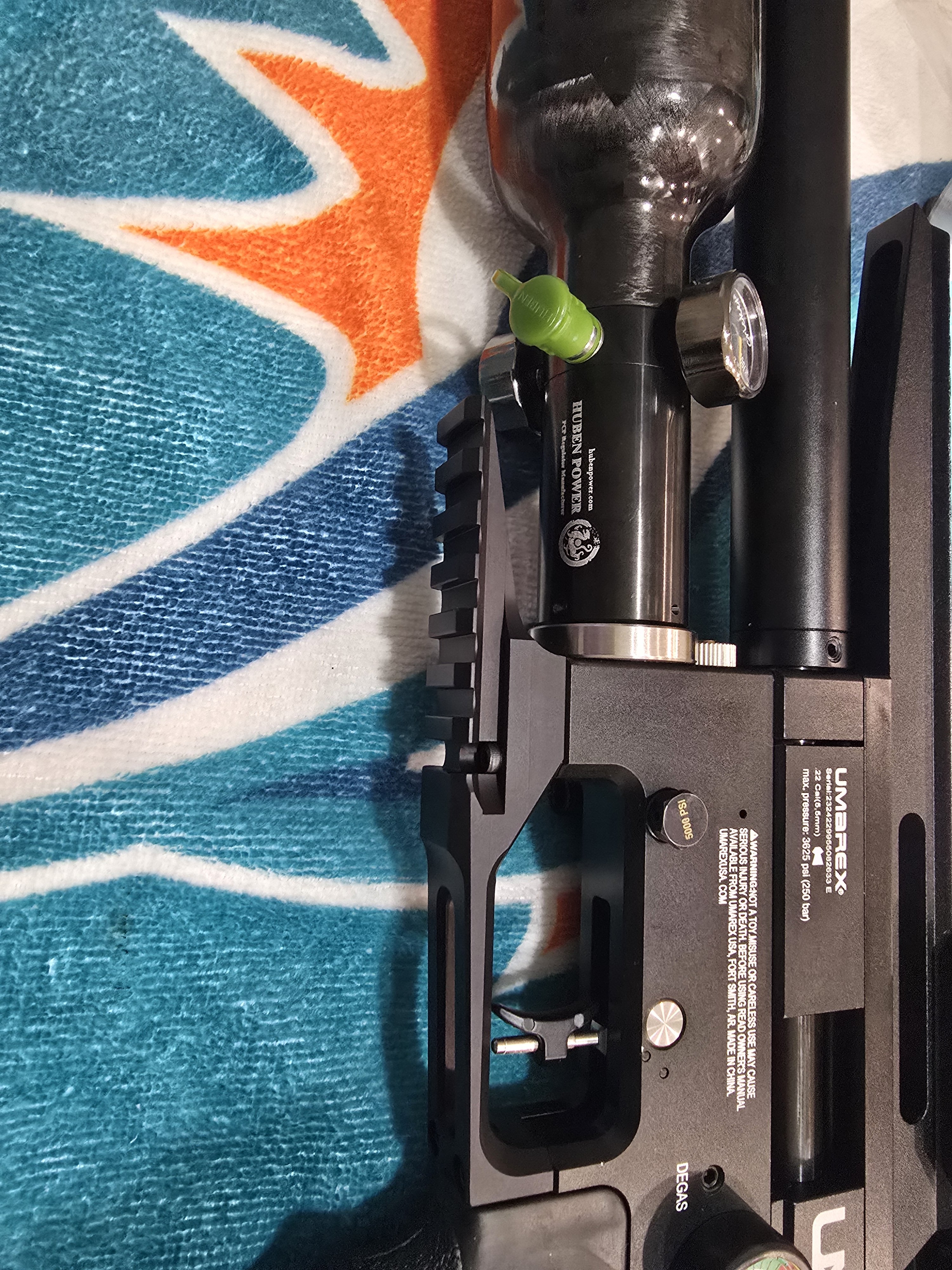

Finally got around to putting the bottle on my Zelos .22
Was waiting for a long time on my Huben Power bottle reg. Once it finally came in, I threw on the bottle which had been waiting. I wanted to be able to do a 4,500 psi for shot count, which is why I opted for the Huben over the other adapters.
I was waiting to make a decision on which bottle clamp to use. Eventually decided to try the Heartland Airguns trigger gaurd with picatinny rail extension instead. I'm really glad I did. I reached out to them before buying it asking if it cleared the huben reg and fill gauge. They responded with and honest answer that they dont know as they haven't tested with that bottle reg. I decided I'd be the guinea pig. I'm happy to say it fits great and has no issues with clearance, not matter how the bottle reg is clocked. Feels very sturdy on the bipod, I haven't tested it yet on the tripod with a arca rail adapter.
Very happy with the final outcome for the price so far, still need to test the new shot count with same Zelos reg and hammer settings, currently shooting JT's Dead Center 21 grain at 895-900. Getting just shy of 2 mags before it starts falling off a bit, but POI is still there within 40 yards and doesn't shift much for the full 2 mags, before the bottle addition. Will post the shot count results for the bottle at 4,500psi when I get a chance. Attqched are some before and after pictures.
