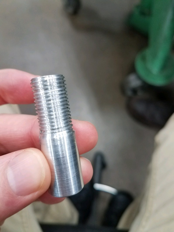

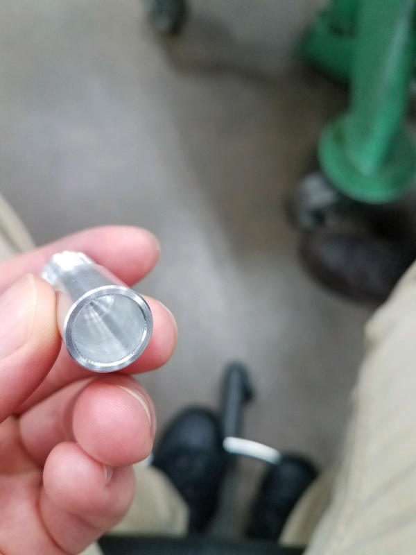

I also engaged my friend to make me thread adapter for 1/2 - 20 LDC.
Just have to get m12x1mm tap and figure out what diameter should be thru hole.
Just have to get m12x1mm tap and figure out what diameter should be thru hole......hi Shutik, did you get the adapter threaded inside yet ? & are you planning on using the original shroud ? or just the barrel & Ldc , I am very interested in your progress , thanks , roger
