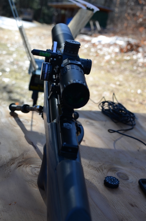

I've tried 2 more different pellets at 60 yards today, crosman premier 10.5 and JSP 13.4
Crosman's grouped better, little under an inch. Was a bit windy 5 to 8 MPH.
Also, I've added weaver rail at the bottom and made hamster out of oak. It attaches to the rail with scope ring.

I was shooting my today, the range I have it's only 25m (+/- 27 yards) and I got a really nice group, almost hole in a hole with a bit of wind, Shutik, I think that your group is really nice, considering it's a 60 yards, windy and for a .177...Really good!!! Hope that you had more time and shot some more, please post more results, if you don't mind, it seems that you're getting used to the rifle, I always take my time between shots. Do you rest yours on the cylinder or on the stock?

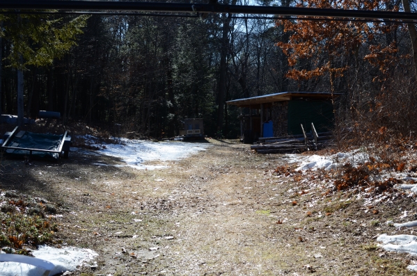

I rest mine on bipod. Here is the picture from my dad's shooting lane. 60 yard target all the way in the woods up in the tree.
I was shooting from the table at the start, but these latest shots were from prone position. I had to get creative to make 60 yards distance in my back yard.
