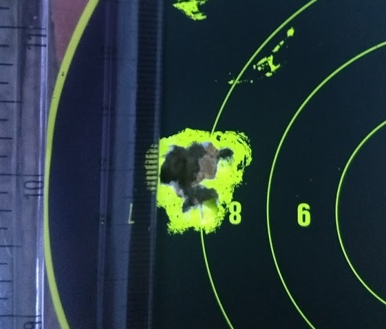

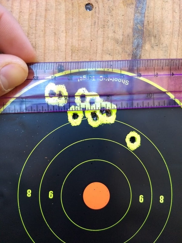

It was better group at 40 yards with faster speed, conditions were a lot better too. Only slight breeze, maybe 2 MPH and higher humidity, like 90. Snow started melting all around.
    I think it was half an inch for 12 shot group, here is picture.

        That's a nice group, looks a 11/12mm +/-, taking in consideration that the rifle it is still new, once the barrel is leaded and the reg setted in and the right pellets, I think it will be a tac driver.
