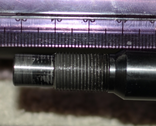

Do you know what the thread is on barrel?
It is metric thread. Thread pitch is 1mm between threads. Same diameter as standard. So my guess M20 thread.

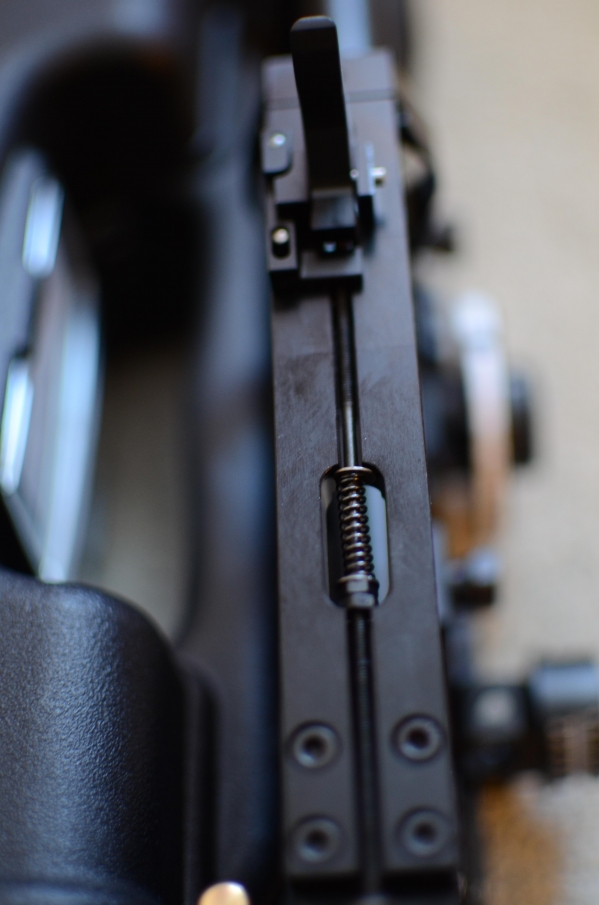

Here is the action taken out of the stock with spring pre-load adjuster shown. It locks in place with grub screw.

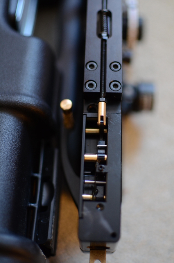

This is trigger linkage. Although it is adjustable and smooth, I can't really tell when second stage is about to let go. it can be made very light, but seems to not have exactly same position of release. Maybe I'm not used to it yet.

Also that looks like M10x1 thread, same as a Sumatra I believe.
"BigTinBoat"
You are probably right, I will ask manufacture about it.
From my discussion with manufacture I've discovered that they started making longer models with LW barrels that have standard 1/2 - 20 UNF threads on the end. They offer 450mm and 550mm LW barrels.

You guys are correct, my has a 450mm barrel in .22 cal 44j, the shorter version which is the .177 cal has 330mmm barrel 22.5j, both threaded with a M10/1 thread, the shroud has no thread, it's secure by the moderator that screws on the barrel, I found that my is not back yard friendly. For the next gen for 2018 they're lauching the rifles with threaded 1/2" UNF LW barrels, which I don't see why as their own barrels are very good, accurate out of the box. Maybe to increase sales and popularity???
