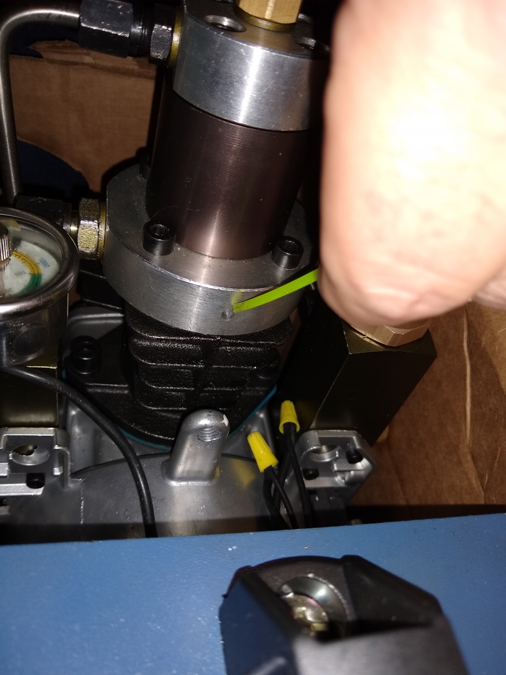

The temp probe just hangs off of the bottom side of the temp gauge on my Yong Heng and imo is only a motor temp indicator. Most of the heat generated comes off the water cooled head and there’s no way the temp gauge is showing head temp. Just the motor and case temp.
Edit:
Thanks vinny and molder for educating me where the probe goes, I thought that was a stupid place to read temperature, I guess I need to find some instructions, lol
 this hole is where the temp probe goes

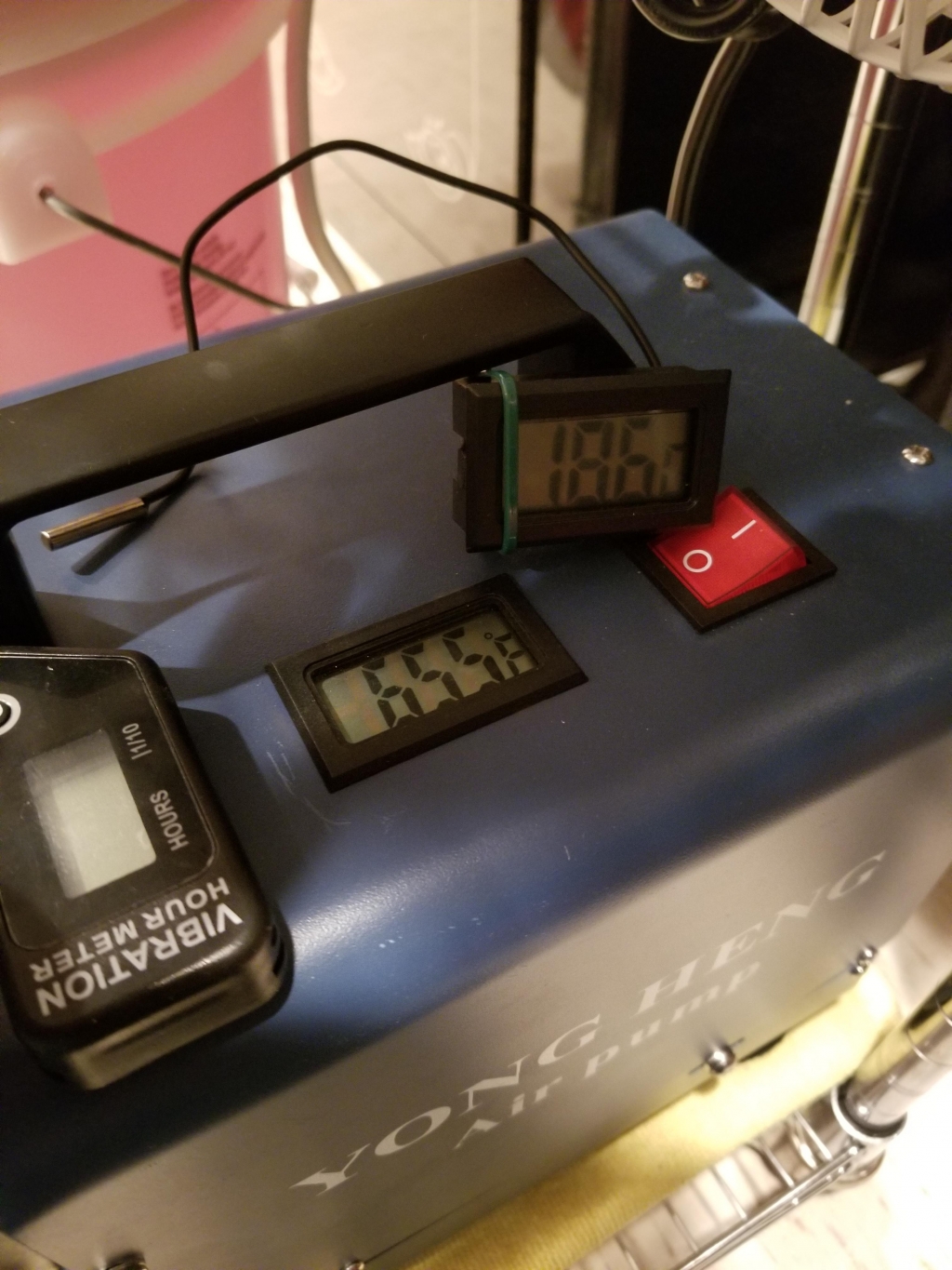

I bought a three pack of the farenheit calibrated temp gauges on Amazon for about $11. I had another use for the gauge so went ahead and got the three pack. My old celcius gauge and the new gauges are identical (except for unit of measure obviously). They are also VERY close in measured temp.
The slight difference in readings could very well be that the farenheit gauge probe is in contact with the aluminum compressor head and the celcius unit is reading ambient air. Both have been in the same room for days.
Very good find Rodeo! I appreciate that👏🏾👏🏾👏🏾
Hard to argue visual facts. Actually it's dead on 18.6 comes to 65.4 so dead even
