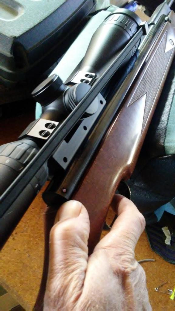

My R9 is a tad hold sensitive, this seems to work for me-I rest the forestock in my off hand palm up and the heel of my palm against the trigger guard. Using the heel of my palm I pull the gun into my shoulder with enough pressure so it's stable. I kind of pinch the trigger between my thumb and the tip of my trigger finger or lay my thumb against the pistol grip like this so just the tip of my finger contacts the trigger like this-

      • First, I chose to bench shoot off a bag with a completely relaxed left hand supporting the balance point of the rifle, rather than the rifle directly on the bag. This seemed to be more consistent that shooting directly from the bag, which mystifies me, but so-be-it.
      • Next, I took some advice here and simply brought the gun to bear in the general direction of the target with a relaxed natural position over and over again. No shots fired. Just up to the bag -- and cheek to the weld -- repeatedly AND WITHOUT TENSION. I note how the gun rests on the bag, on the shoulder, and in the hands each time. I do it until its the same every time. This became the base of everything to come.
      • Now that I'm ready to shoot, it's time to make the first move. With my torso aligned so the gun is generally on target, I address the rifle by bringing my shoulder into it.
      • Next, close eyes and relax, relax relax. Sink into the bench and become concious of your breathing like a Zen master. As you breathe, you'll realize you may have subtle tension in that supporting hand under the forestock, or in the shoulder connected to it. Breathe again and lose all that tension. If you peek, you'll see the point of aim move when you relax that last unconcious tension away -- and you'll realize how the slightest pressure has an effect. Ah Ha! OK keep it relaxed right there.
      • Now, open both eyes and adjust any verticle misalignment of your scope picture by using the most subtle of moves on the cheek weld or shoulder to get your cross hair 90 degrees vertical. DON'T TENSE THAT HAND UNDER THE FORESTOCK to do this and DO NOT YET ADDRESS THE TRIGGER OR GRIP. Keep that trigger hand free from the gun here if possible.
      • Next, (and I found this to be the most important) Using breathing and the muscles in your core -- adjust to the target by moving your body -- NOT YOUR ARMS OR HANDS. Use just enough pressure in the shoulder's contact with the butt and your cheek weld, and no more, to make the subtle moves directed by your torso.
      • At this point, I am mostly aligned and ready to address the trigger without harshly gripping the gun. I take up the first stage with the front pad of the finger and LIGHTLY seek an imaginary feeling of the gun's rear weight being supported by that light tension on the trigger finger (it is not in reality, it's merely a "feeling"). The thumb is restsing vertically above, not wrapped around the grip.
      • Now, I'm ready to to make the final few mm's of adjustments to the POI. With a last breath I make a final mental check --- forestock hand completely relaxed, grip hand in light contact with the grip but not applying ANY directiontional force, shoulder contact and cheek weld barely firm enough to support the gun, trigger first stage at light tension. I come to the POI and don't hesitate now!
