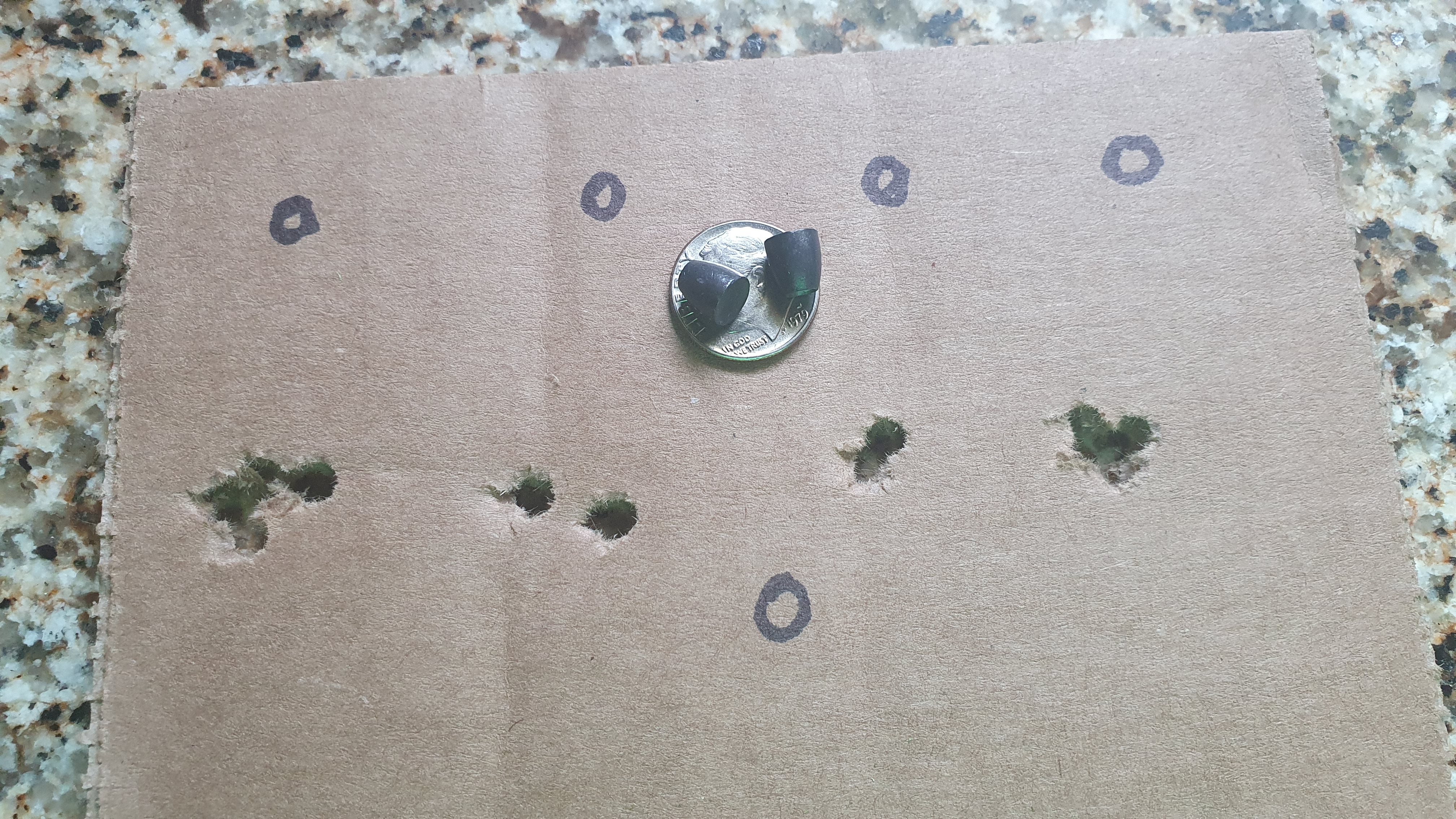

heres a picture of a few groups,
yes its very close range (13yds)
but for the larger caliber slugs to beat the group size of pellets,
well,that impresses the hell out of me lol
2 groups on the left are with the .250 hp II 28gn,
a 5 shot on the end,and then 2 more shots.
the 2 groups on the right are with the .250 hp 28gn,
a 5 shot on the end,and then 2 more.
