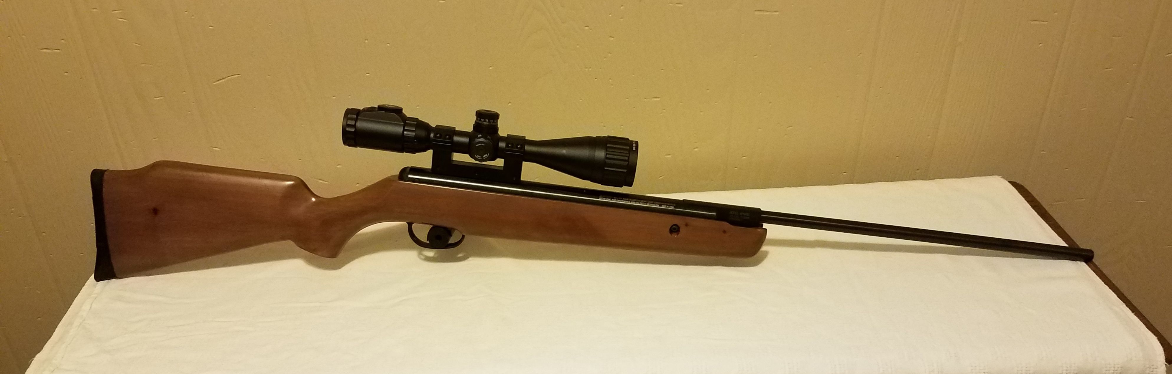

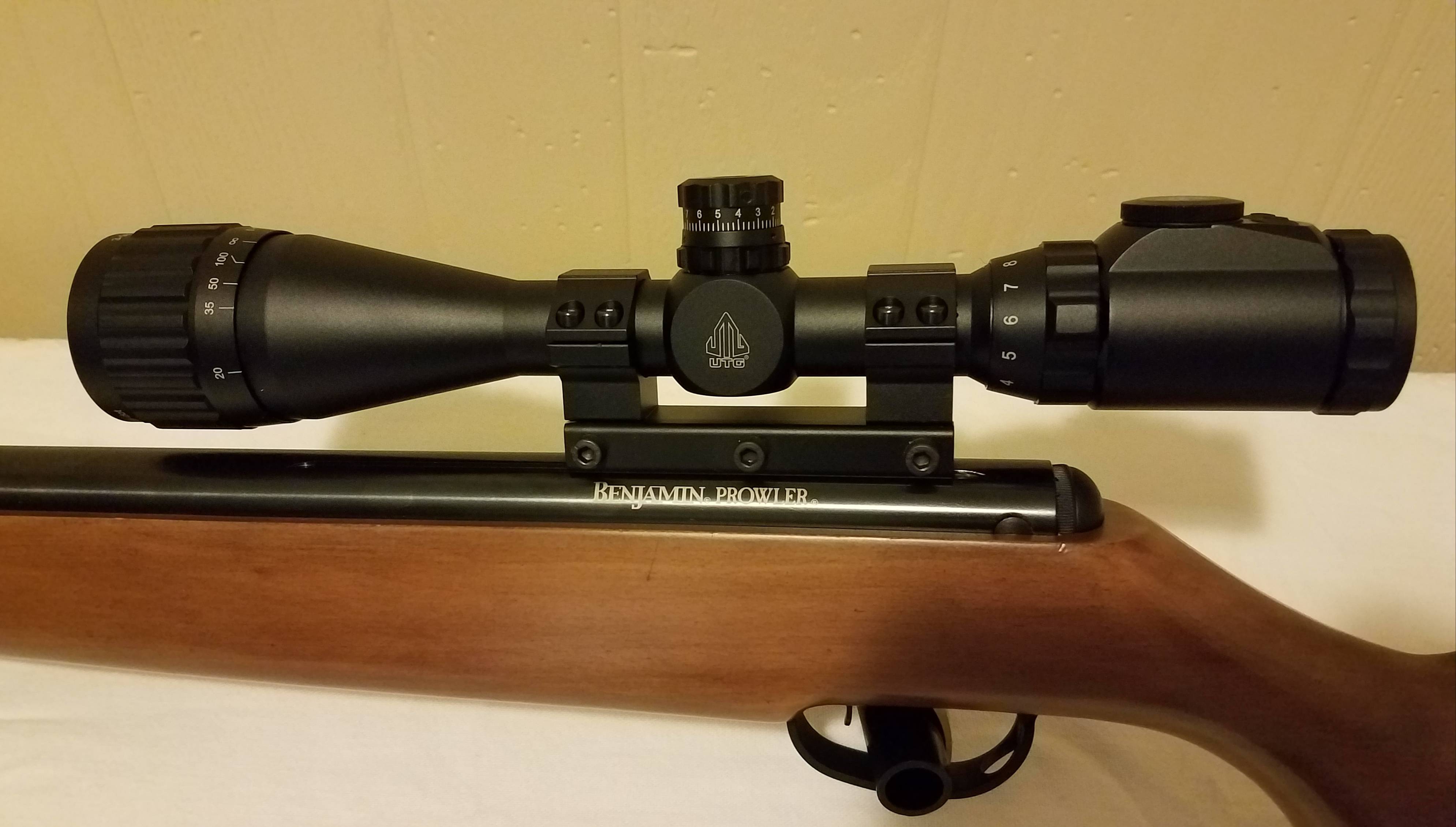

I bought a Benjamin prowler form box world a few years back on sale for 64 something or other. The scope was junk but it's been a decent gun.
Same here, I tool the plastic stock off and replaced it with a Vantage wooden stock. Actually a pretty good shooter but I did put a GRT III trigger in it.

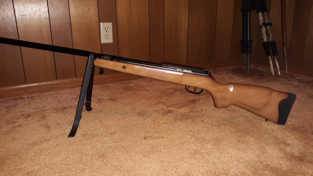

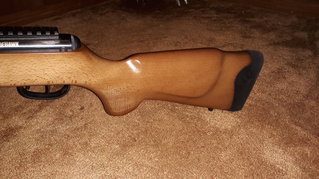

Read that Ruger Air Hawk and Night Hawk are Xisco Airguns that are Diana 34 clones. Be great if you are handy enough to tune.
Read that Ruger Air Hawk and Night Hawk are Xisco Airguns that are Diana 34 clones. Be great if you are handy enough to tune one.
This gun is a Xisco B28 that is a clone of the RWS 350. You can see how powerful it is. However price is high for what it went for in Wally World. Maybe find it cheaper online. Don't know if Mike Melick with Flying Dragons can get a Xisco B28. Use to come in .177, .22 and .25.

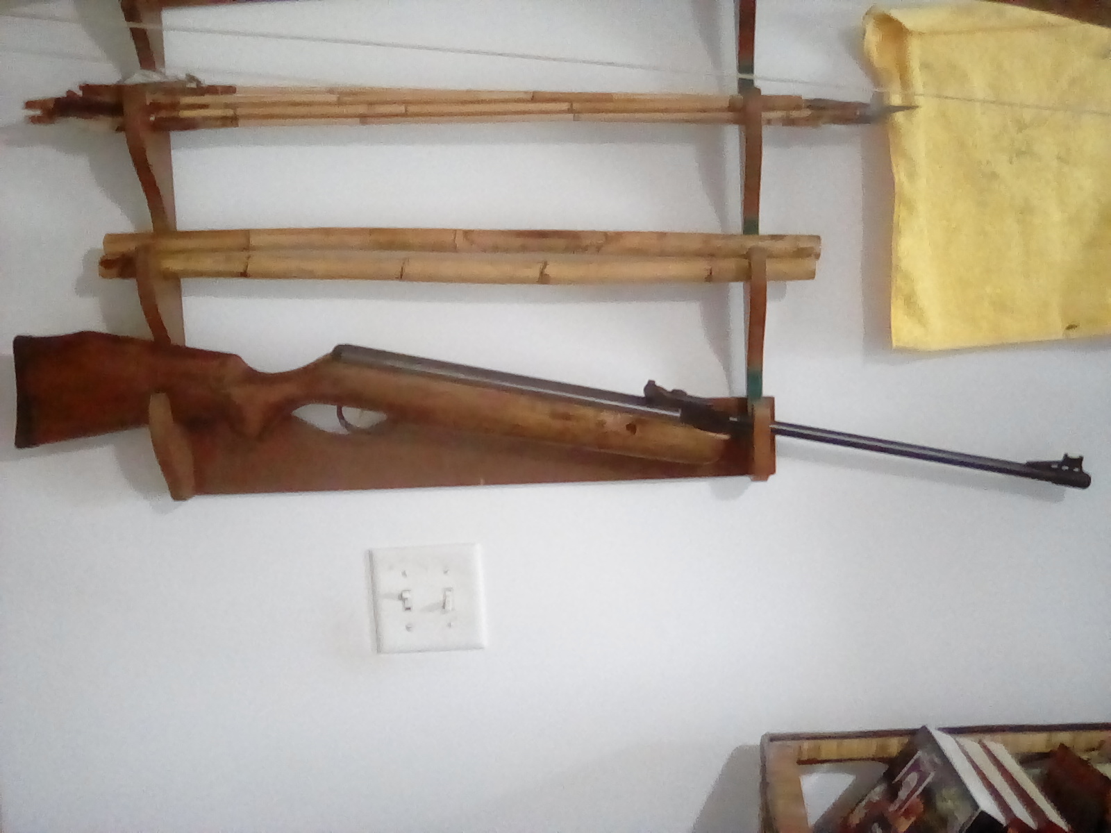

Over 10 years ago I bought a Crosman Storm XT in .177 from Walmart. Once I installed a GRT III after market trigger it turned out to be a really nice shooter.
This is the first Springer I ever took apart. Over the years I've installed a new spring and piston seal. I also refinished the stock. It's all metal and wood except for the plastic fiber optic sights.
After over a decade it still shoots great.
