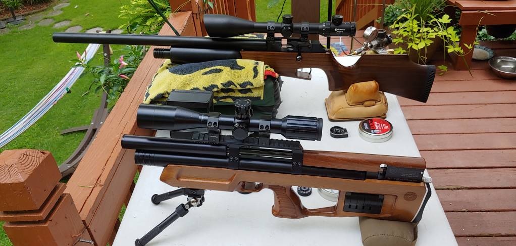

As of today, all three of my guns are reliable in this regard. I was having a little trouble with the first shot velocity of my P35 but I figured out it was my bad tune. I had the hammer spring set too low for the regulator setting. The regulator creeps a little but the effect on velocity with the hammer where it should be is less than 10 fps. So inconsequential for accuracy at my backyard distances (100 feet or less). My other two guns are a Prod (unregulated) and a 25 caliber Avenger. I've shot the most squirrels with the Prod, I think it's count is 15 so far (in less than a year). I had POI issues with a bug buster scope but with the Hawke 2-7 it now wears it is very reliable. It has to be. Backyard squirrels do not give you much time and rarely give me a second shot. I've shot two with the Avenger and it did great too. I have had it's West Hunter scope move when target shooting but it is rare. I had the Primary Arms 4-14 on my P35 move for the first time today. It shifted up about half an inch at 100 feet. First time in about 500 shots on this gun. So I think it will be reliable.
The little Prod hangs by the back door but I am hoping a squirrel shows up for the P35 to get a chance soon.
All three of my guns will put three shots with pellets they like into a quarter inch group at 100 feet when I do my part. The P35 has done this a few times with H&N Slug HPs.
I shot at least one group with my two older guns (the Prod and Avenger) almost every day for a couple weeks to be sure the POI was not changing. This inherently also told me the first shot was going where it should.
