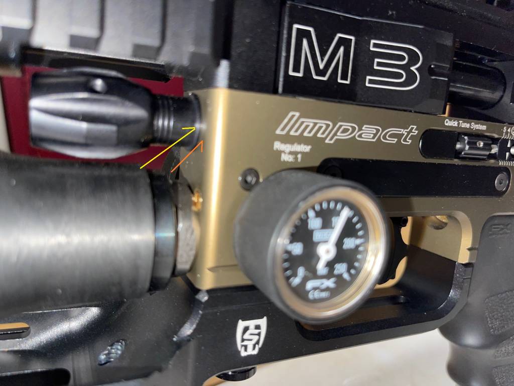

Arrrghhhh! The issue re-appeared this morning! Problem is not solved at all . Yesterday my 34 grain slugs velocity was 996 fps, this morning with the very same setting it is 700 fps. That’s a massive power reduction. I didn’t change anything it is same configuration.
I noticed the plenum is a bit offset vs the breach (see picture) can it have an influence on this massive speed reduction?

looking at that pic makes my stomach cringe. On such a new gun, too, you’ve either got a bent barrel, a rear block that’s now all gouged up(along with the brass transfer port and adapter all gouged), and it’s probably got a stick point or two when cocking the gun, as the cocking block is not concentric with the barrel.
if you have not pulled the barrel off yet, don’t. I’m saying that because you will struggle getting it back into the rear block. Send that back in for repairs.
If you had someone take that gun apart for you for some reason, they didn’t know what they were doing. It’s that, or the gun suffered from a sharp blow to the rear of the gun, or the gun was picked up from the rear while something heavy was piled onto the trigger block areas.
Thanks for your messagre bigragu. I finally solved the issue: when I installed the power kit I wasn't careful enough: the 2 parts of the cocking block rotated also the front of the power plenum rotated. I took a while to realize this.The rotation of the cocking block could explains thev loss of power: bad alignment between the pellet probe and the transfer probe. The power plenum offset could also have an influence on the pellet probe position. Anyway I reassembled the rifle properly and its working fine now: my 34 grains .22 slugs can fly again at 990 fps like before I messed up with the power kit. I don't think anything is gouged inside. Pfewwww. Good to return to the happy M3 owners.
Wait, I removed the slug power kit on the ground the rifle lost 50% power. The problem was not the power kit, it was my poor armourers skills. Maybe I can have another try with the slug power kit.

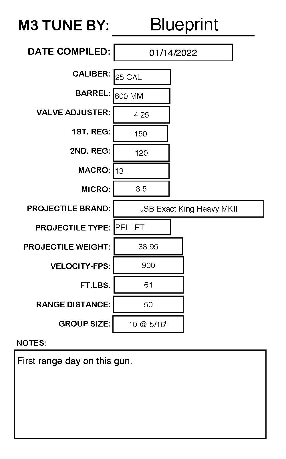

M3 .30cal. 700mm Superior Heavy Liner, CF sleeve, Integrated Tuner, stock pin probe
44.75gr JSB pellet
1st reg- 168, 2nd reg-105, micro 4.7, wheel 16, valve .4685"
910, 906, 911, 909, 908, 908 FPS
M3 .22cal. 700mm Superior Heavy Liner, CF sleeve, Integrated Tuner, stock pin probe
18.1gr JSB pellet
1st reg-168, 2nd reg- 70, micro 2, wheel 16, valve .471"
879, 877, 888, 880, 878, 882, 888 FPS
.30 cal tune resulted in 1/2" groups and .22 cal resulted in 3/8" groups, both at 50 yards. I need a .22 cal tune for 25.39gr pellets next.
