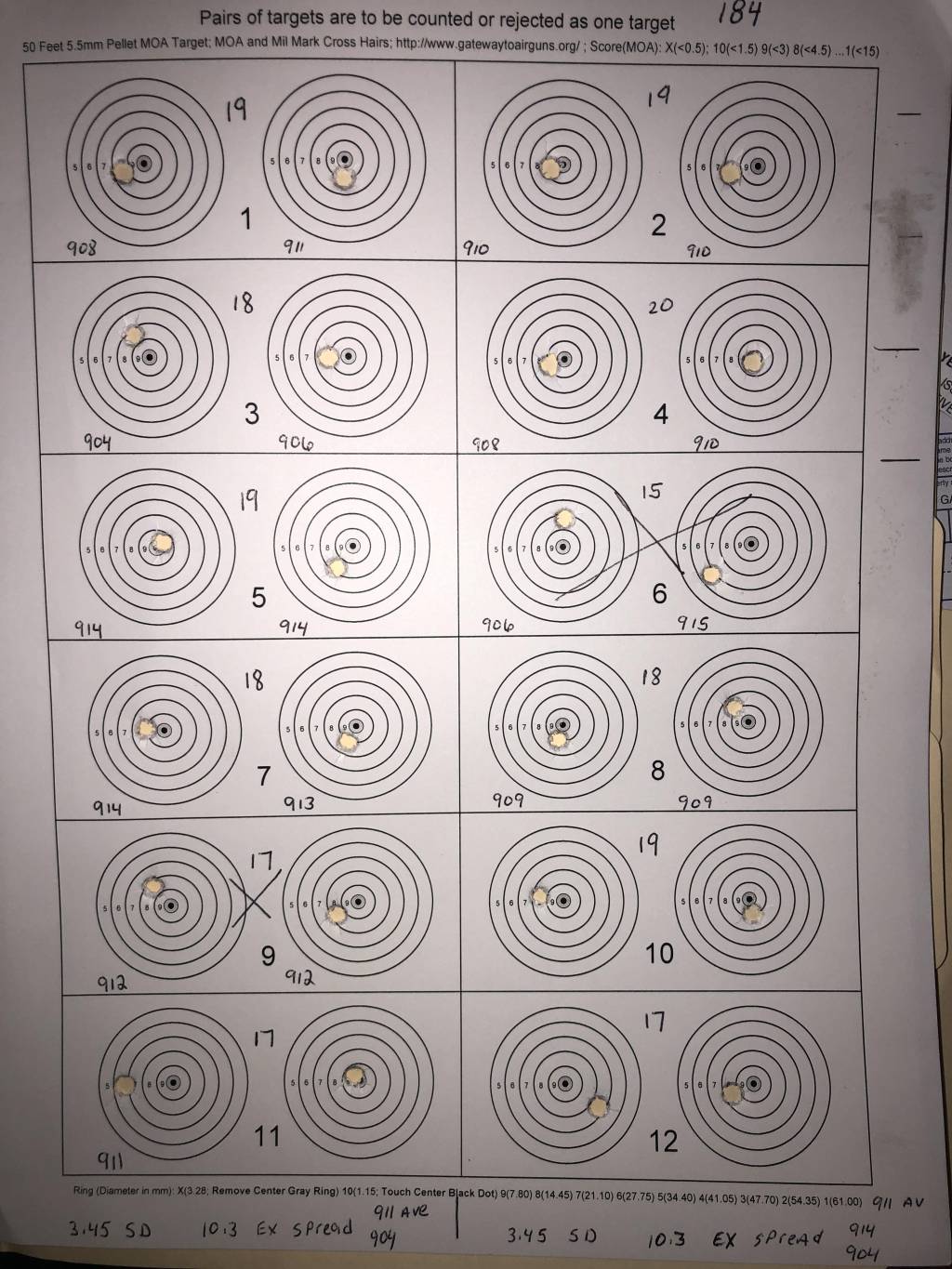

Sell, I emailed FX and requested a tune for the 25.3 using a 600mm barrel and they replied with ( 95-110 on the Reg to get 890-920 with the pellet side dow.) They also suggested if I wanted to maximize the shots per fill to use the slug side down set the reg to 80 Bar. to achieve 880-910. I don't fully understand how using the slug side down would help the gun be more efficient. So far I have tried setting the second reg at 110 power wheel at 16 and quick tune at 4. I shot this target yesterday at 30 yards I was struggling with a crosswind but the the Standard deviation was only 3.45 and average velocity was 911 and I think the results are very acceptable and most likely limited by shooter error and the quality of the pellets. I am new at this so I really don't know where to go from here .
