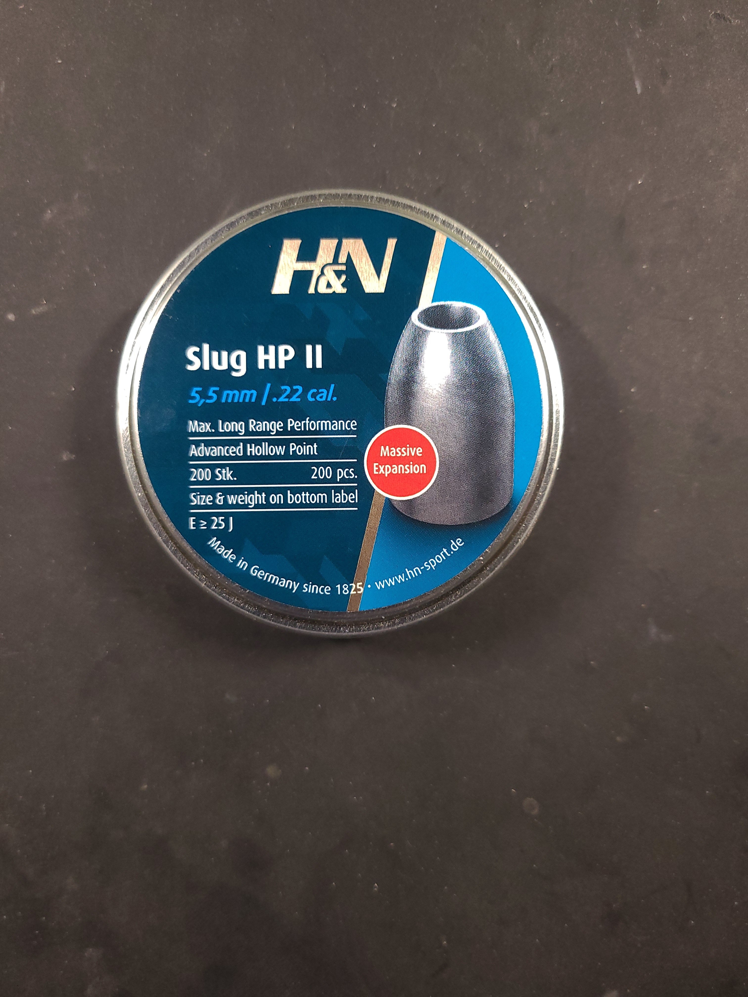

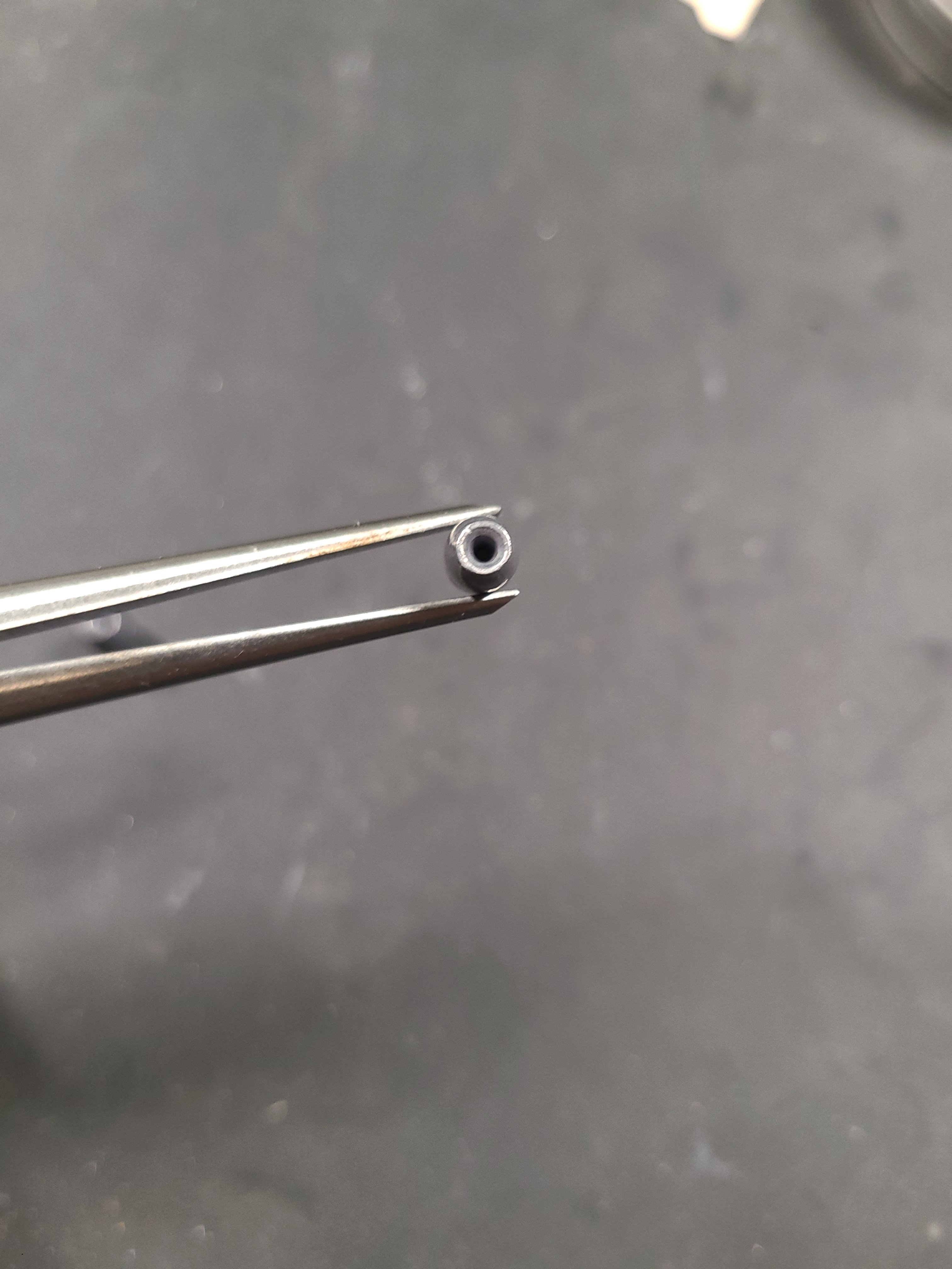

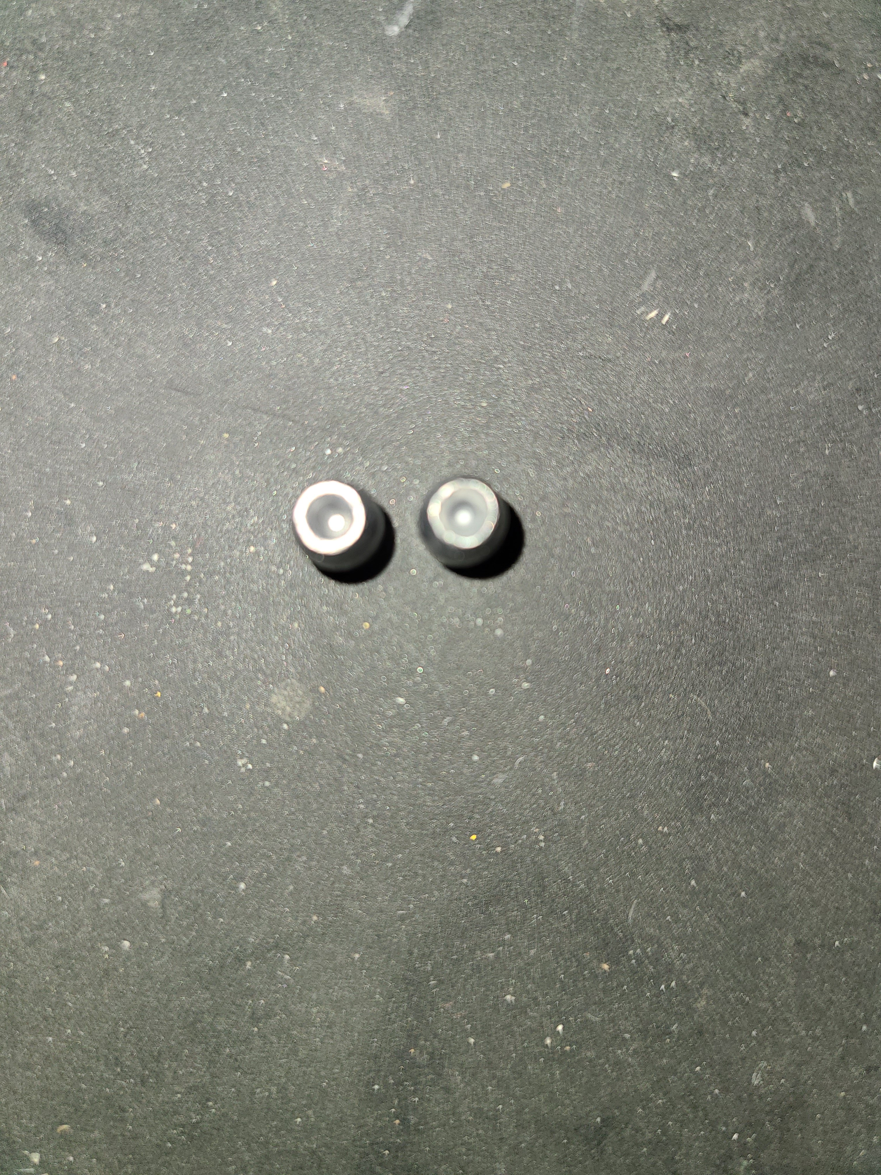

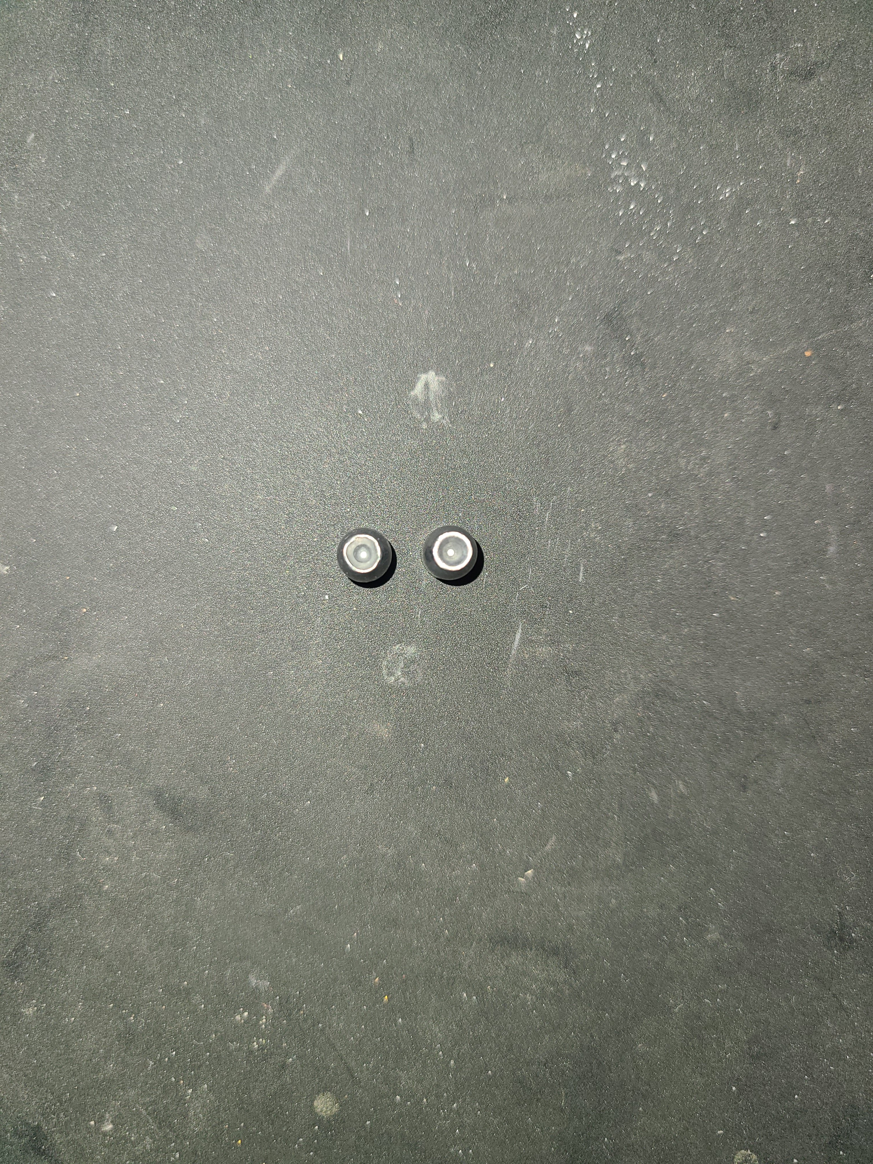

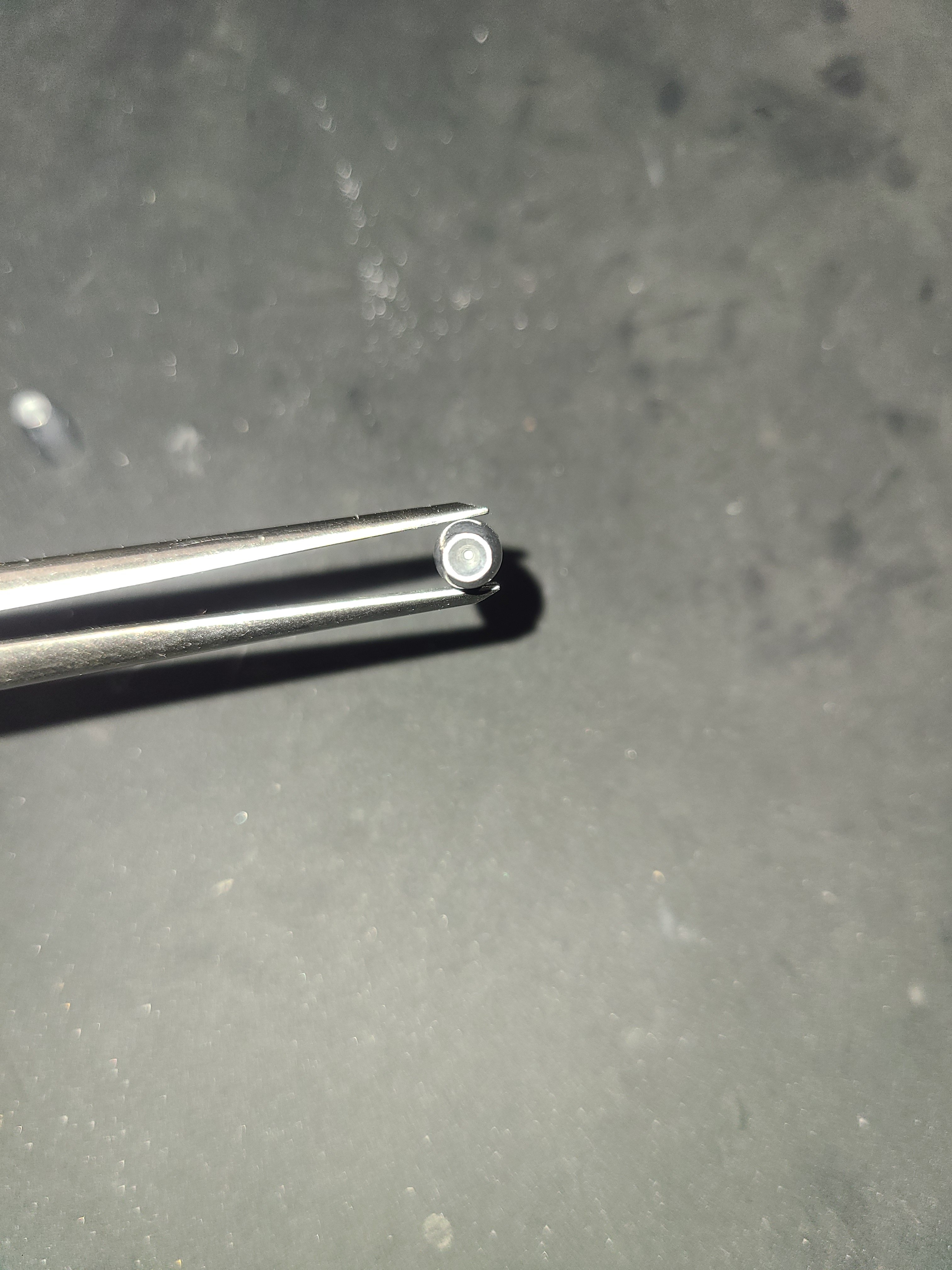

I just received my 2nd batch of the H&N HP II in .22-30gr and noticed a difference in appearance between the 1st batch. This 2nd batch hollow point is not as deep, about 0.02 less and there is no H&N stamped on the bottom of each slug. I'll be trying them out later today if there is a difference. I don’t think the expansion will be the same. I'll have to post something if there is. Just bought 16 tins.

Are you sure these are HP II Slugs? Some retailers still sell the old HP slugs with the small hollow point.

Fit and finish is also not as good.

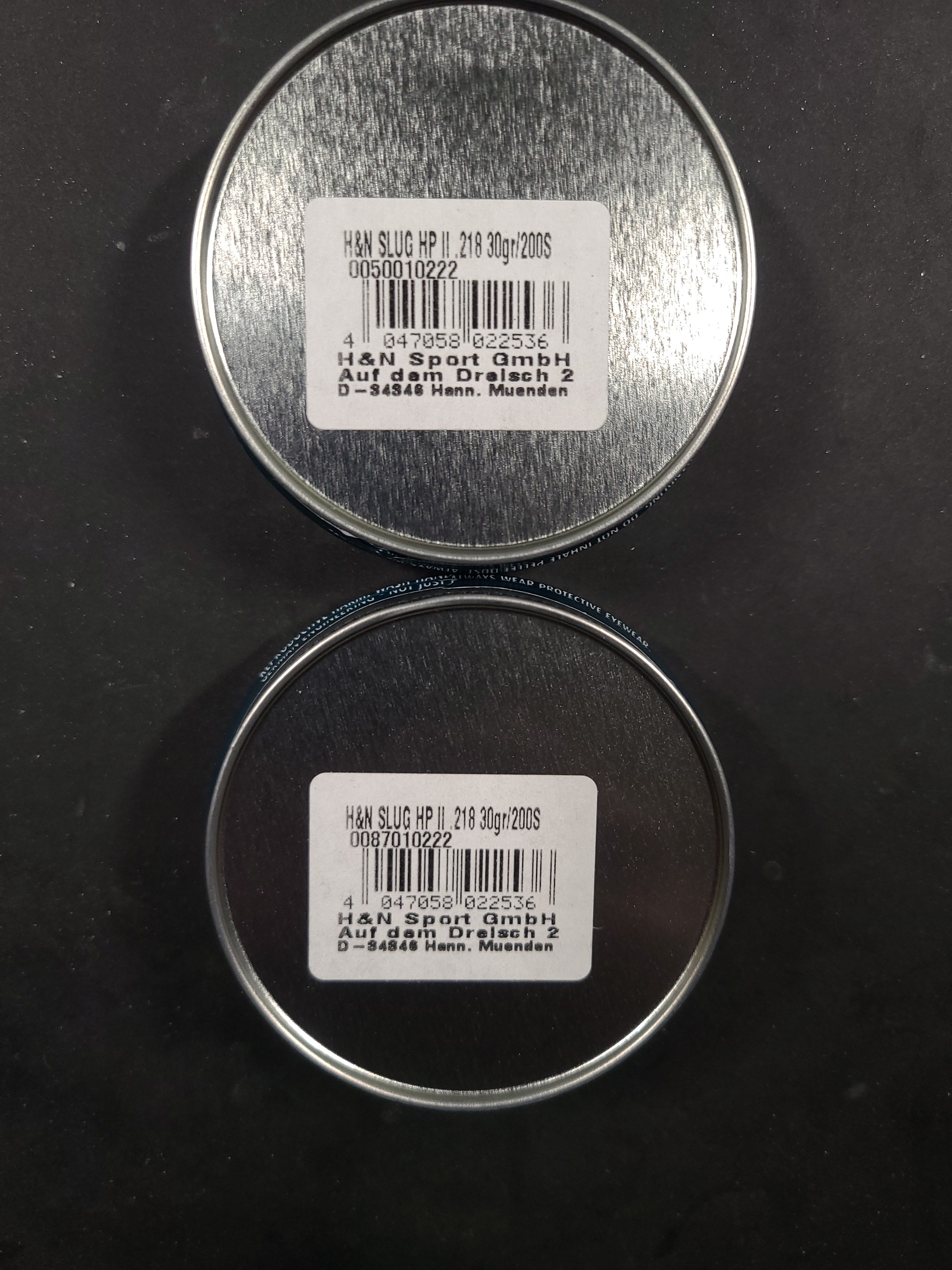

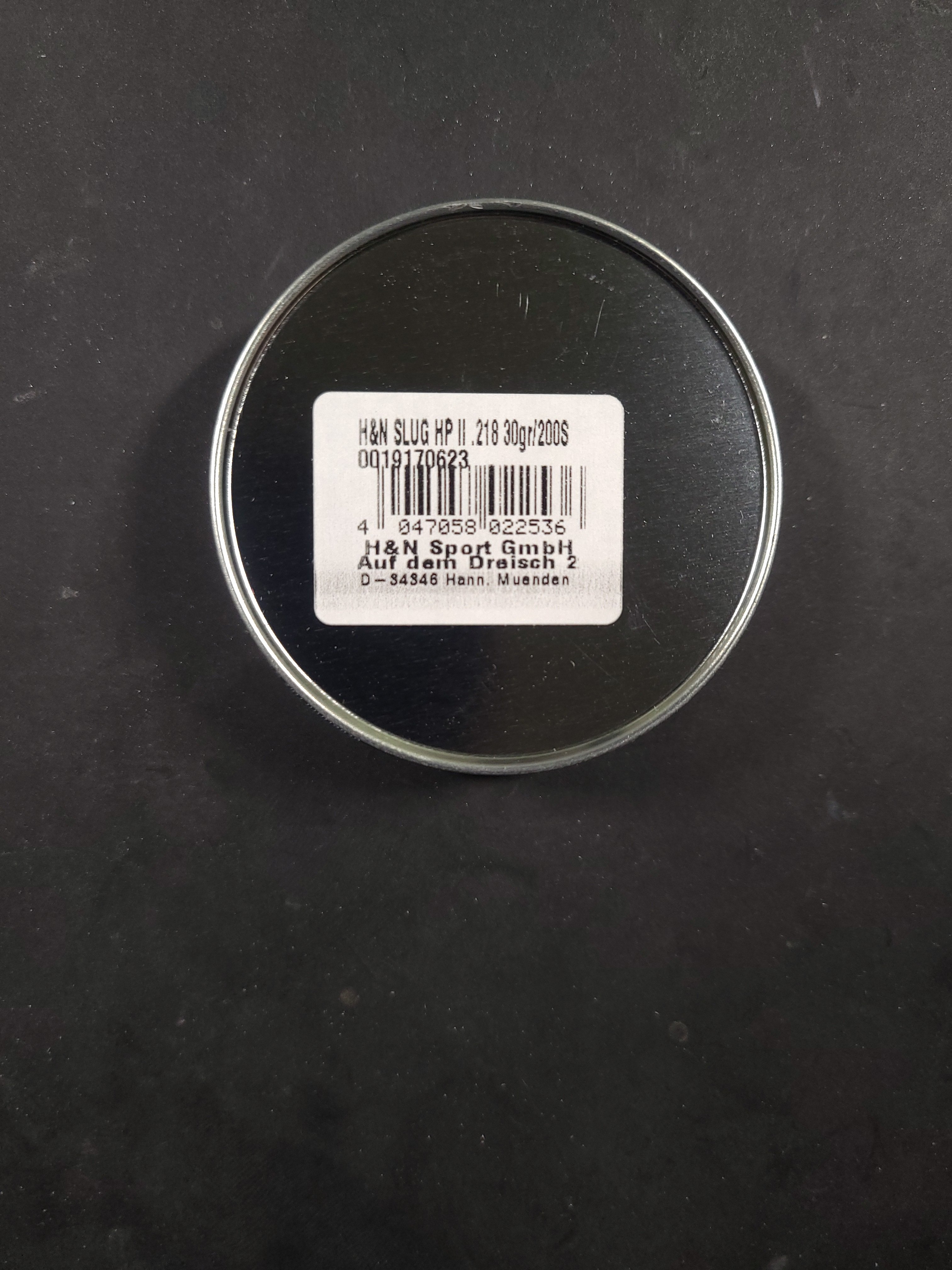

Both are indeed HP II Slugs. Photos of the bottom labels of the tins would be great.
I'll have to take pics. What made this change in the design. I haven’t had chance yet to try out the expansion. They seem to shoot just as accurate. Weather hasn't been great for a good test though.They are also about .005 shorter in length.

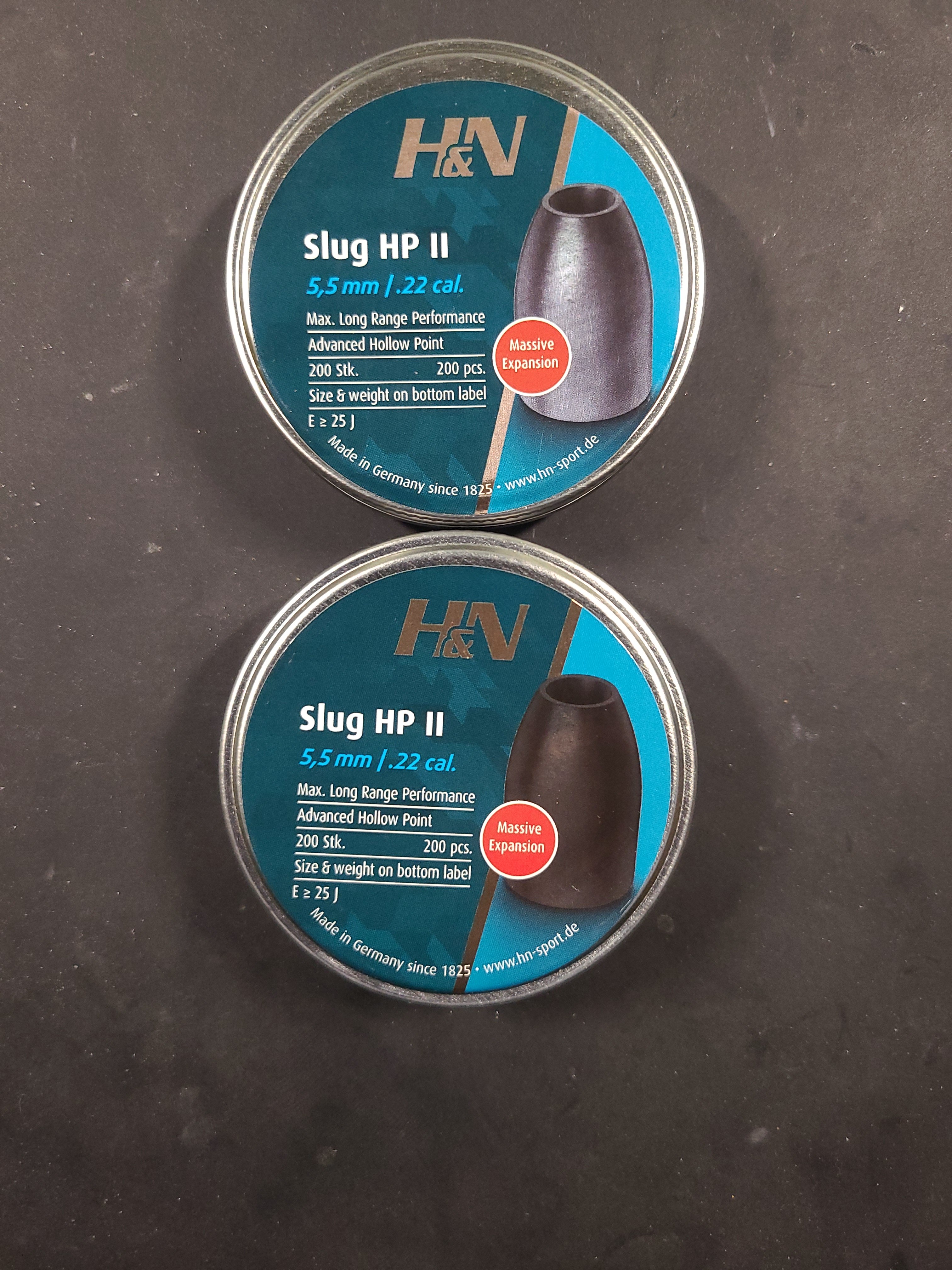

The recent order contains both these bar codes above.
Below was my 1st order that has the deeper holes and H&N stamped on the bottom. Taking a guess by the bar code, this was an earlier batch.

Your new batch of slugs is from 2022, the old from 2023. The batch number always ends with the manufacturing date, so 010222 means February 1st, 2022.
After introducing the new, deeper hollow point, we discovered that the upper thin part of the hollow point tends to get dented or deformed during handling and transport. We therefore widened the meplat a little and made the outer wall of the cavity a little thicker at the top, resulting in significantly fewer undesirable deformations.

Ok, so the latest HP II slugs have the deeper hole and H&N stamped on the bottom. The last order I received is old stock, 1st production run HP II.

Well, unfortunately for me, I won't be purchasing anymore until this 1st run gets out of circulation. My gun definitely sees a performance difference between the 2.
