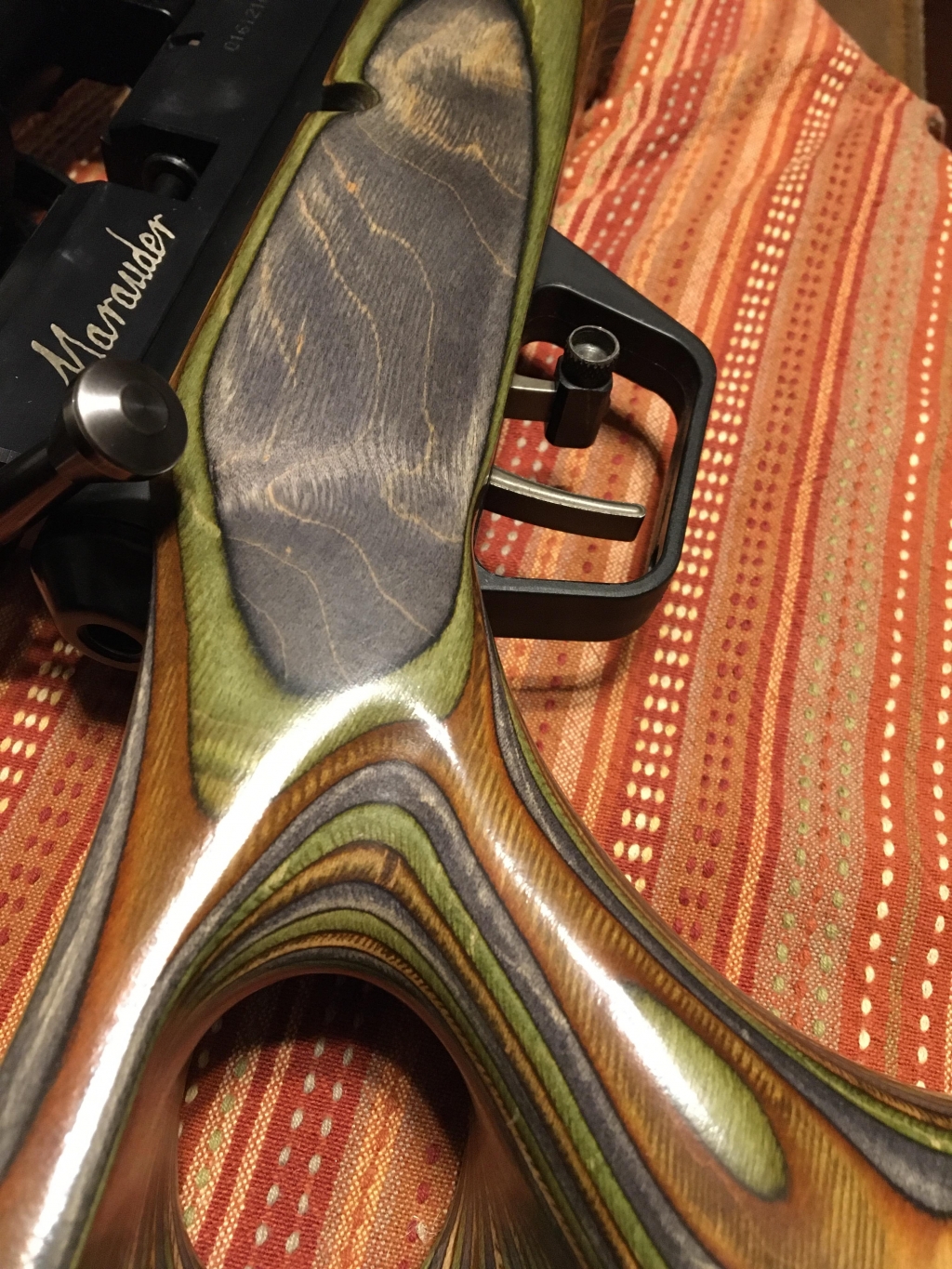

By far the best accessory I have made for my Disco and Marauders are safety extensions. Any manufacturer who puts a flip safety right in front of the trigger should be shot. I do a lot of hunting in the cold temps and need to wear gloves. A thick finger can hit the trigger at the same time I am trying to take the safety off. Not good. So I took a hammer-spur and fitted it to the safety lever. It sticks out just enough to work with a gloved finger. But you don’t have to be close to the trigger and it doesn’t stick out further the the trigger gaurd. Some one with a 3D printer could make a killing. A Marlin 30-30 hammer spur works perfect with just a touch of filing.

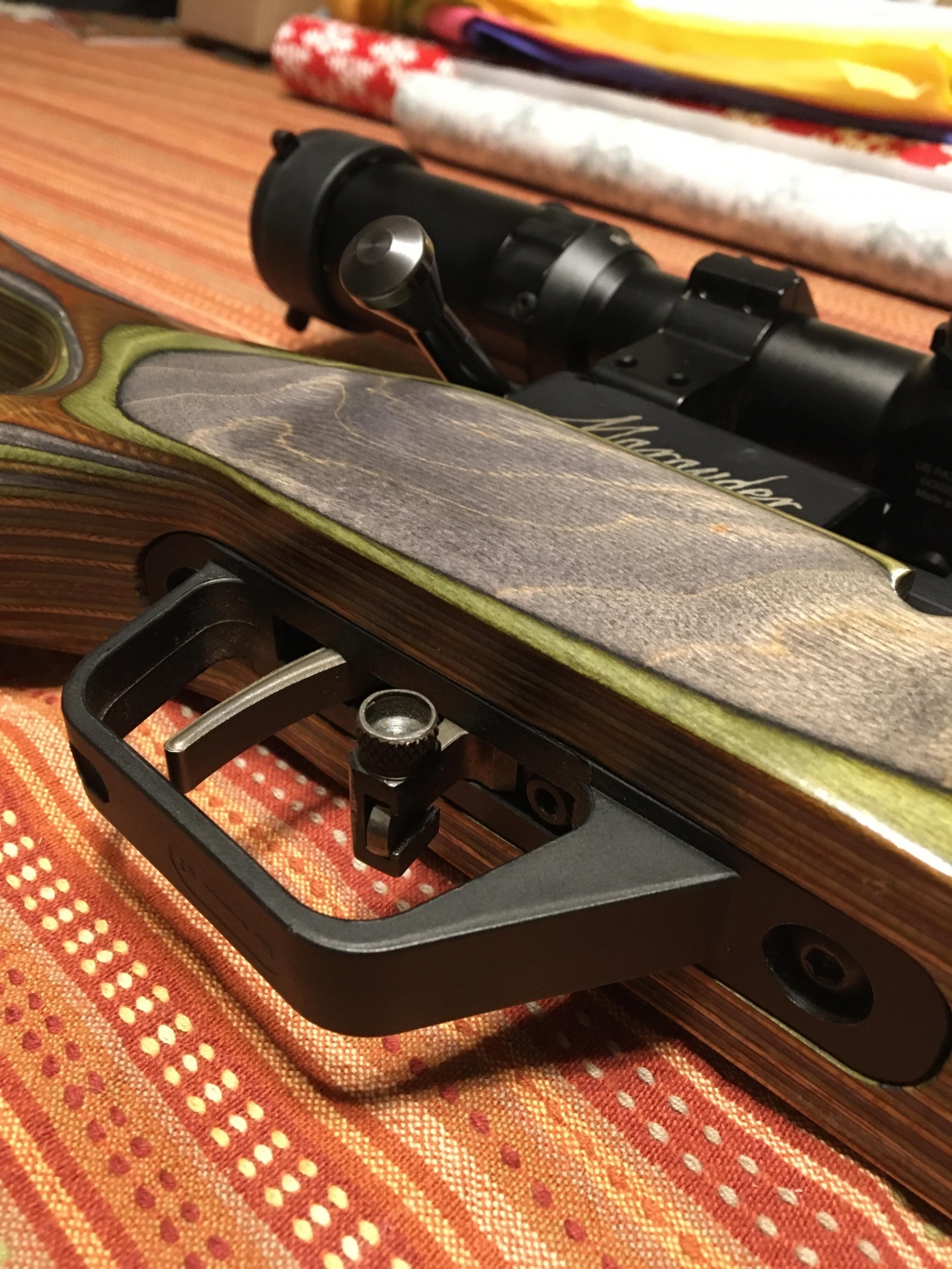

Wow! Now that is thinking outside the box and a great idea!!
