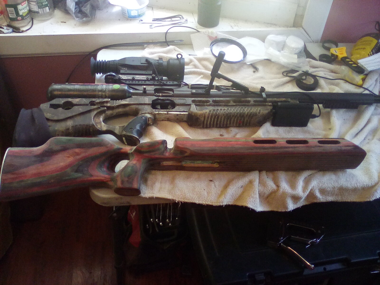

My factory Texan .510 TX2 valve 3625 psi max power dial tethered shooting 650 grain spire poInt boat tail at 750 fps with a B.C of around .5. Accuracy now around 2 moa at 125 yards average.
You need an AAO valve and 4500psi bottle ;-)
1200+ft/lbs on the first shot and the first three over 900ft/lbs.
Reactions: RM.510bigbore
No doubt I been wanting the African Air Ordnance 4500 psi upgrade for 2 years. I have a aqua environment regulator good to regulate from 7000 psi down to zero. Also have a 5500 psi Scott tank. Im.getting much better at getting my yong heng to fill tanks at max pressure after rebuild. Slow and steady wins the race check out my new Texan stock upgrade. Its a old rem 700 3 inch wide thumb hole laminated stock.
