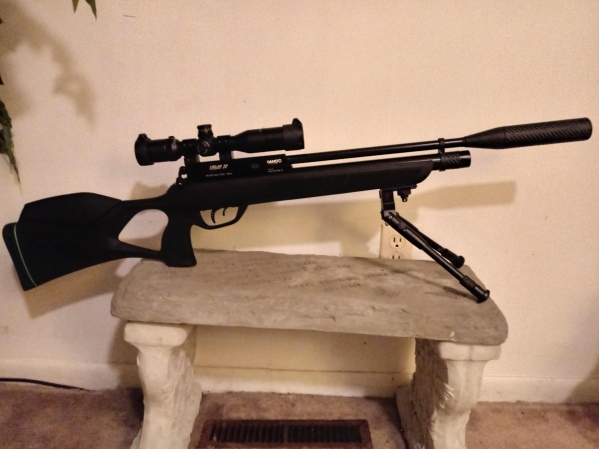

You Guys are probably gonna think I'm nuts,but here's #2...
For the current price,I couldn't help it. Turned the hammer spring adjuster out two revolutions,prepped it,replaced the short stock sear adjustment screw with the barrel band screw (again..it's the same diameter and pitch only longer) left the band on this one-It's on there in a "floating" state...if the barrel is bumped,it will spring back without altering zero. Dressed up the Big-O moderator with some faux carbon wrap I had on hand,a bipod and zeroed it with a 3-12X32 Bug Buster. It weighs in at 7.9 lbs total as is. Its going to be used mostly for light pesting (by me) and target/plinking for my Wife and Daughter (They don't want to kill anything.) I'll fiddle with the velocity when I have more time in addition to pellet testing with this and the 1st one.
Mike.
Thinkin I will keep the stock moderator on this one...for now. I plan on keeping this one at a lower power/higher shot count tune. The longer screw mod. makes the triggers Very nice! (In my opinion,anyway.) And by backing off the hammer preload,this one (#2, I'll call her/him/it.) cocks effortlessly...Plus as an added bonus, it IS "mouse fart quiet" as Steve from AEAC so eloquently put it. I'll be sure to post updates!

Ha! Yeah,the whole "Punch bowl" thing was in reference to the big,awkward plastic Buck Rodgers death-ray lookin moderator on an otherwise Wonderfully finished rifle. The 2 different power levels are precisely what the plan is. I Really wanted a Buccaneer! I Love the look of the stock in particular and its available without the Big-O tur...eh,You get the drift. The larger air tube was also a factor,as I just have a Hill pump. On the flip side,the Urban is sooo easy to fill,that the slightly smaller tube is nice. Obviously,I'm pretty happy with the little sucker...I bought Two of the damn things.LOL!!
