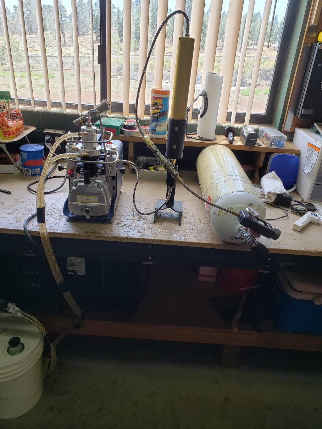

I went in with a friend on a new Yong Heng compressor. I filled one of my rifles with it initially a month ago but neither of us had the opportunity to use it to fill a tank until yesterday. For cooling we were just going to use distilled water and ice in a 5 gallon bucket which is what I used initially.
Backing up a bit my friend Randy installs and repairs beverage systems for bars and restaurants part time now but did that full time for half his life so he has access to equipment that most of us aren't used to seeing. As you see I guess he couldn't resist going a little crazy with keeping Yongy cool!

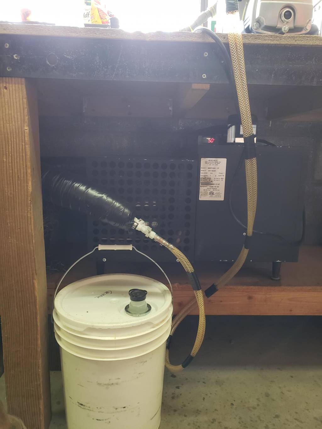

So underneath the bench is a commercial grade beverage chiller using Glycol which he hooked up to Yongy. If you let the system cool down it'll get down to 30 degrees or so. We just waited a few minutes and let it get down to 50 degrees and started filling our 3 tanks. The temp gauge on Yongy stayed around 40C and the chiller got down to 40F when Yongy was running.
Hopefully Yongy will last a while longer than normal keeping it cool.
Randy built the stand for the filter as well.
I was impressed that it only took 17 minutes to fill my large CF tank to 4300 psi from around 3300psi.

I have no idea about the bevreage system you use but here in DK they are awesome and can run pretty much 100% (180 liter/min) and still keep beer under 4degC. They need to run at least 4-5 hours to build up the required ice and keep water at almost 0degC
So with that contraption you'd be better than golden mate :)

So far we have 12 fills/4hrs on our big 4500 and 4350 psi tanks. It takes about 20 minutes to fill to 4400 psi from 3200 psi which is as high as I've filled my 4500 tank. The oil was changed after the 5th fill and no problems so far except tightening some fittings that were leaking a tiny bit.
That's $120 worth of fills not including gas if we'd filled our tanks at the dive shop so Yongy has almost replenished my side of the investment. It is so nice not having to drive all the way across town to get a fill which is minimum 45 minutes drive there and back.

That is a good setup. I was considering putting a commercial chiller (my friend uses one to cool his home built laser cnc) on the next Yong heng I bought, but I ended up going with an actual dive compressor. I’ll be interested to see how long this unit lasts. I think it will last a long time, but I haven’t seen anyone else take their cooling to quite this level. It is a good sample case for everyone to watch. The cooling system would probably cost most people more to setup than the compressor though.
