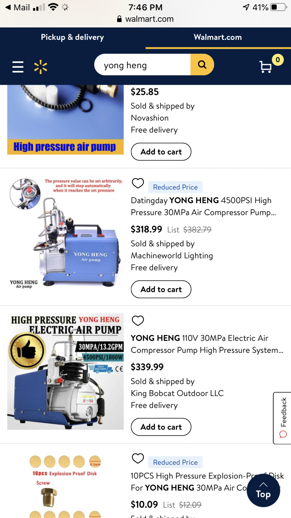

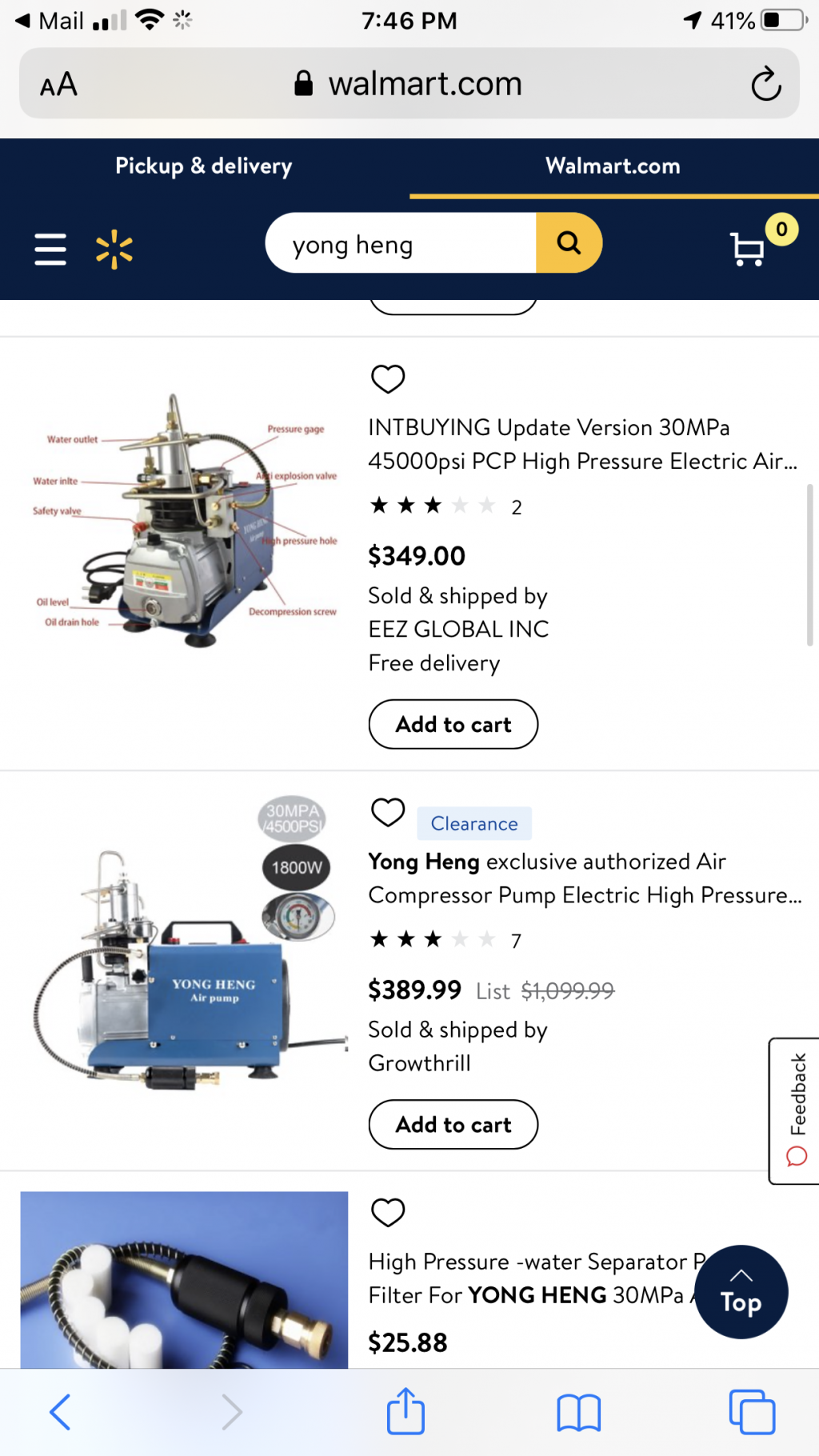

When I look I see several different listings for this product. I see some comments of people being shipped the simple one when they ordered the pressure setting one. Most vendors there have no reviews or at most one or two with a small number of stars like two or three stars.
Prices are $318-$399
Not sure how to pick one of these because they all look pretty bad. If they are being sold through Walmart does the Walmart protection cover me even if they are shady? I don't trust someone with no reviews or only three reviews and 2.5 / 5 stars...
The Yong Heng "simple version" least expensive does not have a water separator you need one.
The "auto stop" version shuts off near 3000psi.
So you likely want the "Hardcover" or 'Set pressure' versions your choice on the 110V or 220V.

I bought one a few days ago from Walmart. It is the one that says Yong Heng exclusive authorized high pressure 30MPa etc etc from Growthrill. It was $346 when I bought it but is now listed as $399. 4 year protection plan is $45. I didn't get the auto-cut off because the relay seems to be problematic for some people. I paid the extra $10 for faster shipping. It arrived in 3 or 4 days.

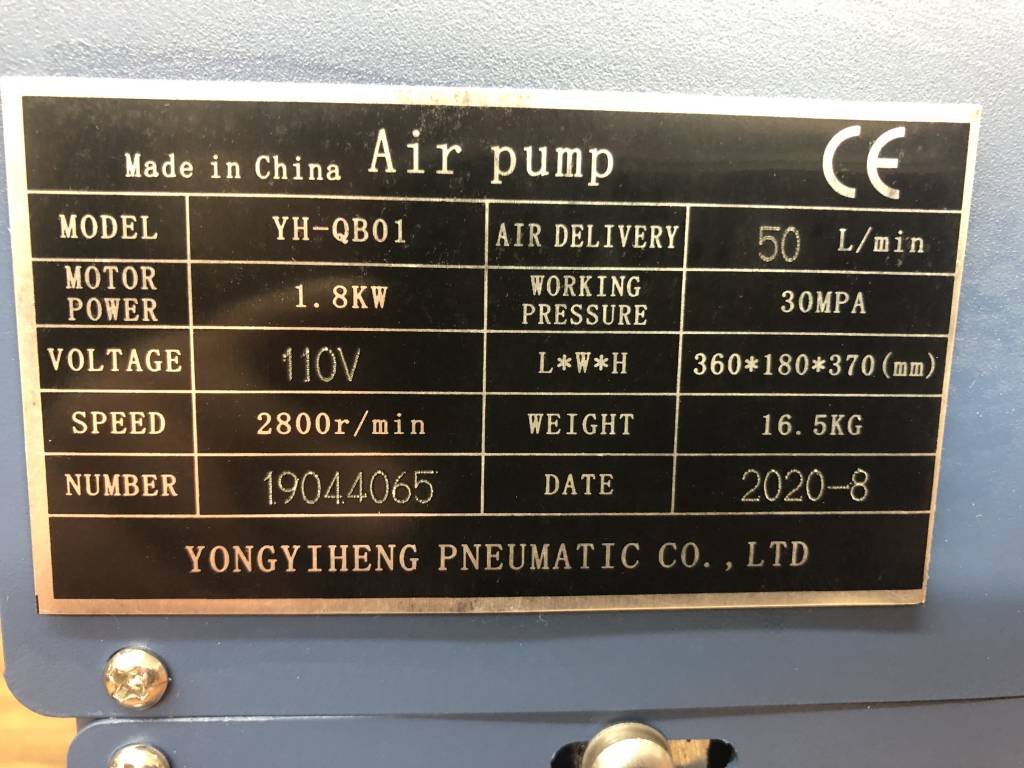

Does yours say yong heng on the side? Only one picture from that seller says yong heng. All the other pictures have a blank side. I was led to believe that if it didn't say yong heng on the side of the unit then they were clones and not real yong heng???
This ebay seller provides a 5 year warranty. And folks on the Yong Heng Facebook group seem to be happy with the seller and his service. And they also confirmed the unit is in fact a REAL Yong Heng. A few folks have posted pics of units with a Dec 2020 manufactured date, so they are fresh off the boat.
https://www.ebay.com/itm/YONG-HENG-30MPA-4500PSI-High-Pressure-Air-Compressor-PCP-Airgun-Scuba-Air-Pump/353126179430?epid=18021956253&_trkparms=ispr%3D1&hash=item5237f5e266:g:DOcAAOSwpVde~U9u&amdata=enc%3AAQAFAAACcBaobrjLl8XobRIiIML1V4Imu%252Fn%252BzU5L90Z278x5ickkWpEuxXwAiCNKyBQsQ5%252Fe60KK4%252FzSwoUezJEZtR82Egd2T7nSLwLH9lIzT4AW1kOQEEWoNnVEalNNrZ8GayAUPaWt574XYbBE%252FmrkKi27vD7rwHG0RSaEW%252BIdPDJHjv97pt4KpR%252FSodFl5k3hPuXiUGhvhWfjE%252BiQ0uKHbo67XPr5Qxom76L1SmOIYIzuInnm%252FovESWz2xhufcQw2dL6XwPl3RCZph1EqMIU6fZIHDEuzwGxNhpz%252BxP0ZryP%252Bs0wLrMLNjAcTalWt5F5yIRiTayDPmgBFMHC9kWBC2yZKkbnLFpHSeVw5mrHaMmWqlXWFWXDPiPaLJG1FnCujnWMl5sBApriuCZCg3EzpTuMSYjcYmwKlHG9wRXBDhGFCw%252FIY2xTiXhRfLnid0PaE3b0XyNMlC4NyKu2MWto8ASPG73VyQgxgfGApN9%252FfcPW9zTMXnaauIB0jhKs6k3NRhPiKdUeetHhFnXGyiuKEphmRzmFj5ryNK2%252BbG3EWrhXAxoN1HDorETCNJP7ndOFTVefrwAaODQd5GBbhInTSRZv4yGpNvY2Piq1e85hBgTRjsSBN%252Ffwtzp3NN36FtGB6ItQMFTnWbaaxpeW2XCHOEj5fF5JvD0qkxBhMH0aUVgASnaNqz2FOmCjqAyAa4%252FRXBbMYfLugk6kS35YR0WkPagC9POC2LnGJoHkO%252FRNhn5%252Bz7WEmV8tWMQ0CwcpGJsAXVt1kkVCjMgGsNOh4mDE%252BlrbtjWAZc%252Fkhey5dA7HanMm50QrsP60OmCNwyjC%252F%252FGwR%252FIOOMA%253D%253D%7Ccksum%3A353126179430c8dcbe7462fe489c926aacdddb7c0366%7Campid%3APL_CLK%7Cclp%3A2334524
Yep.... that's the one I purchased mine from.
Yes, scroll up and look at the pictures I posted. It has Yong Heng Air Pump painted on one side, the other side has a plated riveted on with additional information. I had heard the same that if it didn't have Yong Heng painted on the side it was a copy. Could just be the "stock" photos the seller is using. Did you purchase from the ebay seller homesupplies01? That's who I and others purchased from and received real Yong Hengs.
