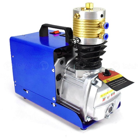

      I picked up an off brand one from ebay for $224 delivered. They dropped to $200 a week later. My first one had problems leaking pressure into the water cooling. The chinese seller was not helpful at all until I gave them negative feedback at which point they offered me a free replacement and I keep the old one. So now I have two of them.
      My recommendations if you get one of these is to check over it very well before running it. Tightening the head bolts fixed my problems on the first one and it's replacement had 3 loose head bolts. Tighten the head bolts, wait an hour and tighten again. I didn't use a torque wrench but I did put a 16mm boxed end wrench on the allen wrench for extra leverage. Almost everything that could be tightened was too loose. Both of mine work great now but I wouldn't recommend this particular one to anyone who's not mechanically inclined. Temp gauge batteries were dead on both units. If you have push lock water connections like mine, change the water line to this 3/8" polyurethane for a proper fit. Use a heat gun to get the new tubing over the pump inlet and to shape the poly water line like you want it. Once cooled it will stay the way you shaped it. Use a better water/oil separator than what comes with them. This pump claims to have a duty cycle of 12L from 0 to 4350psi.

        My yong heng still has the original batteries going strong. Purchased 6/21/2018
        The first knockoff had loose head bolts that let air into the water cooling. After they sent a new one and told me to keep the old one I tightened the head bolts in a few stages and the leak stopped. The new one would've done the same had I not tightened the head bolts before running it. These units have more compression that the yong hengs and won't start with even the slightest back pressure. Once running they seem to fill a tank about the same as the yong heng but run a little cooler.
