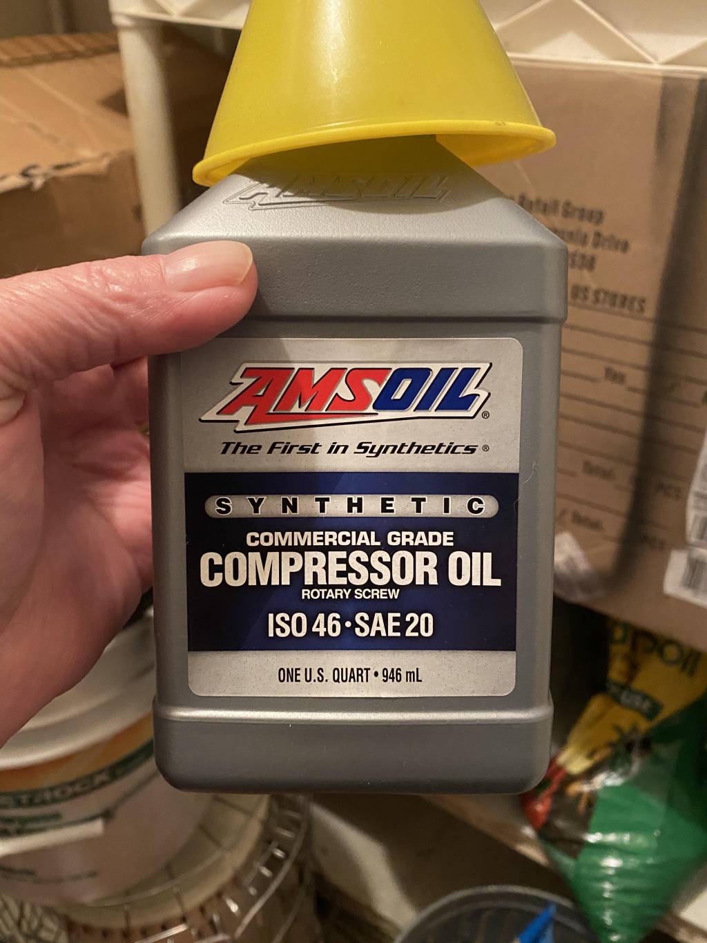

I have the yong heng been using it regularly for over two years without a snag and never used a drop of royal purple in it I use compressor oil from Napa $7.50 a quart but I change it when it starts getting dirty, it worked so well for me for the first year I bought a second one just to have “in case” I top off my great white tank from 3000 to 4600 on a regular basis, also my scba tanks. Not sure if the trail charger will do that, if you treat the yong heng good it will last a long time that’s just been my experience
