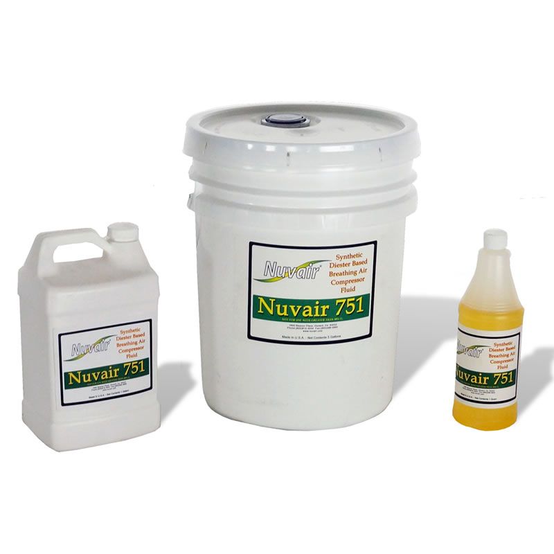

This is the oil I use in my YH.
Nuvair 751 Paintball & Industrial Air Reciprocating Compressor Oil
Here is the data sheet for it
 View attachment Nuvair_751_2019.1641405437.pdf
