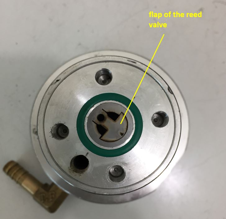

When you rebuild, here's the only video I found on the reed valve and how to re-assemble:
https://www.youtube.com/watch?v=24sGXYkd4NY
The clone compressor has a different head and the intake and discharge valve is set up different. The head in that respect is easier to service than the one in the video. The discharge valve is in a fitting in the top of the head, the tubes are on each side of the head.
