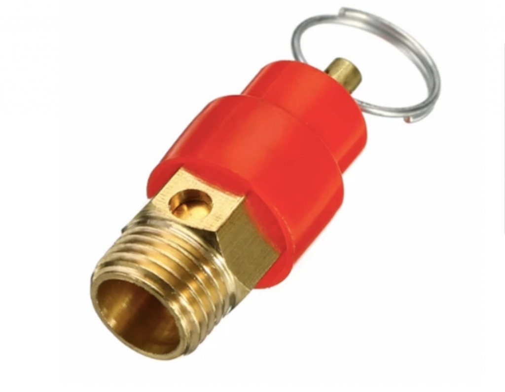

Most likely leaking at a fitting but check the low pressure safety valve also.

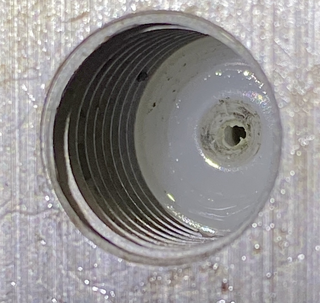

If you have closed the bleed valves as tightly as you could, you will have damaged the seat of the nylon sealing washer. The bleed screw should only be nipped up enough to make a seal. Tighter is not better! There should be a couple of replacements in the spare parts bag.
My own experience is that 99.999% of the reasons for Yong Heng failing to build up pressure is leakage, often occurring at external parts such as hose connectors and filters. If the compressor fails to build up any pressure, the leakage should be bad enough to be detectable by ears. Put your finger next to possible points of leakage such as connectors, fittings, valves, etc. The leakage point is where the hissing sound changes as you move your finger close and away from the point.
As mentioned by other respondents above, NEVER apply excessive force in closing the bleed valves on the compressor. You can easily damage the plastic sealing washer inside. The rebuild kit that came with the compressor has got spares. Replace them if necessary. Here is the washer :
