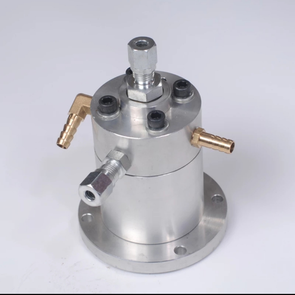

I have one question about the screw (fitting) of yong heng. I need to buy fitting what is in the middle. There are two size. Upper one is bigger than middle. I need this in middle. Maybe right question for airgunsfun :) because I didn't find it on aliexpress.
The part in the photo is not from a Yong Heng pump. It looks like it may be from a V twin model from another builder. I assume that the screws that you are talking about are the pipe fittings on the top and side. You won't find them on any spare parts lists. If you want that part, you will have to buy the whole assembly.
Yeas Eaglebeak it's not from yong heng I did not know what it is called just this one part. I need only one this part. I explain you why. I have Simple version of yong heng because I bought it from Poland aliexpress store and there were any available. Of course I wanted Hardcover version. So, I bought from aliexpress already mentioned parts of the cyclone separator plus pipes etc. BUT when I opened the parcel from China I found there will be problem due tu simple version has those two "fittings" are in the same size bigger. But versions with the cyclone separator they have two different size of fittings. If I want to use my new cyclone separator I have to change one bigger fitting to smaller one due to piping...
